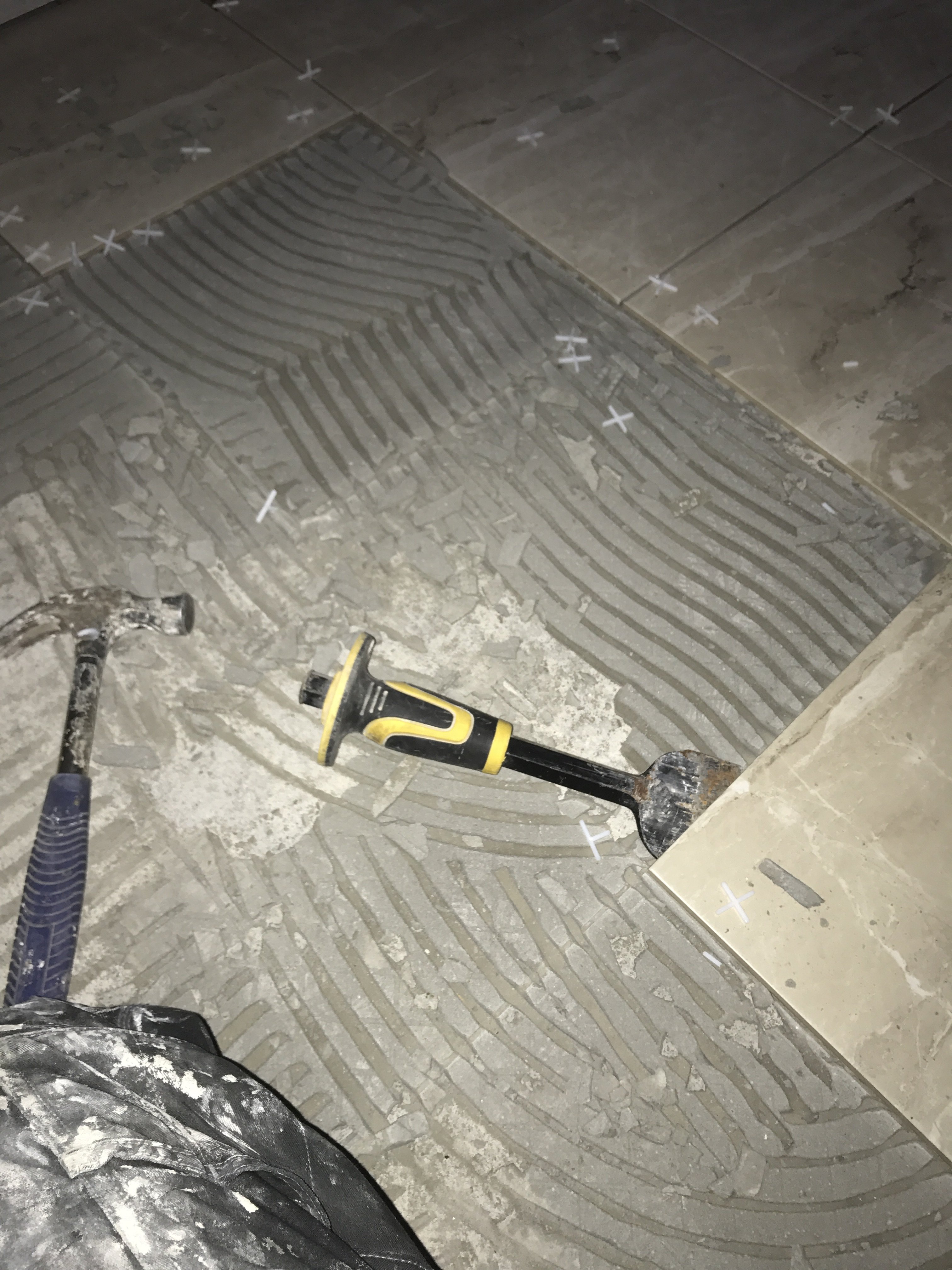

Had a call the other night, customer stopped their plumber after he laid tiles on the floor as they were not in a straight line.
From the look of it he did not bed the the tile into the adhesive as I could lift a majority with my bare hands. And some places there was no spacers.
Also I think he might have used tub adhesive.
When I pulled the tiles up there was no adhesive stuck to the back of the tiles.
