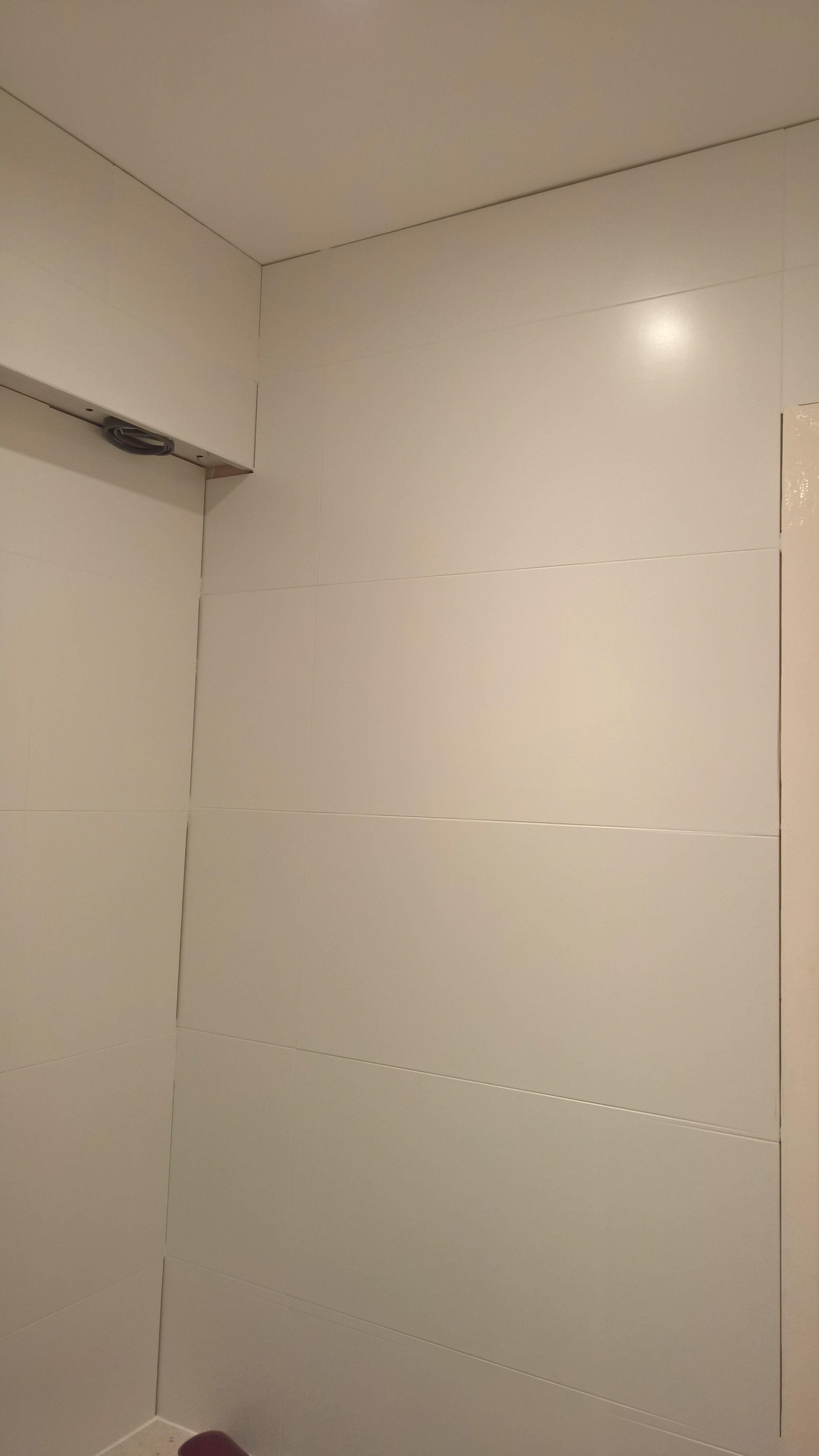

1) The 2 half tiles on the shower wall with the hole appear to be a more yellow shade. The same is true of the 1 and a half tiles adjacent to these on the other wall.

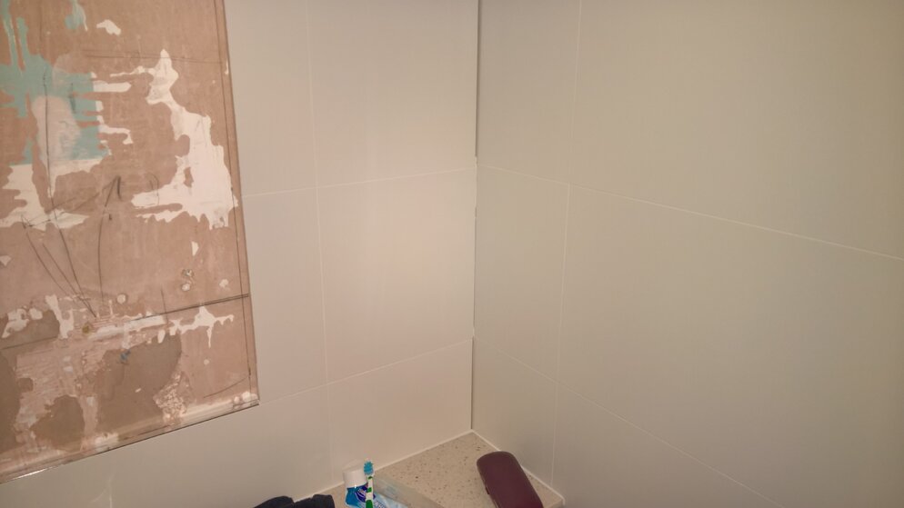

2) The quarter tile in the top corner is a different shade.

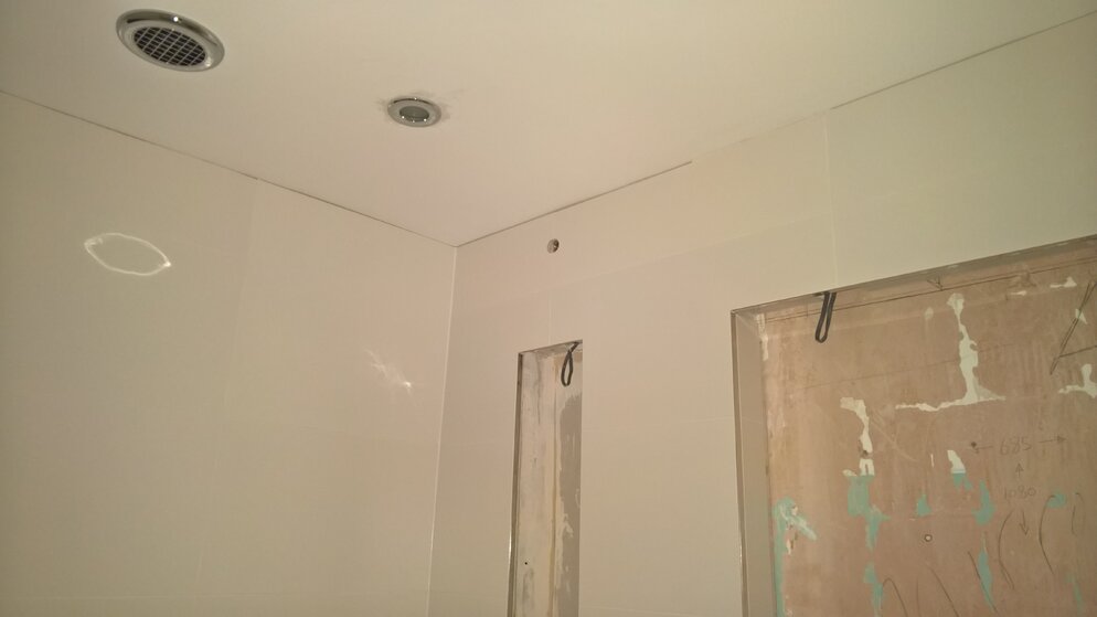

3) The second whole height tile from the top appears a different shade.

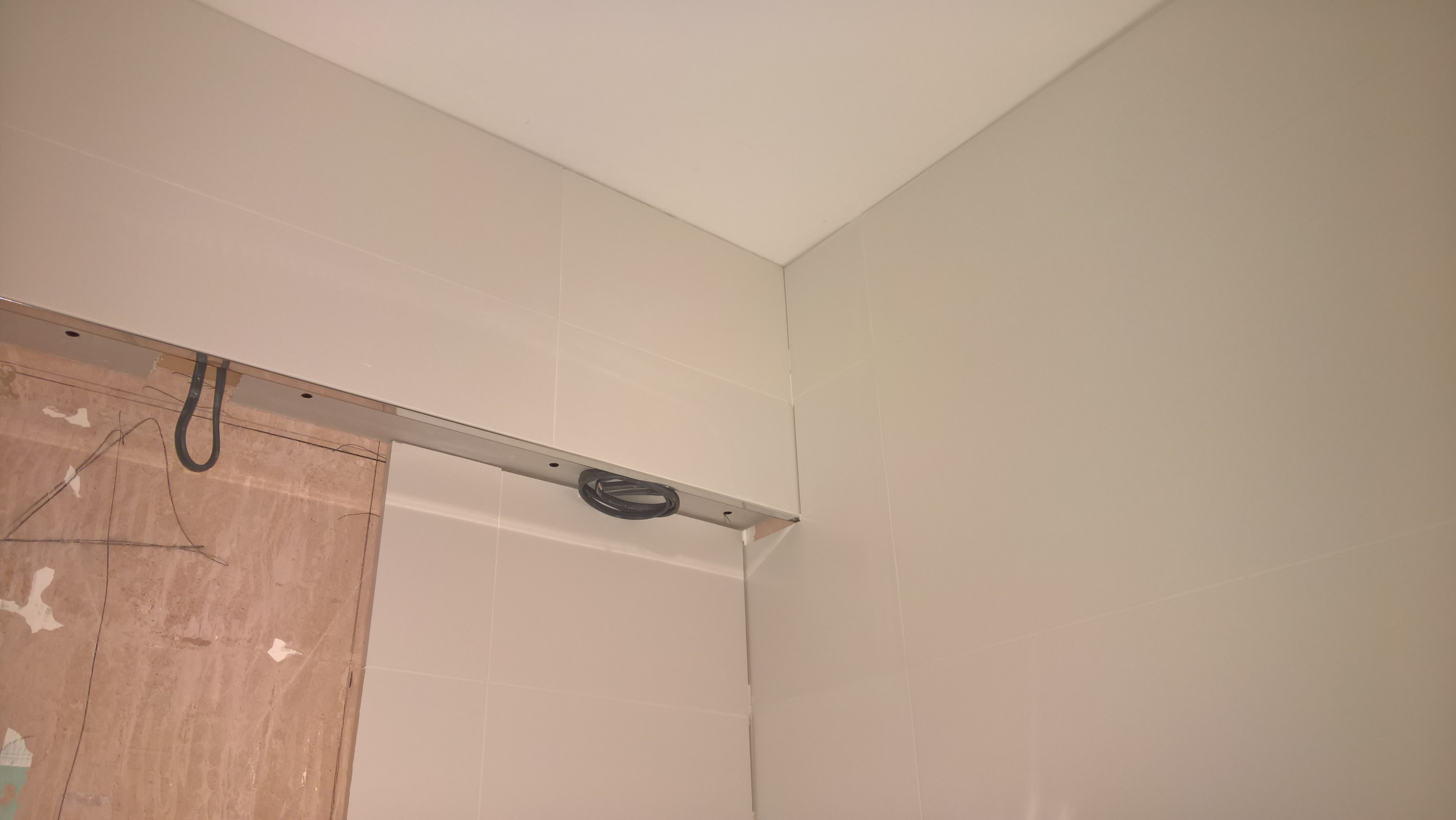

4) The one and quarter length of tiles on the top row from the corner appear a different shade.

Incidentally pictures 1 & 4 also show the plasterwork around the lights.
