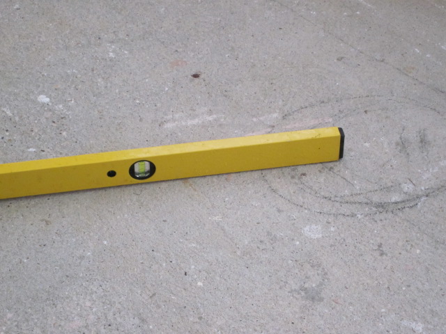

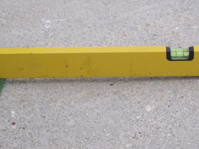

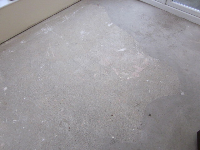

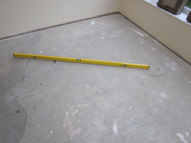

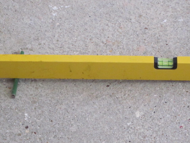

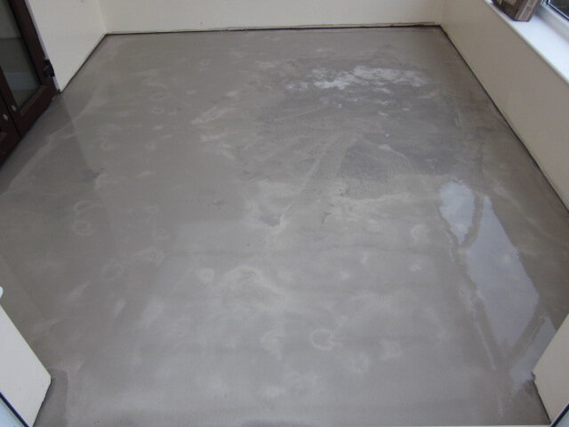

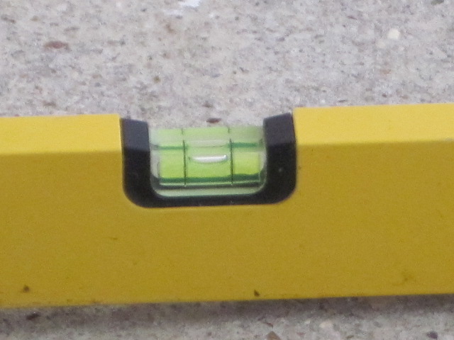

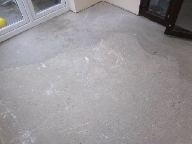

Started a conservatory floor today. Screed laid by builder who then tried to disguise the obvious by pouring a couple of bags of poor quality SLC. Pics speak for themselves :yikes:
Good old Mapei Ultraplan Renovation screed to the rescue yet again :thumbsup:

Did you feather round the high points you had marked?
oooft how many bags to sort that mess out?
4 bags mate..... got on it with the sanding block and managed to get it down a fair bit. Knackered now though! Couldnt use the grinder as walls all painted etc 😛rrr:
From looking at the screed closely you could see the wave marks where it was poured from cement mixer but never levelled
