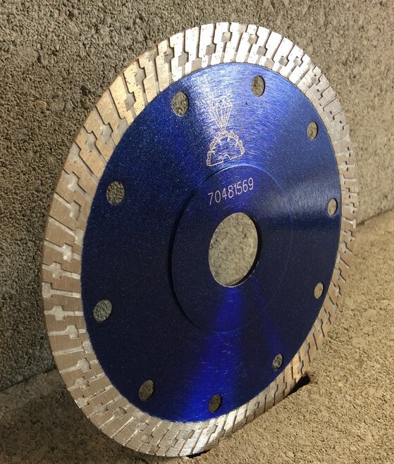

We also offer blades that are modified to fit the Festool TS55 and similar rail plunge saws. We offer a 160mm blade which is actually one of our turbo flange porcelain blades with the flange removed and a reduced bore.
These are used mainly to cut Bushboard M Stone, Max Top and most Quartz worktops and tiles.

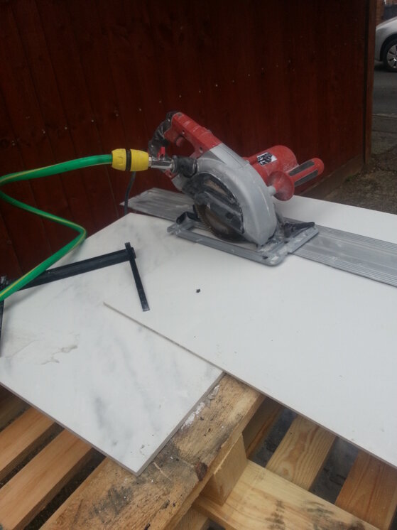

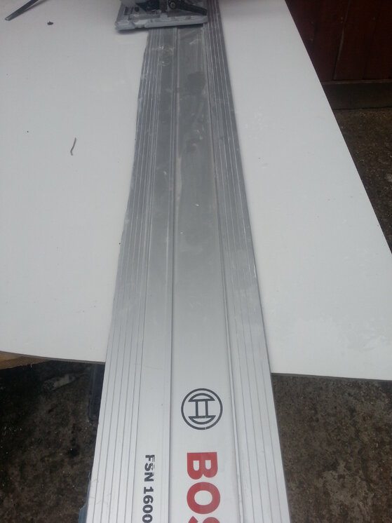

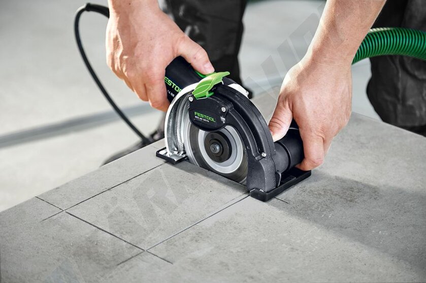

Not much dust at all if you use it right. Like a grinder without dust.
Not expensive at all if you compare to wet saws. I bought it together with this.

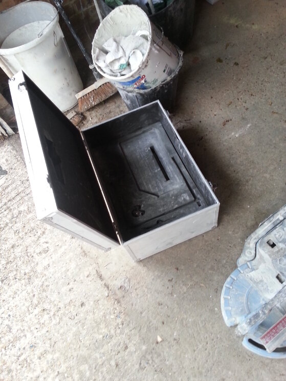

Yes, it comes with it.
But you can use any blade you like, I prefer this thinner noise reduced turbo blade
