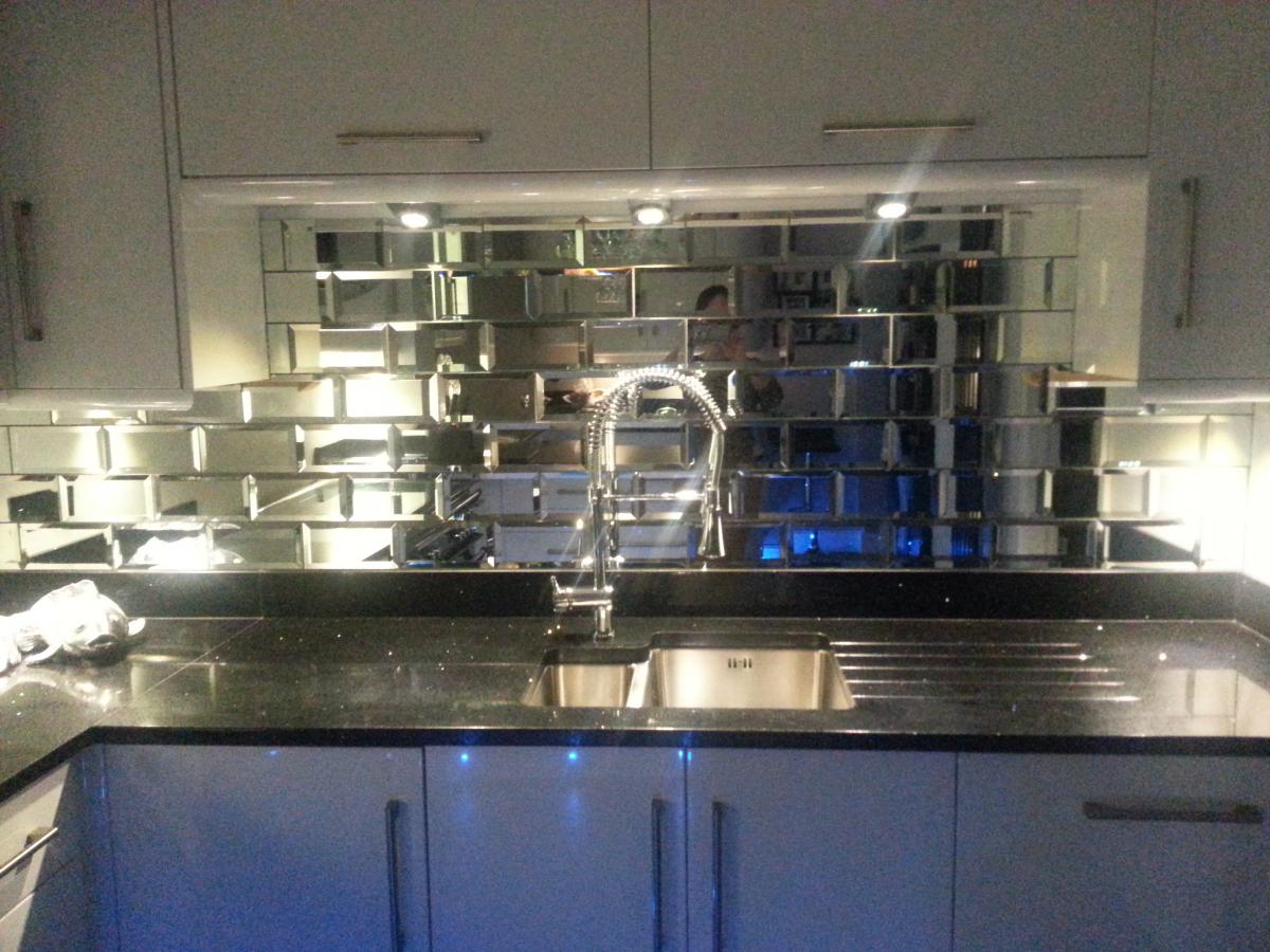

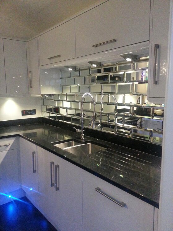

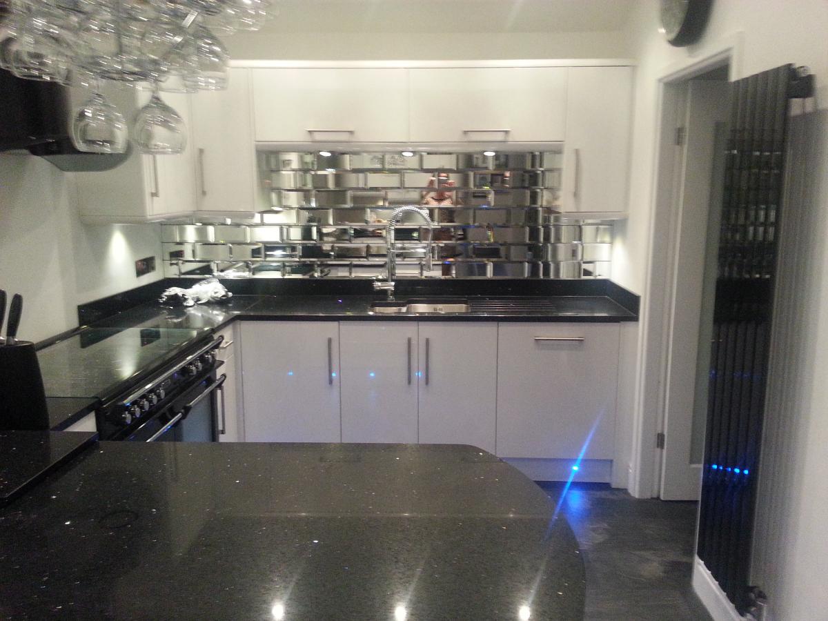

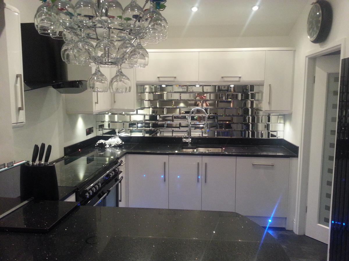

I fitted a wall full of them in a hair salon! i think she bought them from Walls and Floors also. Looked really good when done. They are not stuck up with tile adhesive though, you have to use the glass/mirror silicone stuff in a tube. Dont forget that the edges where you make any cuts (if any) will be rough, so you will need to disguise these somehow. I bought some narrow pvc beading to frame the wall with when i had finished. If you find this and private message me i will try and dig out a photo for ya. Or i will put it on here if i can work out how!!!
