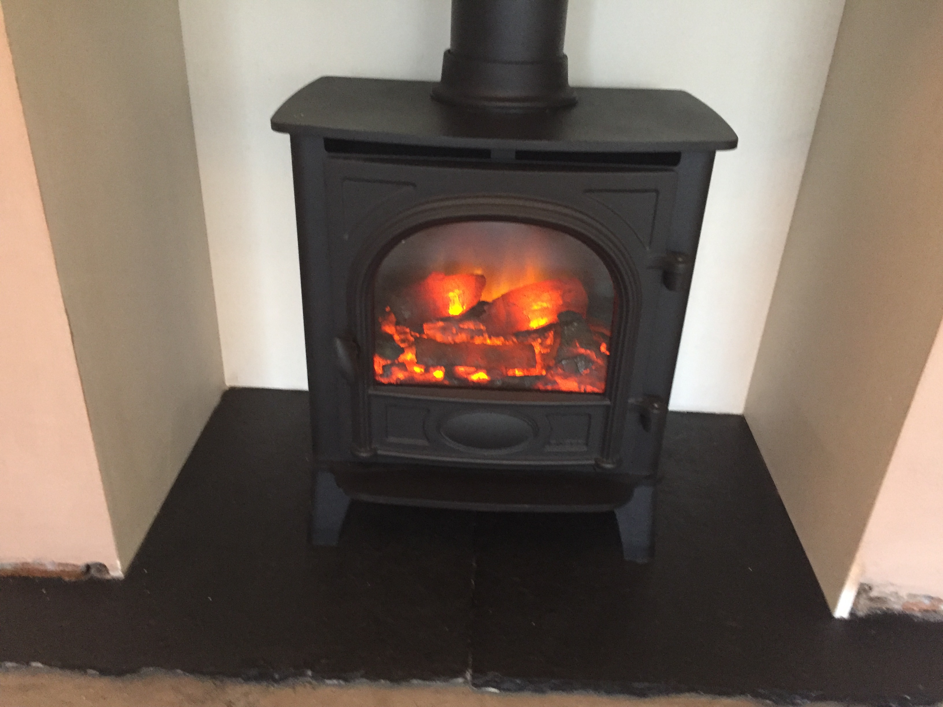

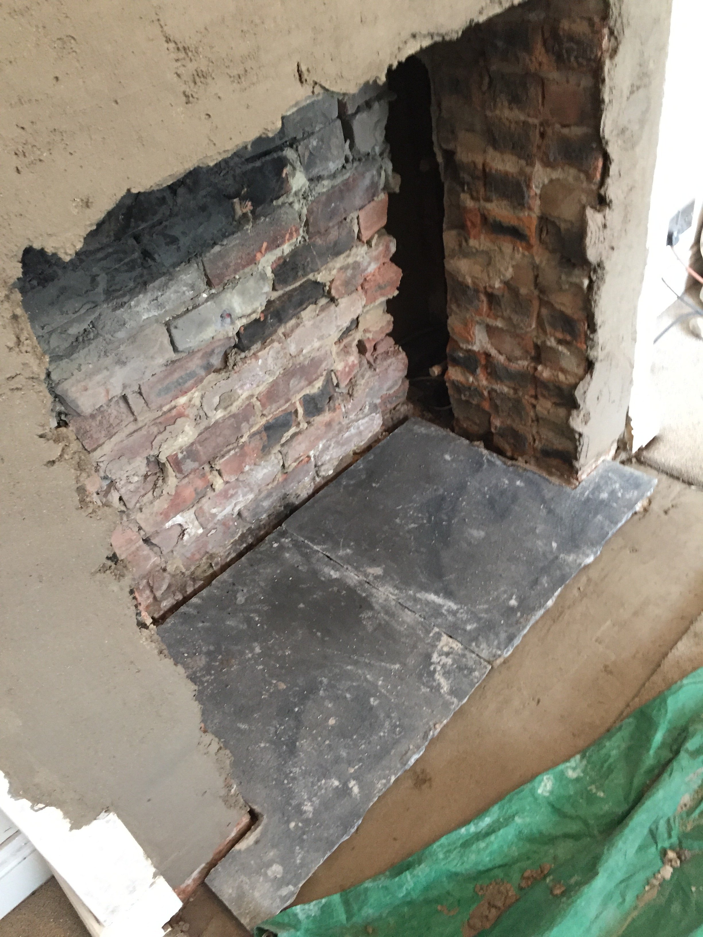

We have just had a new fire in with black limestone hearth but I wanted it to be grey like the one I saw in the guys warehouse. I'm guessing this was weathered but how can I get the same effect with my indoor hearth? I was light grey if possible. Unpolished. Raw. Rustic

That hearth looks like painted or over sealed slate to me (may just be the photo).
Any better photos?

Sorry, you posted the second pic whilst I was typing!!!!! It looks more like limestone in that pic. How was it cleaned & sealed?

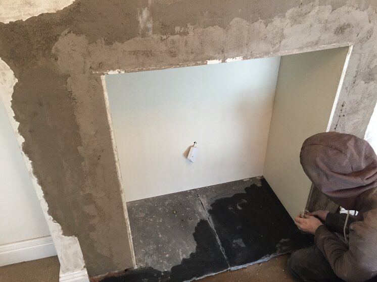

Then he washed it with baby wipes. I thought because it wasn't oiled etc, it would go grey when dry but it's jet black :(

Thanks. It's limestone. We asked for it unoiled so I don't think it has anything on it to seal it. We wanted it really bare and raw and not 'finished' with sealers etc. Wanted it grey in contrast to the jet black fire

Baby wipes!!?? They can have oils in them. It certainly looks heavily sealed to me.
If you can't readily find out if & what it was sealed with then I would look to clean it thoroughly with something like Lithofin Power Clean or LTP Grimex. Let it dry fully and then lightly seal with something like LOT Mattstone or Lithofin Stain Stop.

Lisa , looking again .is that finished pic with the fire in it yours , as plan, it does look sealed , if so you can just strip it out

Yes all the pics are mine as it was being done. The top one is how it looks now. They just cleaned it up with baby wipes. How do I strip it out?
