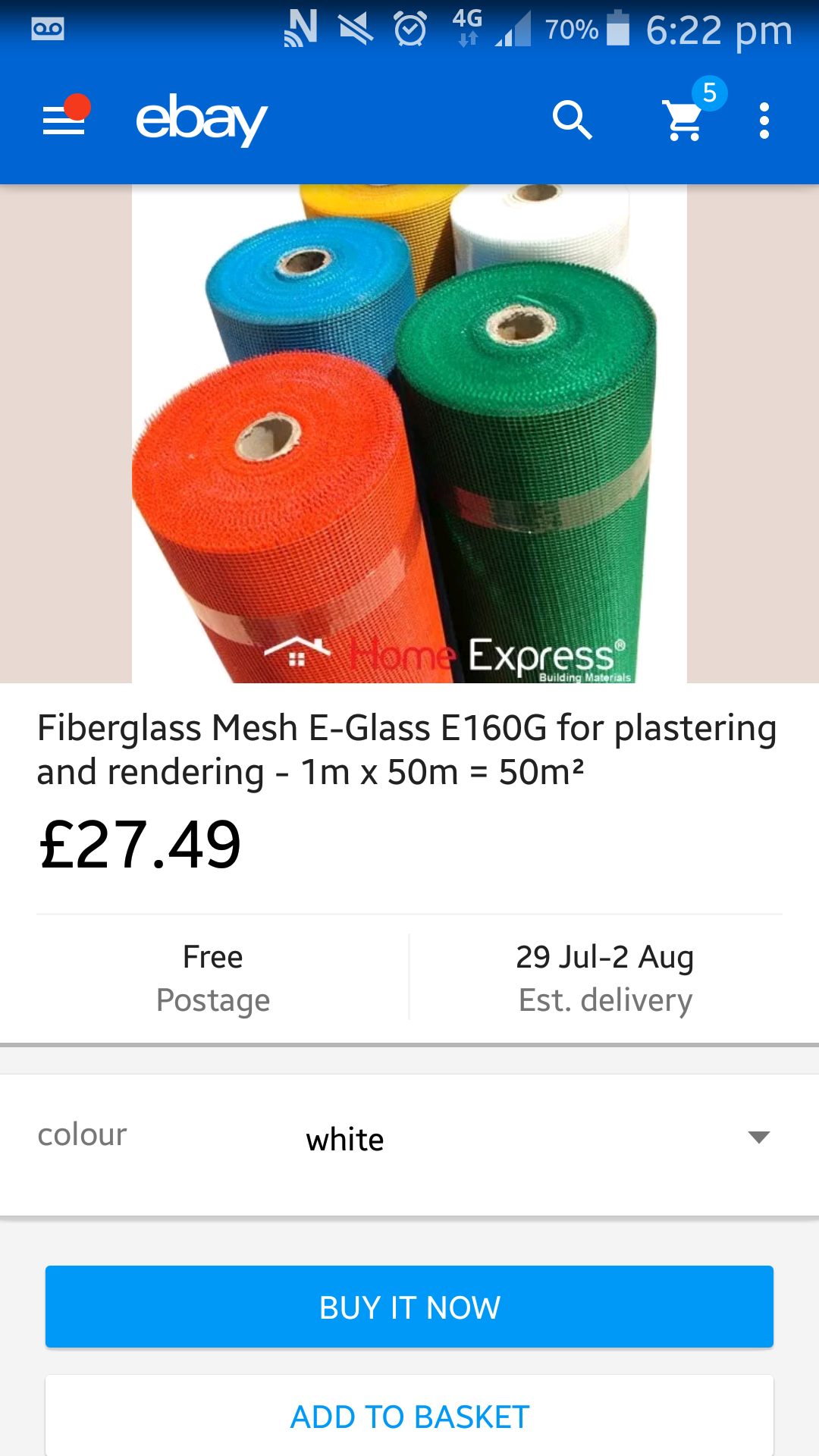

I've just read a post and the idea of using a hot glue gun to stick them down sounds like a good idea but before that I was think about stapling some render mesh over it its about £25 for a 50m roll which is 1m wide so effectively it's 50sqm and its gonna add a massive amount of strength to the screed isn't it ? obviously this only works if ur using a orbry/wedi type backer what do u fellas think am I a mad man or a genius lol
It's fiberglass so I'd guess it would be ok as the board joint tape is pretty much the same thing and so is the mate the wire is attached to ?
