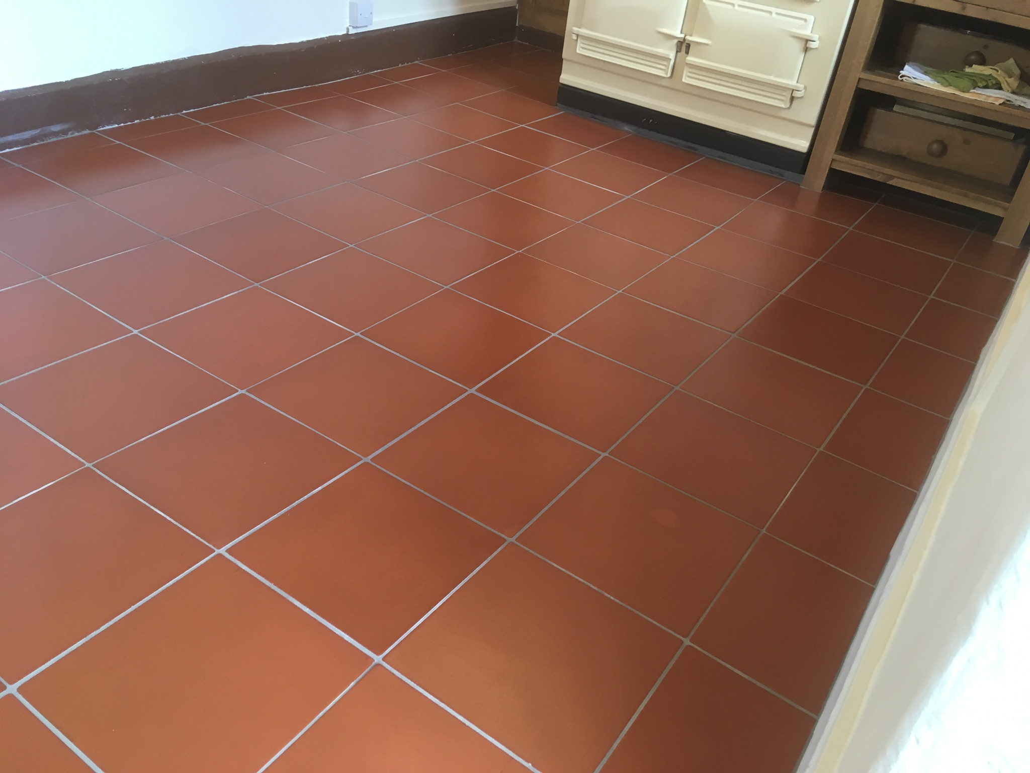

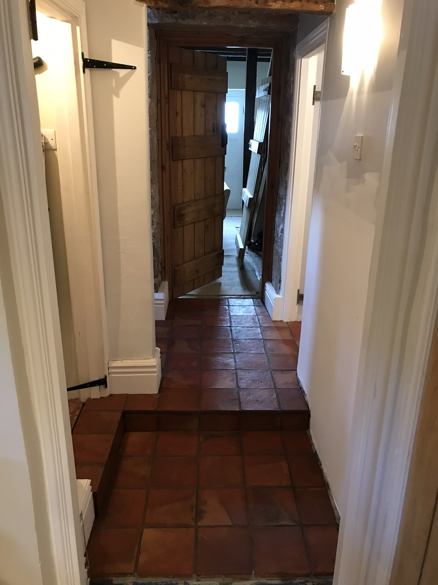

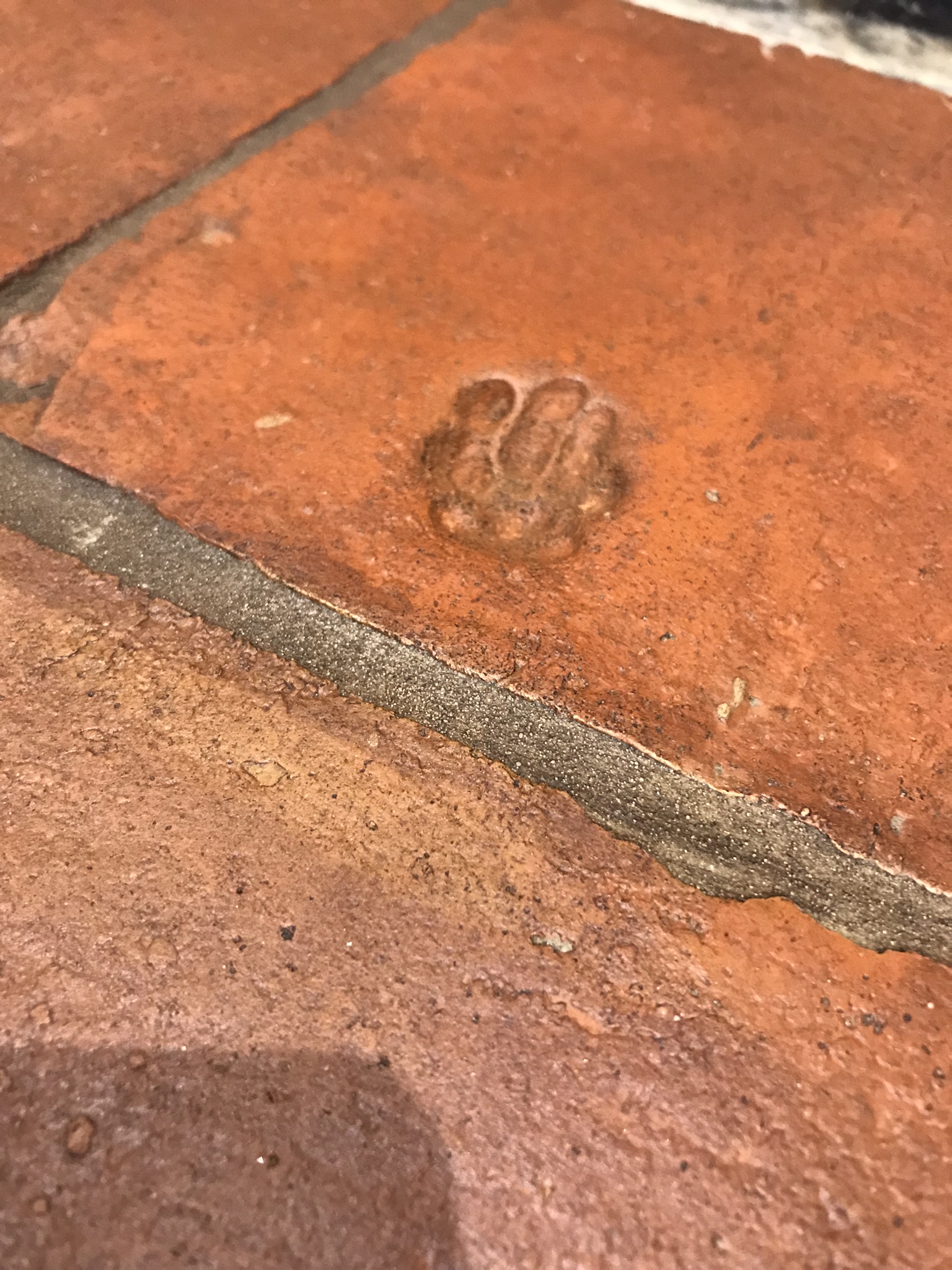

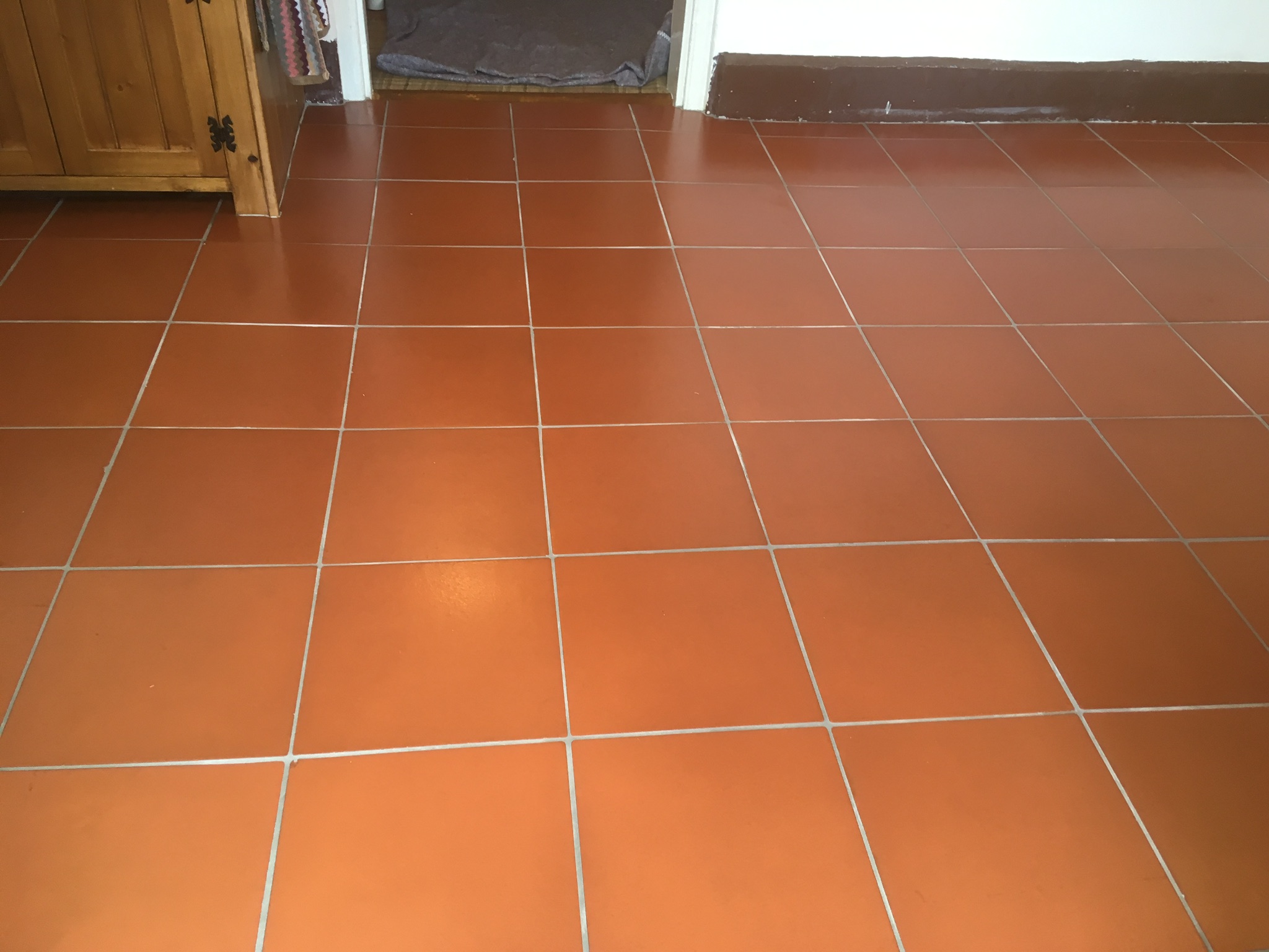

F Flintstone Sep 7, 2018 #3 Boiled linseed oil, and finish with a nice wax. Look at ltp products. One I have done this year using those methods

Cris TF Sep 7, 2018 #4 Nice looking work. Because they so porous will back buttering be enough? My worry is the tile absorbing to much moisture before adhesive sets

CJ TF Arms Sep 7, 2018 #5 These had 3 coats of boiled linseed/Turps, before laying, then once laid, a neat coat of oil. Wiped over the backs with a damp sponge as I was laying them

Cris TF Sep 8, 2018 #6 Localtiler said: View attachment 100614 View attachment 100615 View attachment 100616 View attachment 100617 View attachment 100618 Boiled linseed oil, and finish with a nice wax. Look at ltp products. One I have done this year using those methods Click to expand... what did u use for jointing. strong mix of sand and cement?
