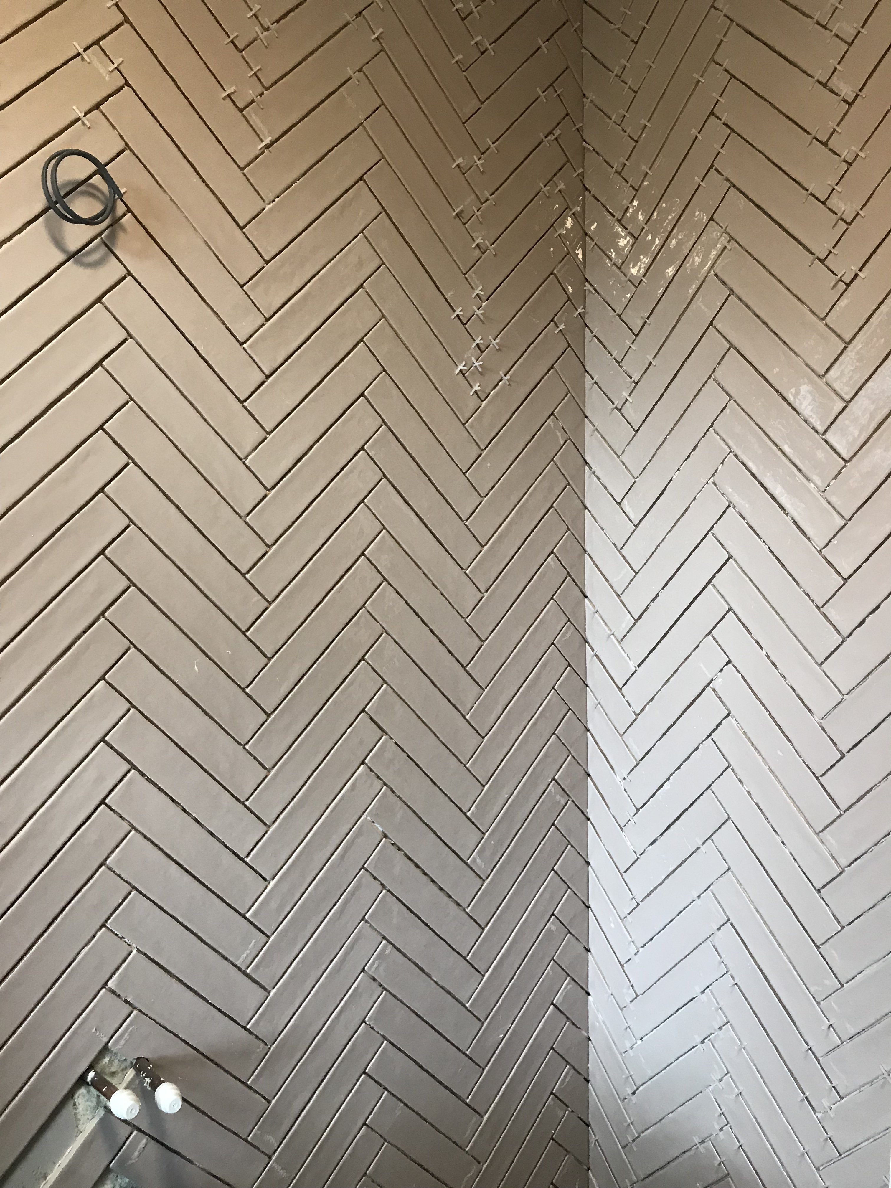

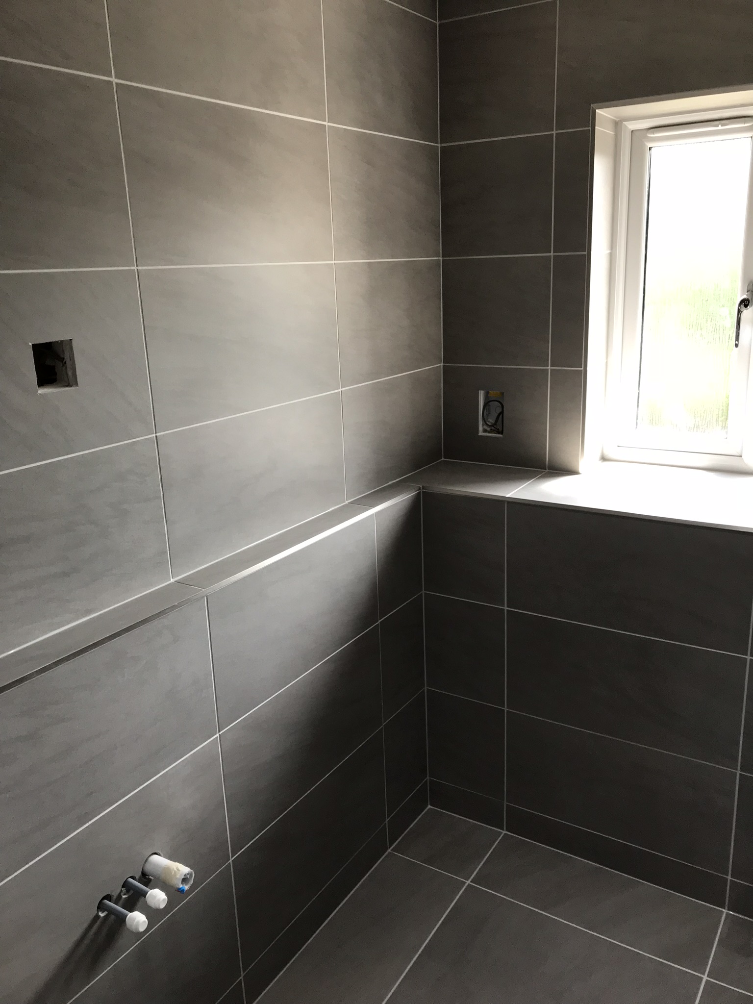

M Matt penno Oct 13, 2018 #33 Cant wait to get back to grey after these horrible things (please dont pull me on none mitres the customer wanted trim to trim, a very odd woman )

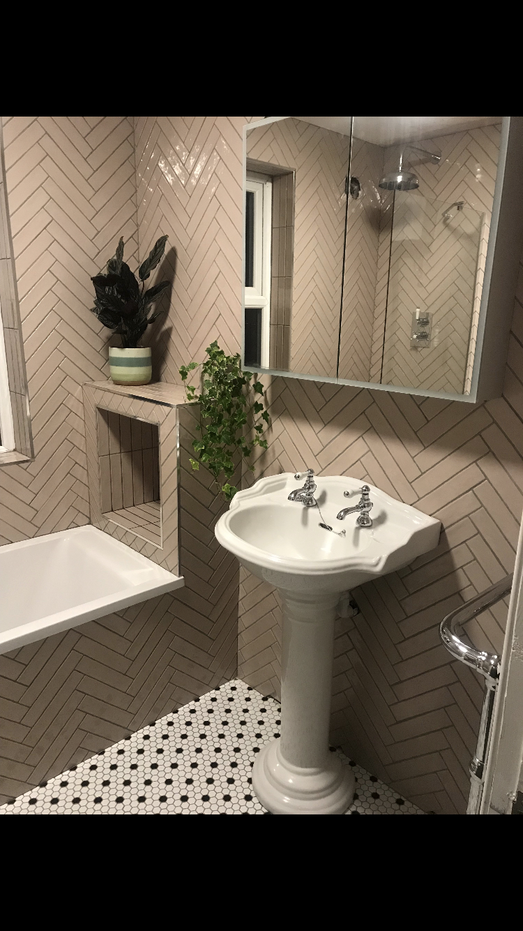

D david mccullough TF Oct 14, 2018 #35 has she noticed the lose of pattern at corner above the plant?
M Matt penno Oct 14, 2018 #36 Yes as both walls had a dip in causing a run off, cheers for noticing though can put the claws away now
D david mccullough TF Oct 14, 2018 #37 not criticizing in any way I've just done a couple of jobs with same bond and it's easy to slip up, but i'm talking about the tiles going round the corner going in the same diagonal rather than the V shape
B Blunt Tool Oct 14, 2018 #38 The right hand wall tile wrapping the corner should be pointing downwards
