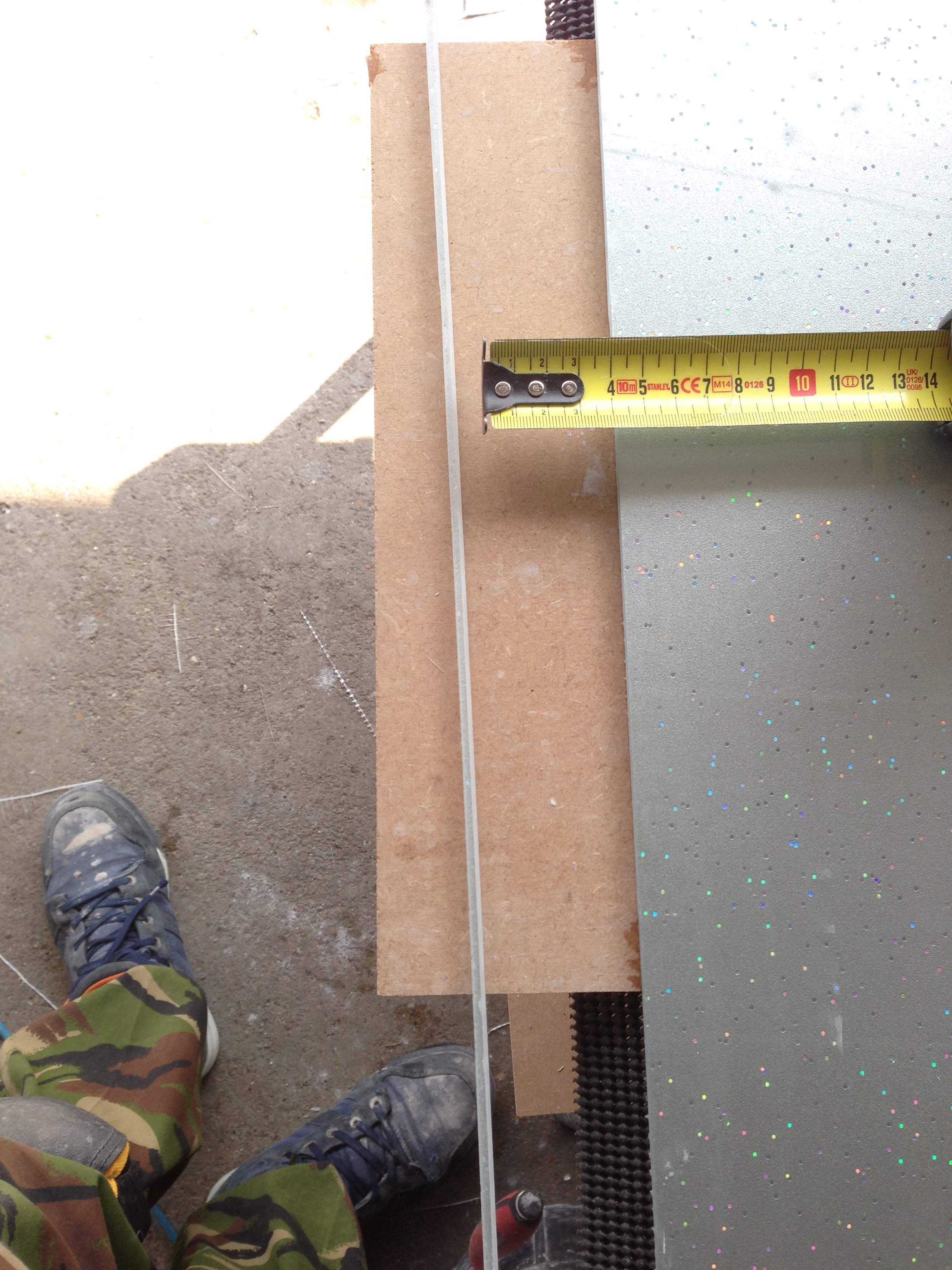

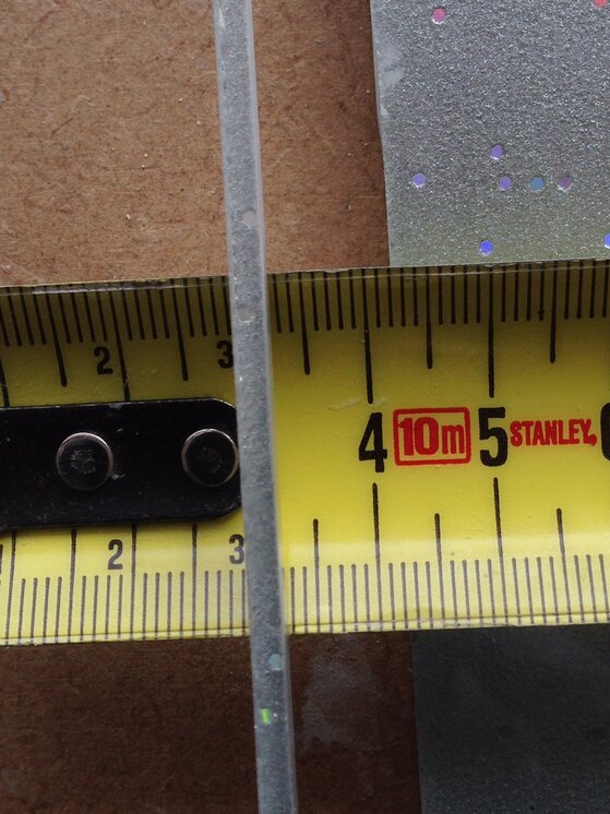

This is the 180 on a wet cutter.
2.5mm x 600mm in one piece.
