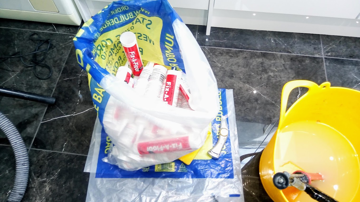

I used this Fix A Floor quite a few times over the years. It is a good product for a quick fix. To my last customer in London, we used over 200 cartridges per customer's request. The entire kitchen floor was hollow and squawking. It fastened the entire floor like a rock. Good luck!
