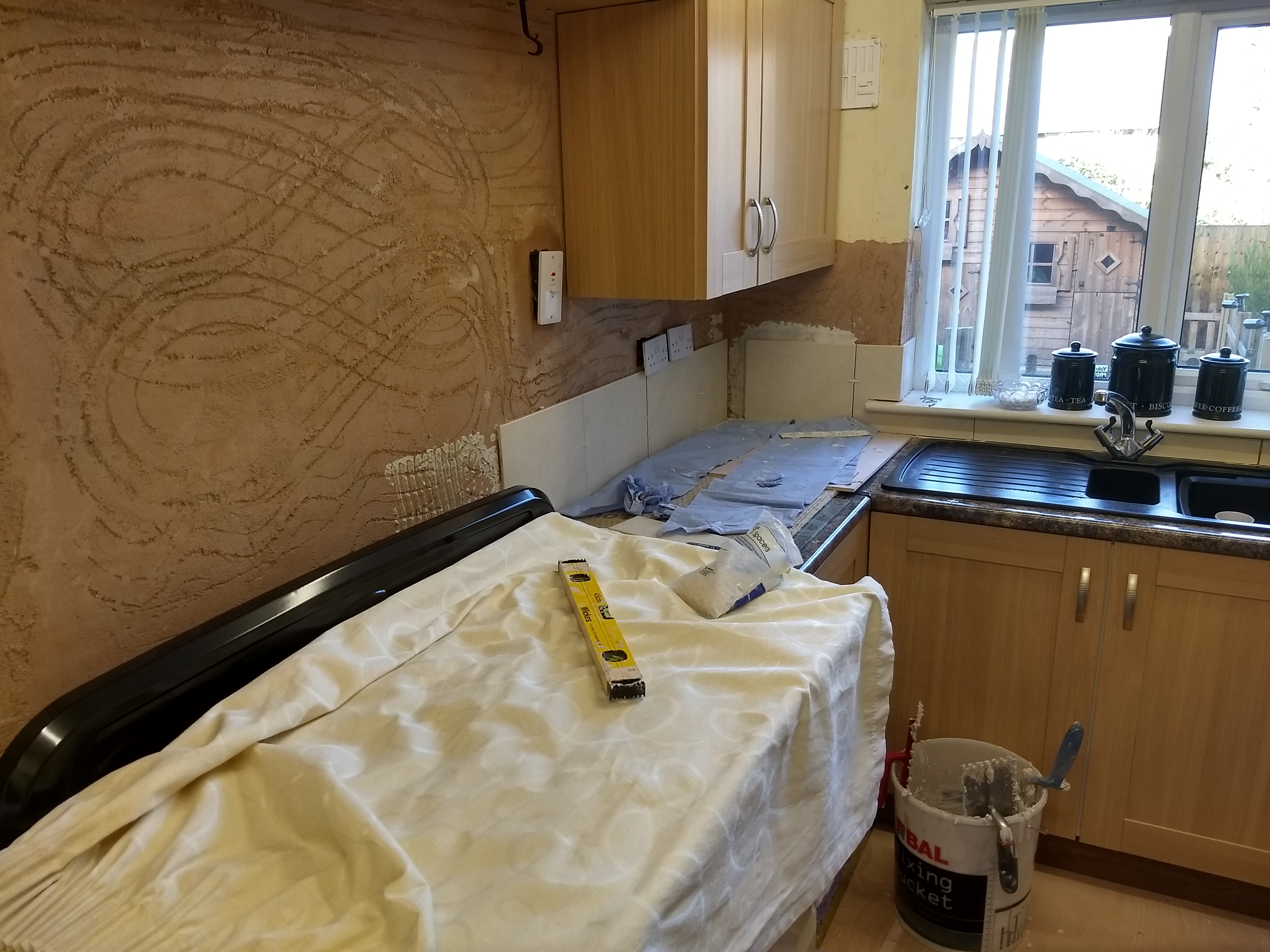

Customer called me as they had removed all old tiles from wall and made a mess of the wall, therefore needed the kitchen wall sorting.
Popped round and quoted them £250 for 2 days work including adhesives and grout.
Customer had a plasterer in to sort walls out before tiling but plasterer had back bonded them but said they were fine for tiling.
Turned up on first day and walls were pretty messy, cust had also pva'd walls on plasterer advice. I advised that pva shouldnt be used, so i scrubbed walls and stuck Bal primer on them.

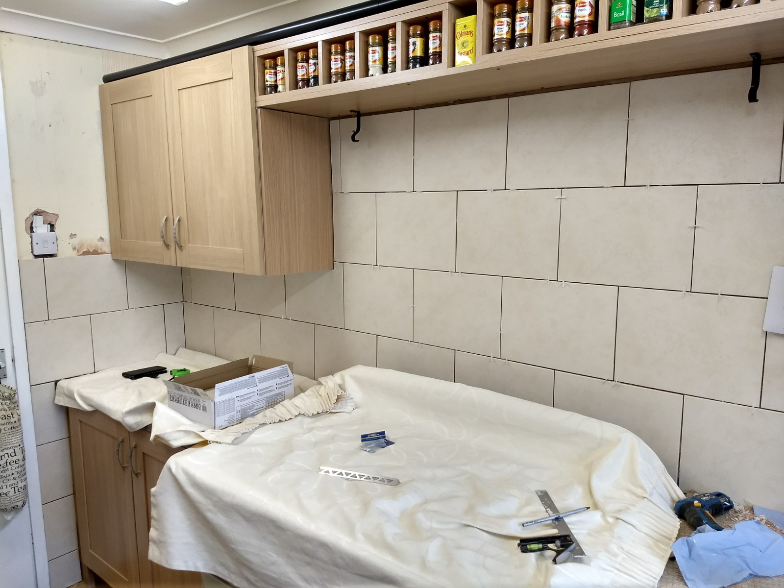

Cust also told me that 2 separate worktops were not same height (15mm gap) difference from one worktop to another. advised him that one side would use 3mm spacers over a few tiles to make the gap up from one unit to the next where i used 2mm spacers.
All agreed by both.
Anyway struck up good rapport over 2 days with customer and managed to do what i thought was a decent job.
Received payment, however 3 days later wife contacted me to say they were pretty unhappy with work done. At no time over the 2 days did anyone intimate the work was bad, quite the opposite in fact, so much so that i was asked to re do the bathroom which they werent happy with from the last tiler who had done that.
One complaint was regarding plug sockets as i had tiled under the edge of the sockets which i had left in a "dangerous and avoidable" condition. I admit maybe one was borderline tight but the rest were no different to numerous splashbacks in the past.
Also some of the tiles were not 100% flat in places, I explained that because the wall was so uneven with differences of 20mm from place to place it would be hard to get everything completely flat, along with the fact that 75% of the tiles had a small bow in the middle.

3. apart from the sockets, they werent happy that i left a 2mm gap under the wall cupboards (which were filled with matching Silicon), does anyone else leave a gap under cupboards?

added a few pics also before and after
