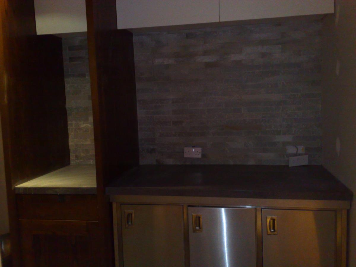

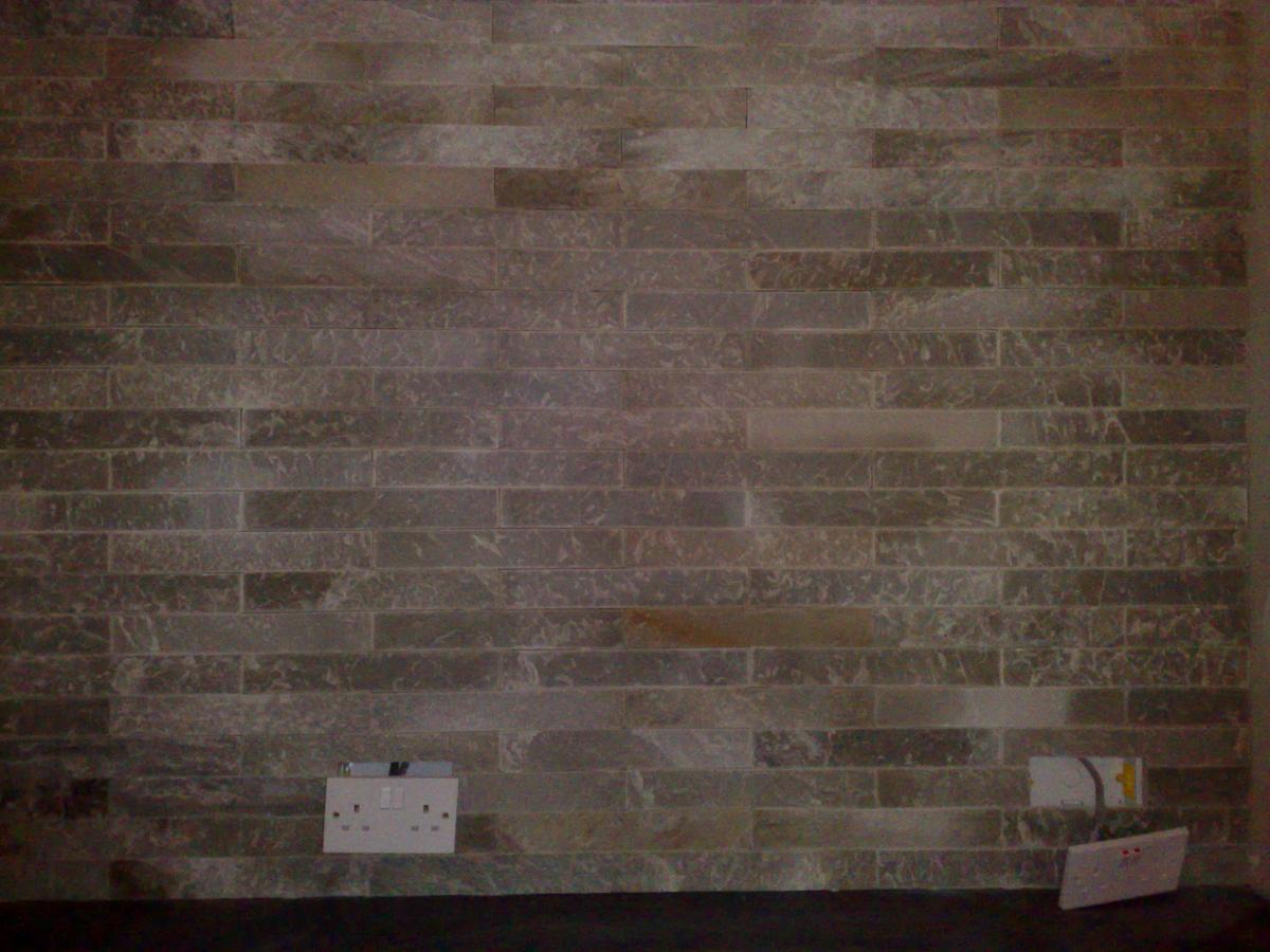

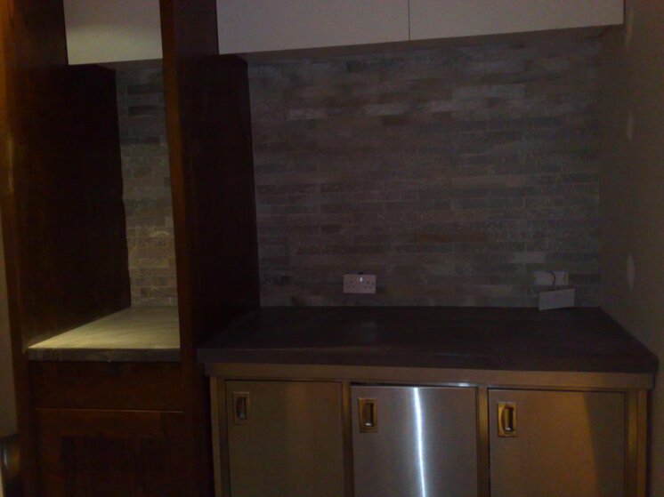

13092010538.jpg10092010528.jpg10092010526.jpgTiles turned out to be 300x50 slate. I only had to tile just over 5sqm, but due to other trades onsite it took 2 days. Also, due to the size of the tile I had to make about 300cuts!!! Very slow (but enjoyable) process. As requested by the customer I did not put in a grout joint. Strangely enough I was on the platform of Paddington station at the weekend, I walked passed McDonalds and saw the very same tile (no grout). It goes without saying that I did advise about having no grout, but as they say ‘The customer is always right’ Cheers for your help. Sean
