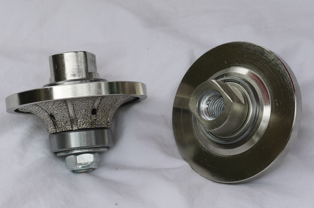

You'll need one of these, at 10mm or 15mm depending on how large you want the half bullnose:-
Then polish with some silicon carbide pads.
Both fit onto a variable speed grinder/polisher.
