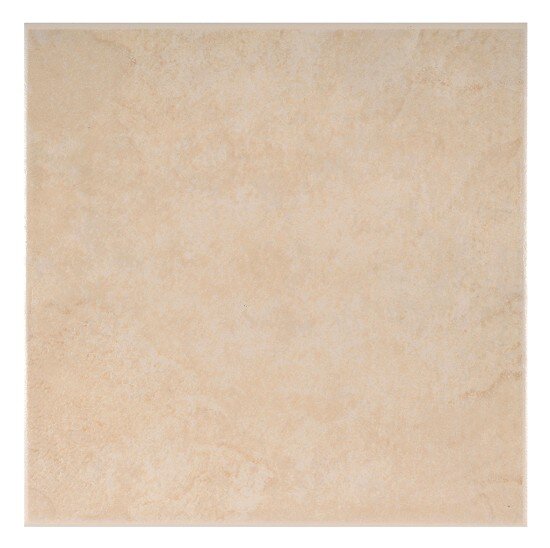

finished grouting my wetroom with mapei ultracolour plus white grout. i've got 30x30cm ceramic tiles with a textured, stone effect finish (should be a picture attached to this thread). i grouted to procedure and wiped tiles down several times, using 2 buckets of water and changing the water regularly. trouble is no matter how much i wipe there is still grout haze on the tile and even some patches of grout in the dips of the tile's surface. what are my options for removing this:

Do you have any pics of the actual tiles??
