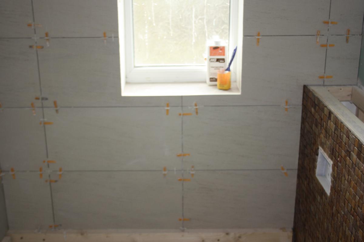

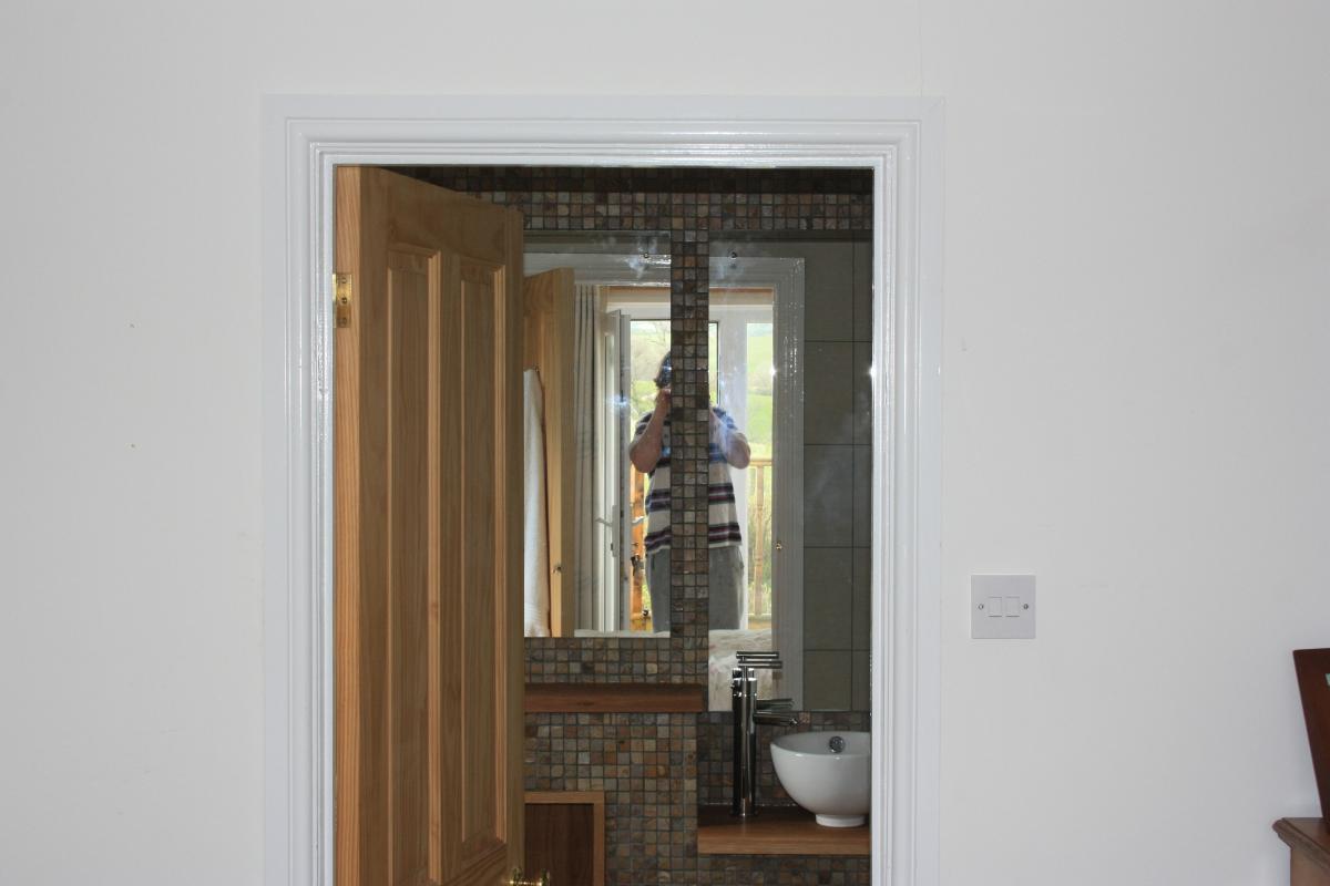

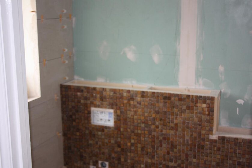

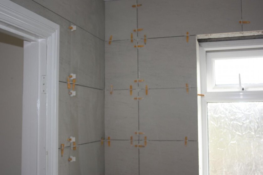

recently used lash clips on a bathroom and found them great. i know most tilers wouldn't touch them but is there any real drawback from using them.
this is a recent bathroom and en-suite i installed and used lash clips for the first time.

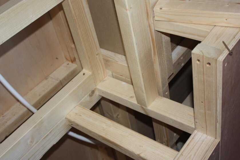

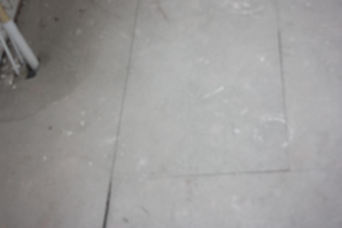

i always replace every wall with moisture board, tile backer board or marine ply.always prime with latex and always use spf i found that on this project i saved around 3 days using the lash clip system and felt there must be a catch.

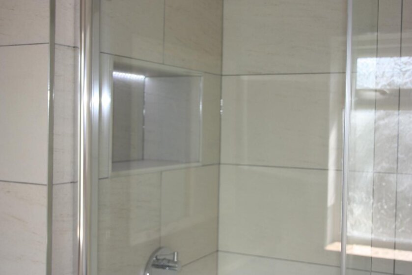

results were fantastic
just need to find a way of saving time on the building work i do
really would like to here from anyone who's experienced problems with tile leveling systems. thanks..Richard
