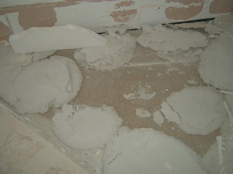

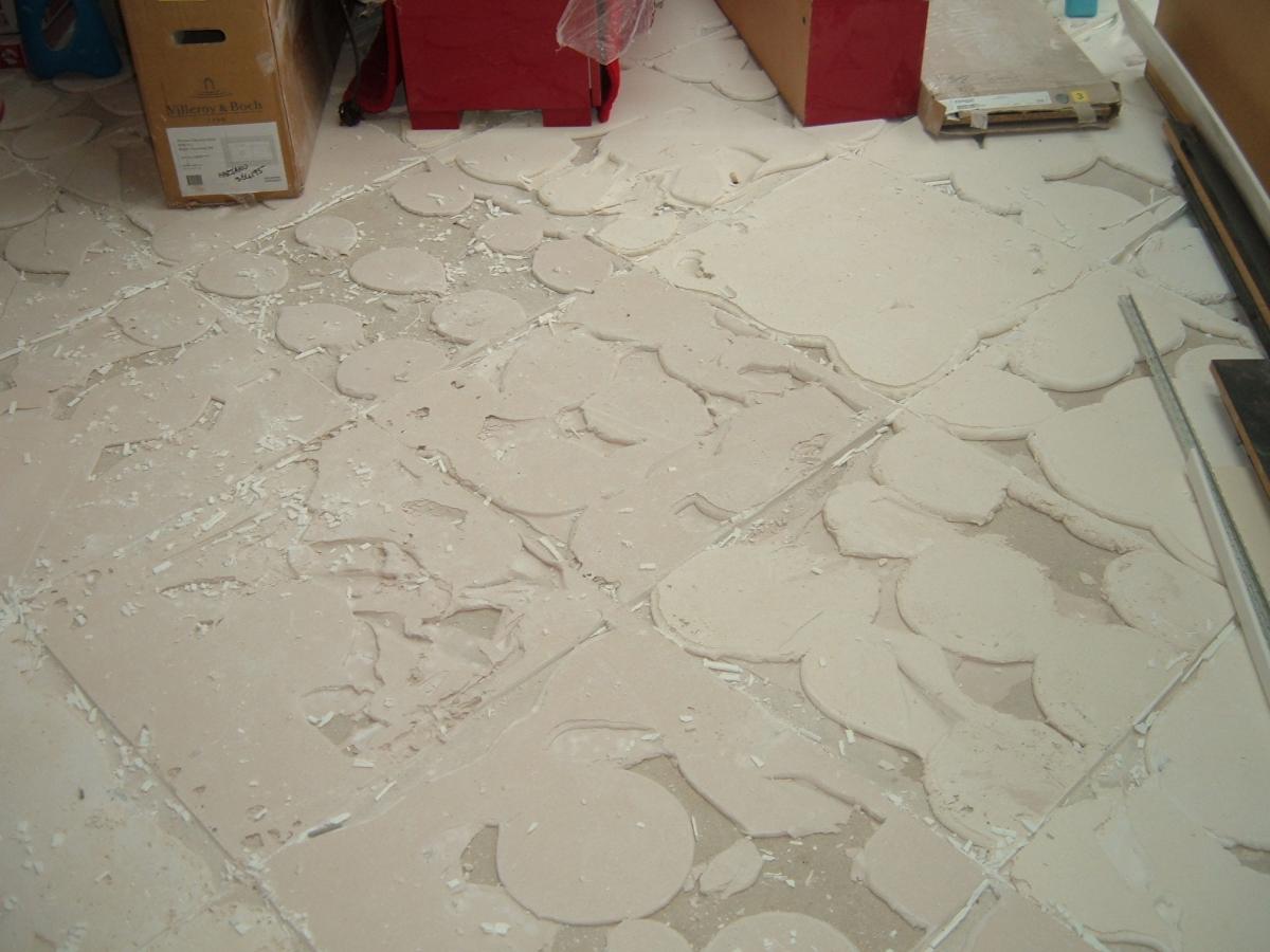

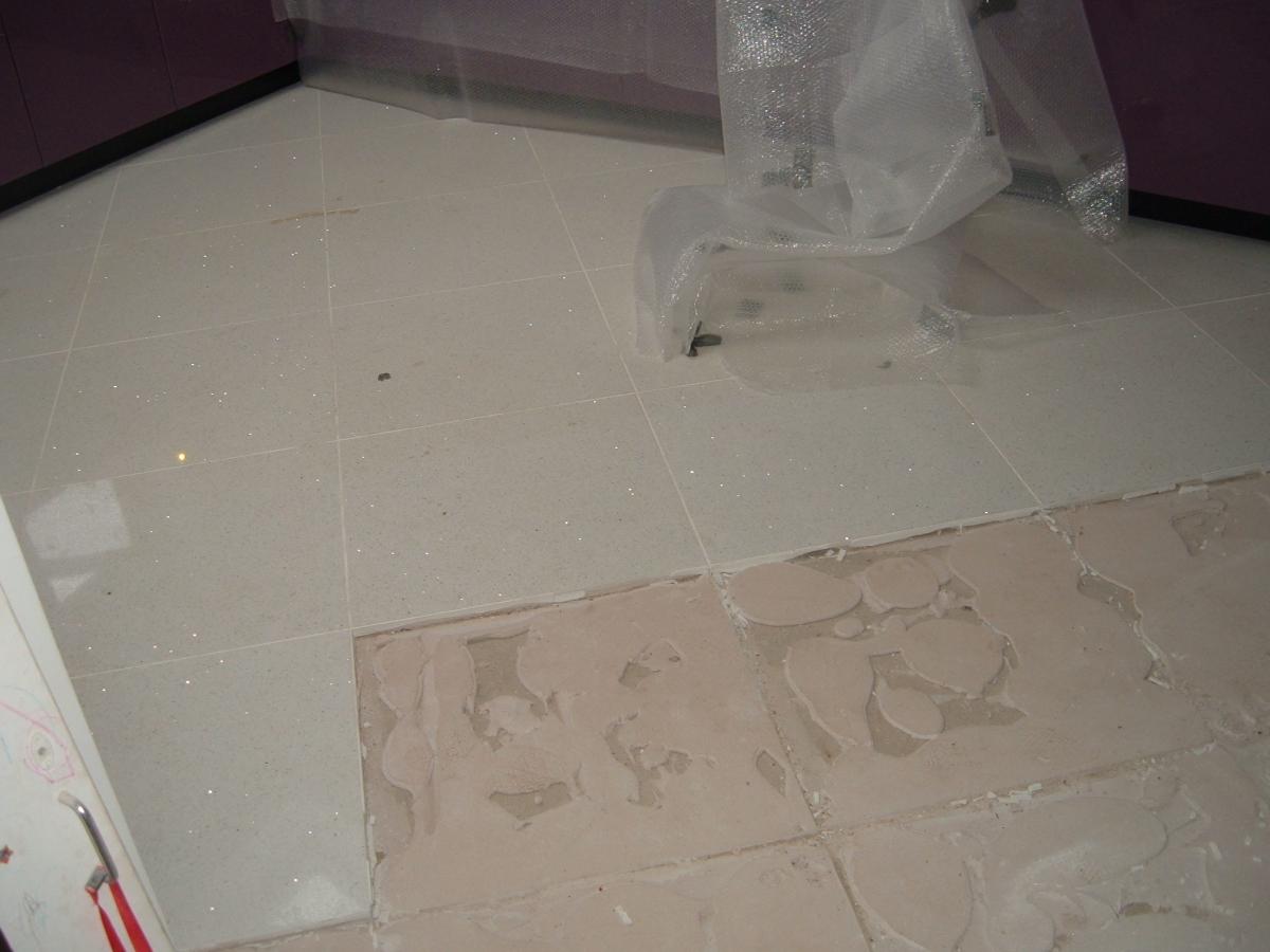

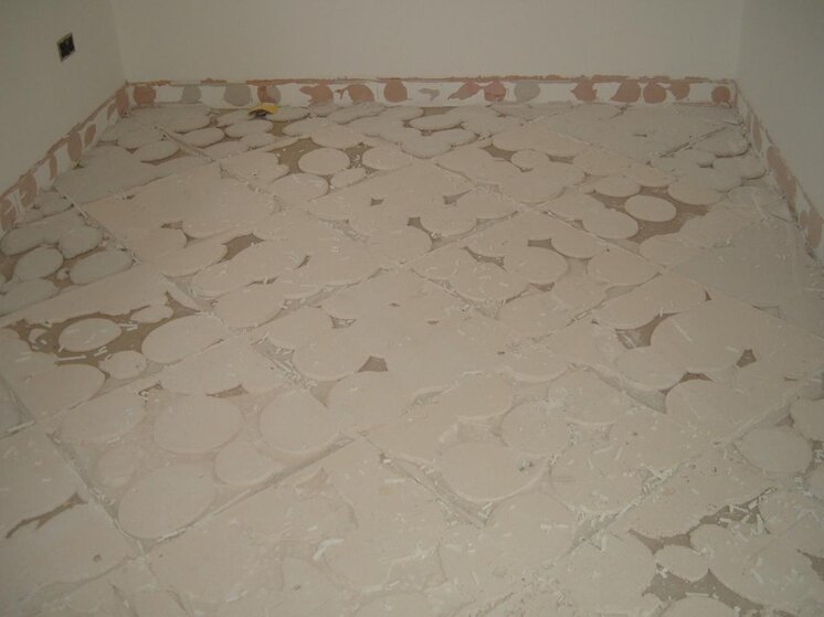

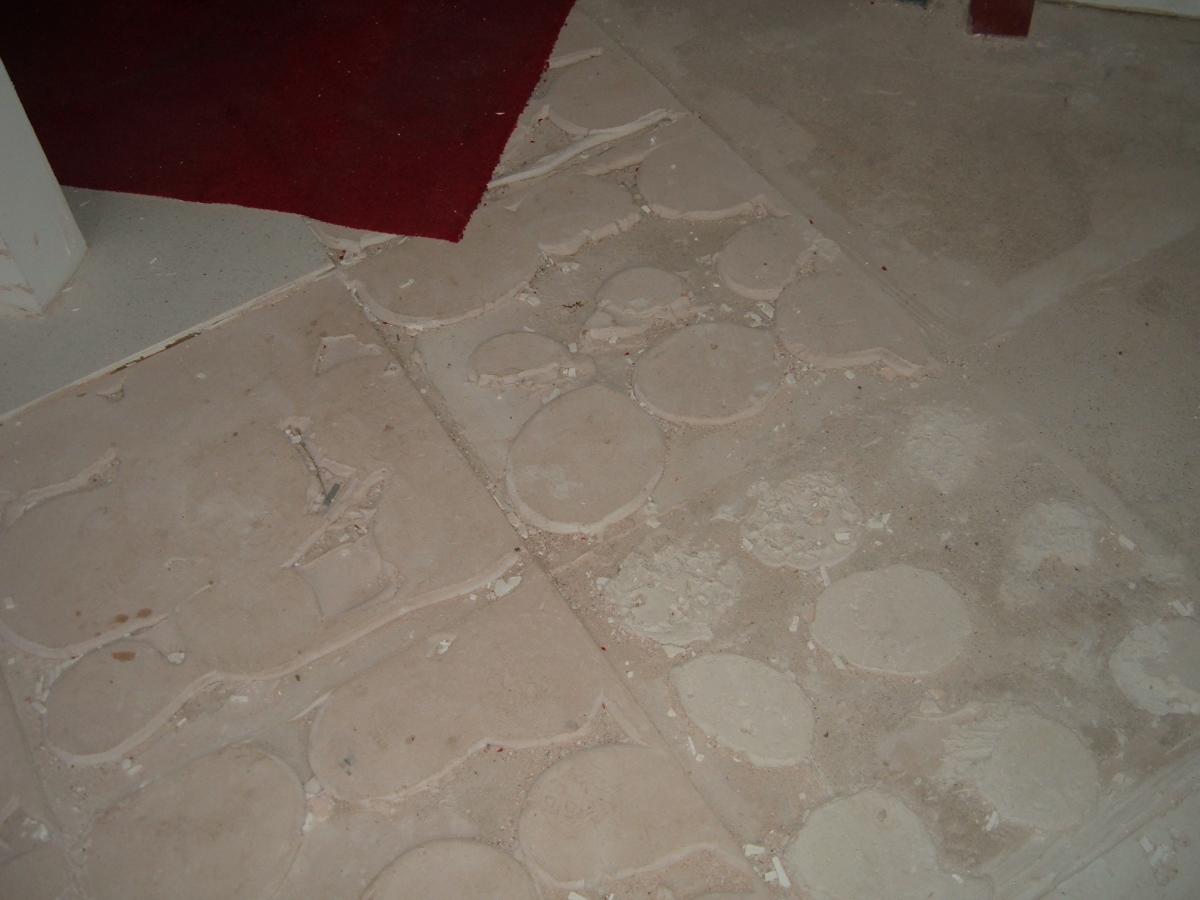

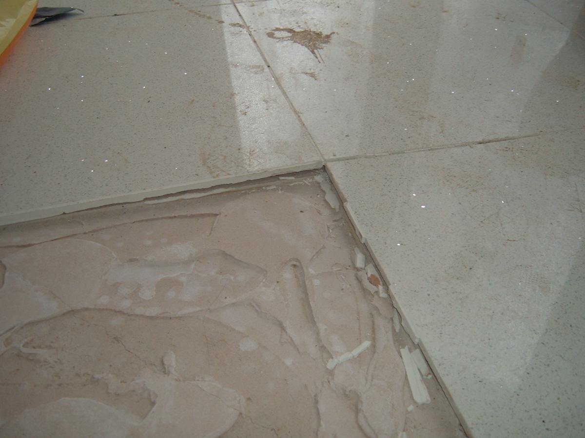

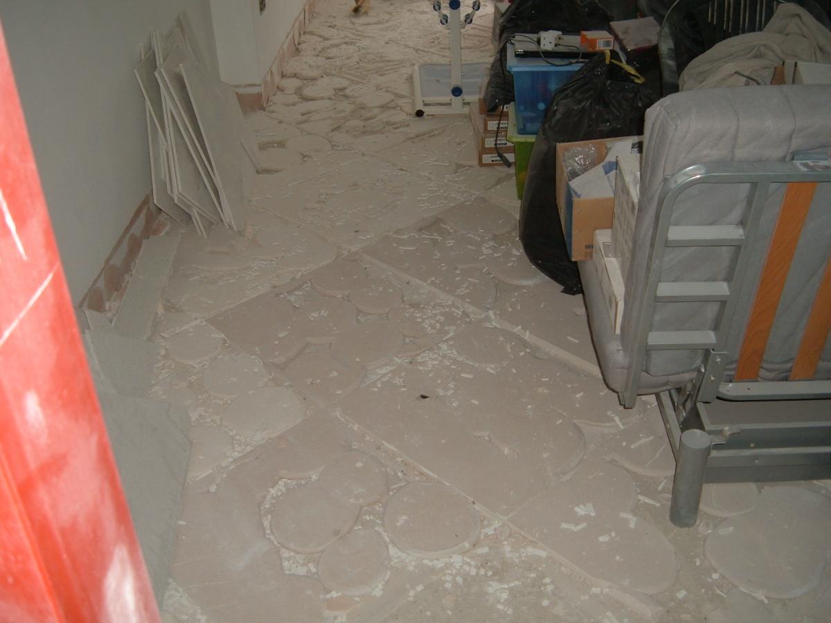

This is a job I went to see today and posting in here because it was in "Looking for a wall and Floor Tiler".
The job had been fixed about a 6 weeks ago and there's about 90m2, the guy who fixed it laid it in 3 days.
There is underfloor (water) heating and the tiler new this, a plumber told the client to turn the ufh up full blast in one go after it had been tiled.
The tiles were quartz and when buying them had not been told at the time they should not be fixed with ufh, the tiler did'nt know either.
Some pics to show the problems, the tiler has been told he will taking up the dabs of adhesive.
