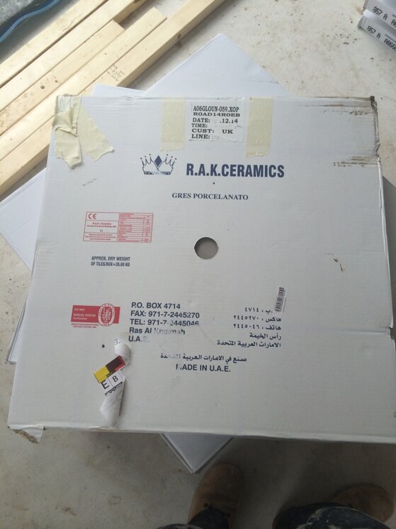

Fitting polished porcelain 600x600s, a fair bit of wax on the surface, used Wexa at 1:10 dilution then dropped it down to roughly 1:4 & the wax is still clinging to the surface.
Took me about an hour to clean 2m2.
I've 150m2 to fit in the next couple of weeks, has anyone any tips to speed up the process of cleaning these tiles?
Was thinking of hiring an industrial floor cleaner/polisher.
