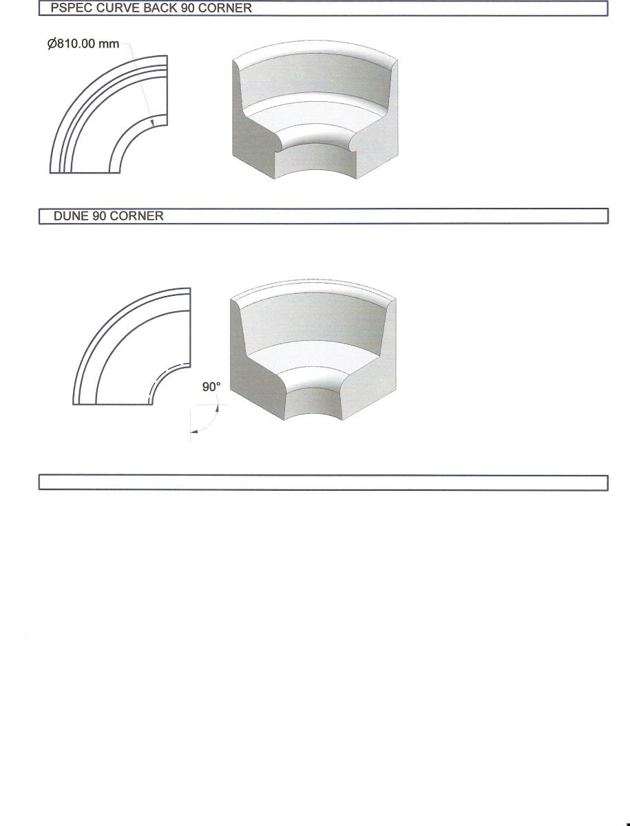

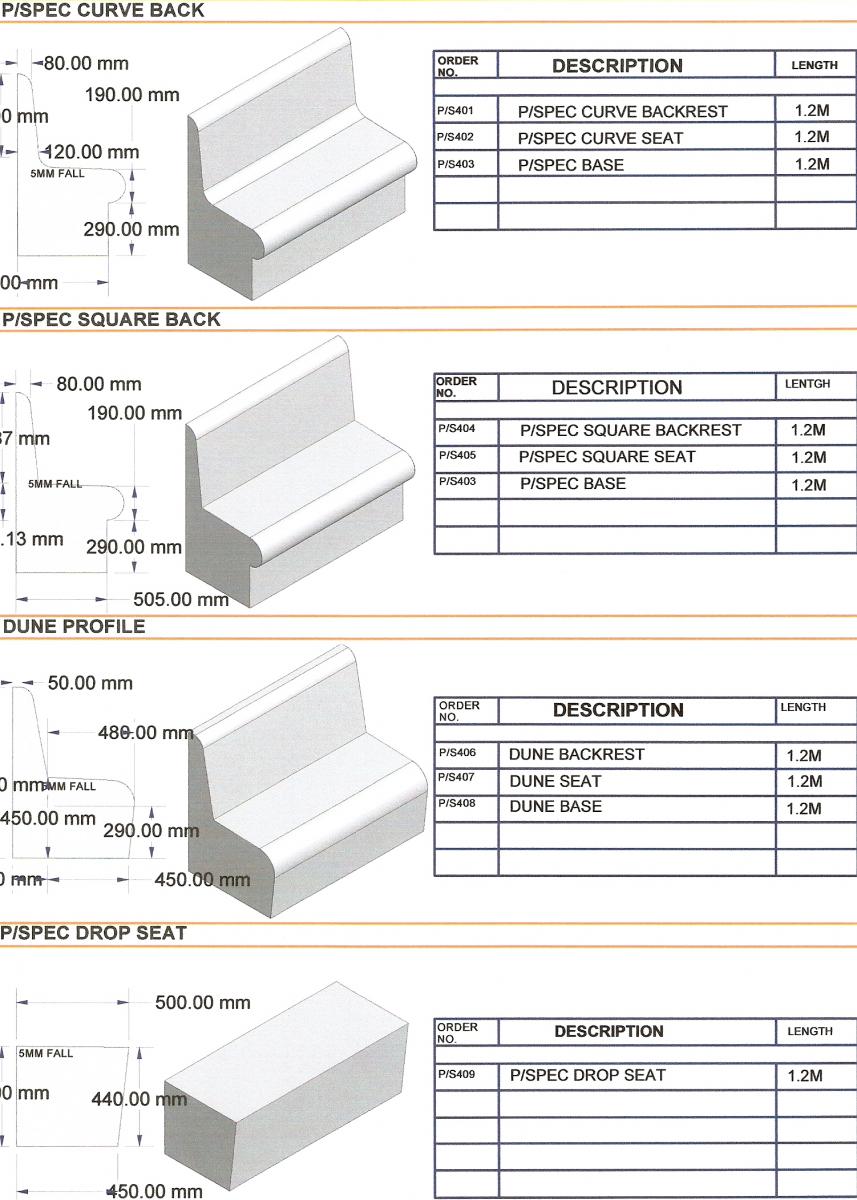

The dimensions of each straight section are 1200mm each section consists of a base, seat and back rest. We would recommend fixing the units with an MS polymer adhesive, if the benches are free standing then cost would vary slightly as an additional timber frame would have to be built in for support.
The corner sections are expensive and an alternative would be to use 2 x straight sections and mitre them together which our supplier can do for you.
The prices below are meant as a guide price only. The best solution is to see a diagram of what you would like to achieve and we can then give a true costing. The price below does not include delivery to site.

A corner Section will cost £1100, so using 2 straight sections and a mitre would save money and also easier to tile!!
If anyone is interested in something like this, if you can send me a plan with location i can get a proposal put together for you.
I have also attached a few diagrams which include a recliner seat which i am not sure if this is what Lara Wanted?
