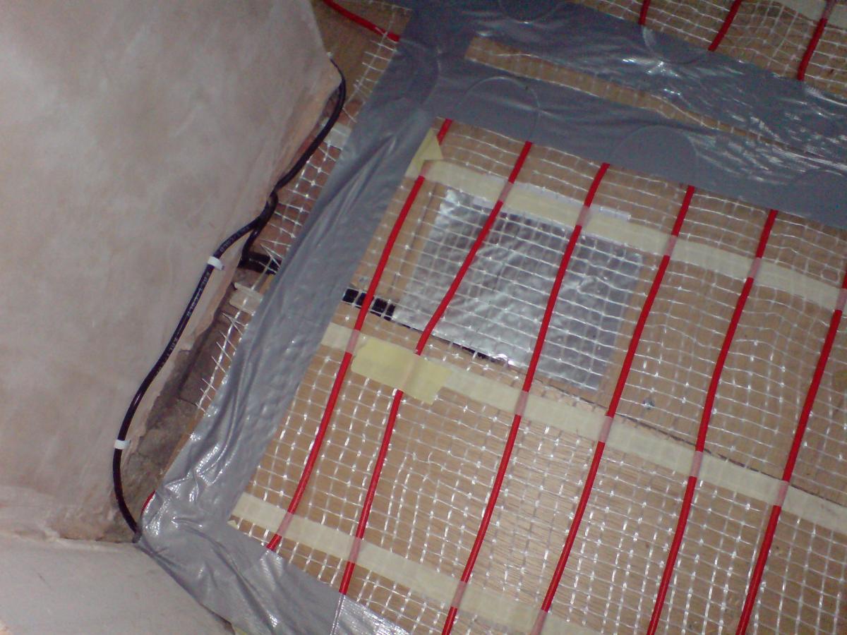

This is a pic of the incorrect way to do it.....and this was done by a sparky....lol lol lol...
