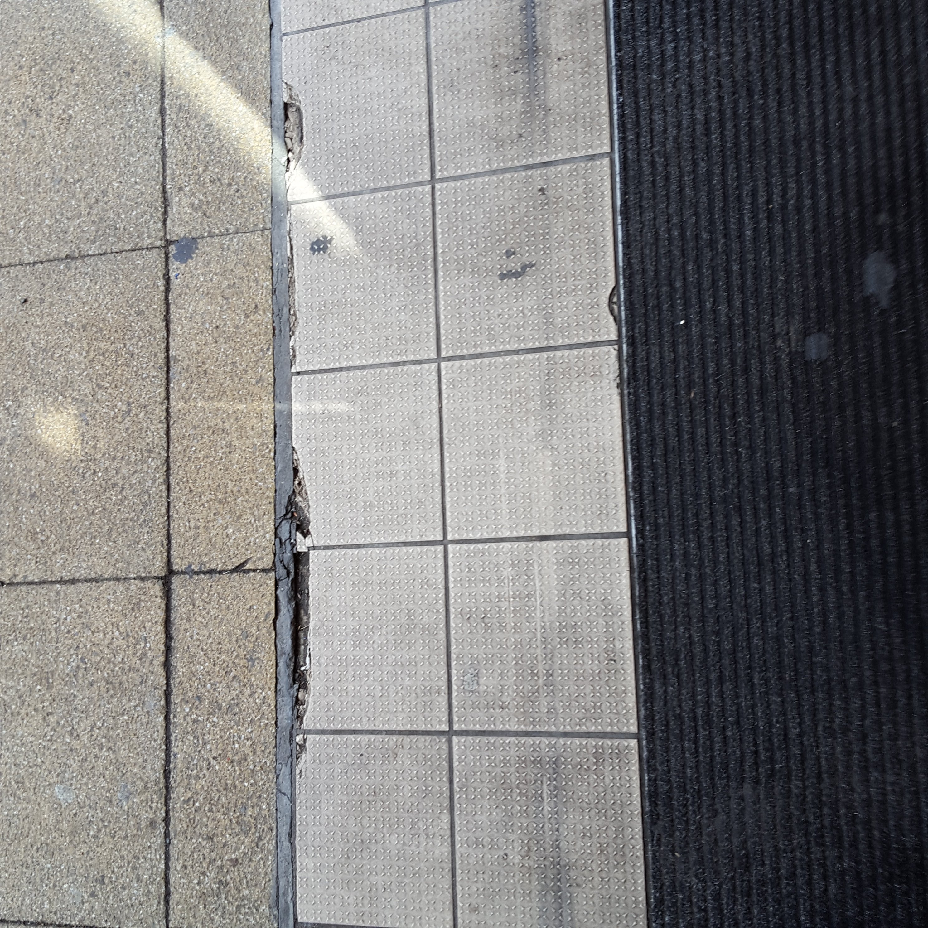

Im struggling to find some non slip commercial grade tiles for a small job
Theyre as the attached pic
Was told they were sourcing them but theyve dropped it on me
I didnt mesure them but im guessing 200 x 200 ?
Can any one suggest a stockist idealy in LEEDS
Thanks in advance

I fitted a very similar tile few weeks ago in the valeting bay at Bentley Manchester they got them form Italy I think from the manufacturer we had to lift a couple and get the name off the back of a tile
59
Dorset Wooliscroft from Original Style look fairly similar from the pic their Tetra Pattern on white or stone is the closest. If you go to their website you can search for"stockists" in your area,most of us "stockists" don't hold stock just samples and there can be a fairly hefty carriage charge but the closest thing on the market I can think of for you. Good luck!
