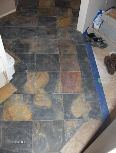

I have to do a spot of dry grinding to rid an entrance of some lippage tomorrow.
Me on the grinder and my wife on the vac.
The slate is cleft and gauged but is still very uneven in some places which was unavoidable due to the stone:mad2: .
Nothing but fun.
People think they are getting a product for cheap, but they do not realize that to make it look good in their application is going to take more than the basic labor charge to accomplish.
