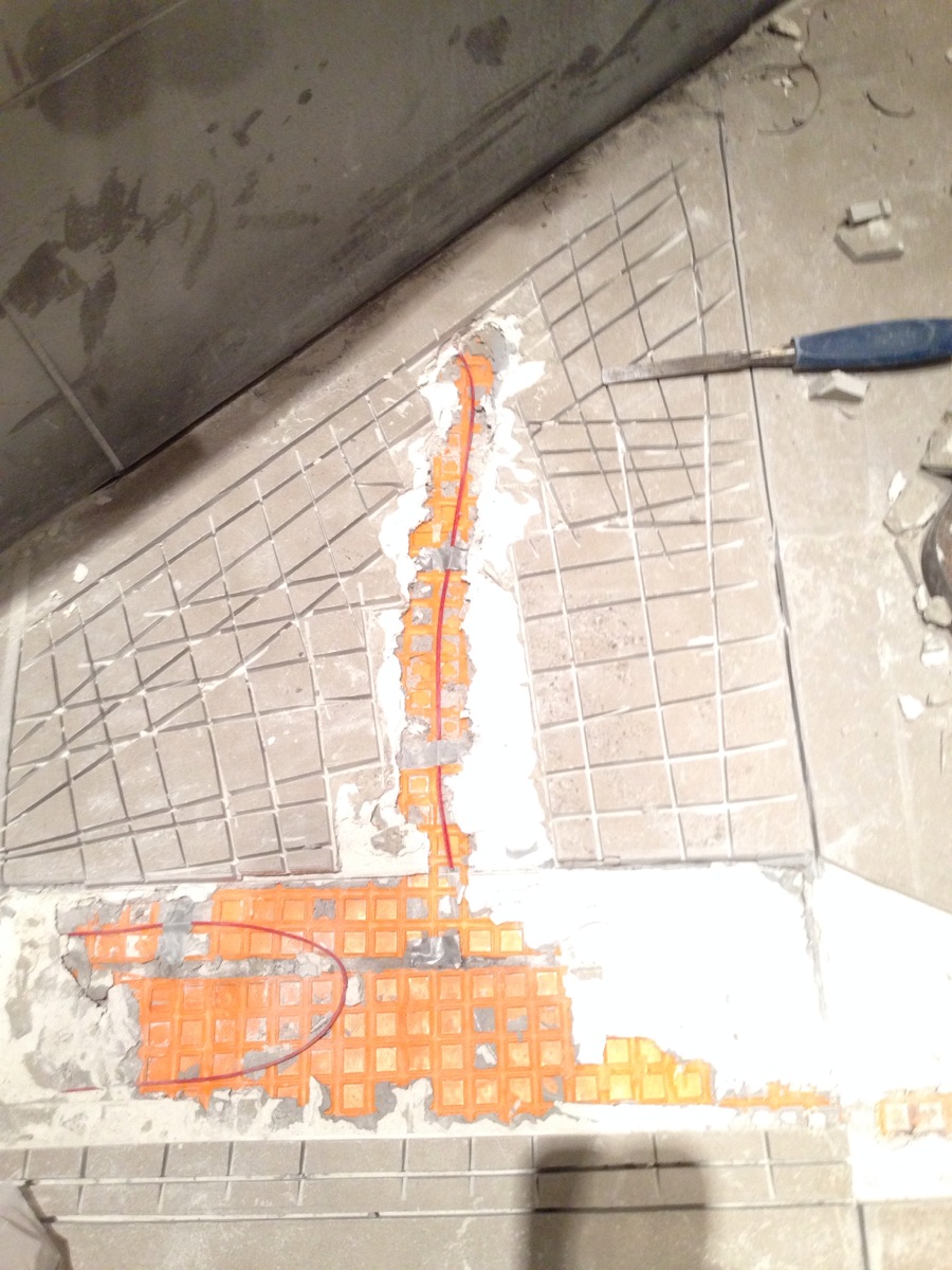

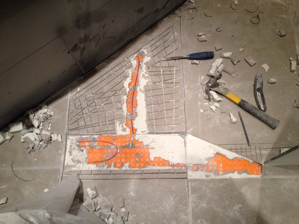

Anyway, had a similar problem in as much I had to expose an UFH cable.
I was asked to repair after someone damaged UFH.
I tackled it by running a grinder through the stone almost full depth and then with a small chisel chopped out the final bit.
Made more difficult by the fact that the UFH was on top of the Ditra and I had no idea where the cable was!
But taking it slowly it was more than possible.
