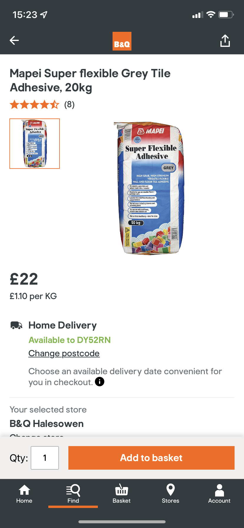

View attachment 125286I’m not sure if it is s1 or not. Which would you recommend then and with the porch it’s about lower then the hall now I fitted the nmp. So I was going to use it to level it up if I’m honest.

Hi there go to your local tile supplier and get Mapei s2 as that flexible as this is the best adhesive to use when there’s a lot of traffic on the tiles like the hallway .
When you say mapei s2 does it Ultralite S2 On the bag. Or is that a different one. I was hoping to start tiling tomorrow not everything is down and primed
