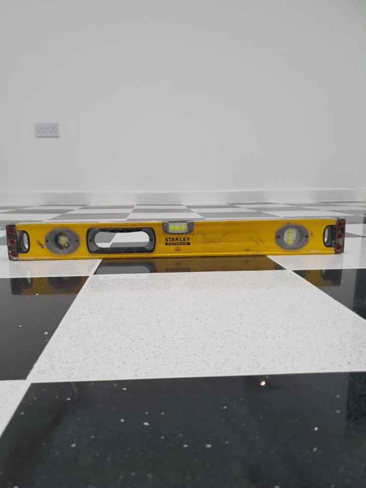

Aye it is bad. Yes he’s from here. Came highly recommend too which makes it even more puzzling as to why this job is such a mess.It must be bad if you can feel them under feet with shoes on do you have spare tiles that you can put together to see if they were different thickness was the tiler from Kilsyth
That’s grim. There certainly weren’t any warning signs of what was about to happen. Even showed him the bathrooms & spoke about doing them next once the kitchen was done.A think a no him without naming names the thing is a lot of people think he’s a good tiler but he has probly now done more bad jobs than good ones but still gets work
Yeah that will be getting done. Had him round the house & he offered us our £ back & left. Expecting it through the door the next day & nothing. Gave him a few days then contacted him & he said there will be no £ as that would be him admitting it’s a bad job. Hence why it’s now heading to the small claimsA lot of trades now have Facebook pages and my builder feed back could you not leave a message on that if he has one to warn others a no it’s not helping your case rite enough if it was my house a would be rite to his door for my money back 😡😡
Can only remember there was a Bal tub I took to the skip after the job was done.If these are Topps Starluxe then their spec for fixing these tiles is Bal PTB fibre plus with admix and they are a resin quartz. I'm doubting the admix was used here though.
I agree.I'm less Inclined to believing it was a size issue of the different coloured tiles. It changes per image to the black being higher and then the white being higher and this is also shown in the video clip. I'm not saying they are the exact same thickness to the mm but if it was the case it would consistently be one colour higher than the other all over surely?
Wow! That looks amazing. Not 100% sure what they are called, will have to check the invoice. That’s what I should have on my floor. Did you do this job?FYI if these were Topps Starluxe range you should have had zero issues with size differences. 37sqm done and all were equal thickness 👍

If you're using a solicitor show him the report and see if he's happy .Thanks for all the replies on this thread, it looks like my floor will be going to small claims court now. Who would be the best person to get a written report that would hold up in court? I have a report from a tiler already that I’m happy with, Ive looked into getting an expert witness report but that’s £1000 ish. Would it be worth contacting a tiler registered with The Tile Association as being a member of a body it may be stronger than a tilers report. Maybe even get another tilers report to back up the existing report?

Not planning on using a solicitor as I feel the photos & video evidence should be enough. Just would prefer this to be backed up by someone in the trade &/or part of a body/ association.If you're using a solicitor show him the report and see if he's happy .
Sometimes the court will appoint a independent professional witness
Court is a funny place , representing yourself in court can be looked upon as being disrespectful to the people that have studied law to be there and go against you .Not planning on using a solicitor as I feel the photos & video evidence should be enough. Just would prefer this to be backed up by someone in the trade &/or part of a body/ association.
Any idea how much a TTA report would cost? Would be happy to spend £ on this as you can add it to your claim ( just off phone to trading standards)Depends how much you want to spend, the TTA report will stand up in court.
Also even if you win in the small claims court , doesn't mean you’ll get anything back , as in a lump sum. The tiler might not have the ability to pay in full and could just pay , say a £10 a month.
That’s a good suggestion! Thank you I’ll definitely get a copy somewhere. Anyone on here have access to it? Send me a copy (will pay £) 🙂Small claims is meant to be done without a solicitor. It won't go against you be on your own provided you put your case properly. I suggest getting a copy of the british standard to show the work is not acceptable. Does anyone know where it can be got from, or even the previous version for reference?
