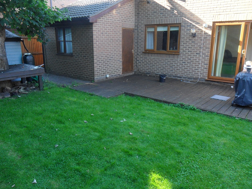

Here's the two best pictures i've got:
Decked area is 8m x 3m. I cannot risk harming the tree as it's listed so digging down to put a solid base in i think (given the size of the tree) is not an option. But if i could raise a decked area i'd only have small areas to dig down to put supporting posts in. I can make the framework solid, and IF overlayed with marine play 18mm would be deflection free.

haahahhahahahaaa.....just seen the photos..........dig up what you need to........dont get too close to the tree (as in 1m radius from centre of tree........)
dig up a minimum of 400mm........ add 200mm of compressed hardcore.....and then a 200mm reinforced (with steel mesh) concrete.......after that do as you will.......
if you can kill that tree.......i will tile for free....forever!!!!!.........(its an extremely established tree!)....IMO.......
