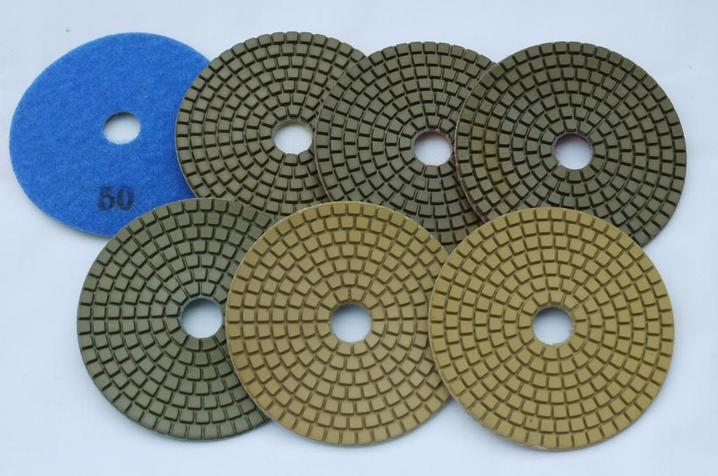

Second new product of the week.
Diamond polishing pads specifically formulated for quartz and other hard man made engineered stone. Wet use only.
Quartz is not as easy to polish as marble or granite and as such it's had to have it's own pads produced especially for it.
It solves that trim problem if you've got a quartz wall tile job as this pad set will enable you to polish up the edge to the same spec as the manufacturer.
Wet only though, so you're going to have to have a polishing machine that's water fed or can cope with getting splashed.

What products are you polishing mostly David?
travs/marbles etc from honed finish through to polished on exposed edges etc.. or finishing bullnosed edges.. i got some from hongkong about 3 yr back but they tend to leave residue on the higher grits..
So looking at better face quality.
Honestly, you're better off going with Silicon carbide pads for both of those materials. There really is little value in diamond pads for sedimentary stones and even some of the softer metamorphic ones such as lighter marbles.
One of the forum members here has a set of our dry's which he's used extensively polishing crema marfil 20mm bullnoses, but they took some time to bed in and suffered resin bleed for a while. Now bedded they work beautifully.
So unless you're doing 100's of linear M's of polishing a week, Silicon carbide is the way to go. That market is very well catered for and not something we've found worth competing in.
My regular mason customers still used Silicon carbide pads on marble by default.
