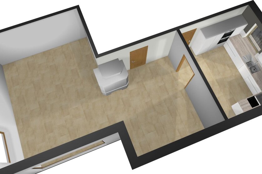

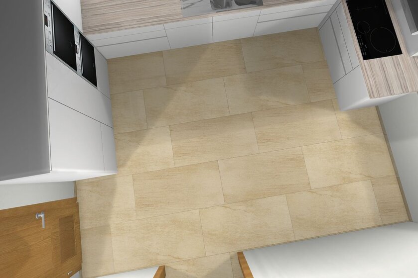

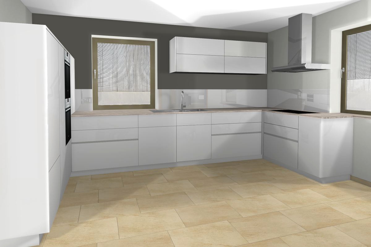

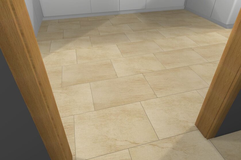

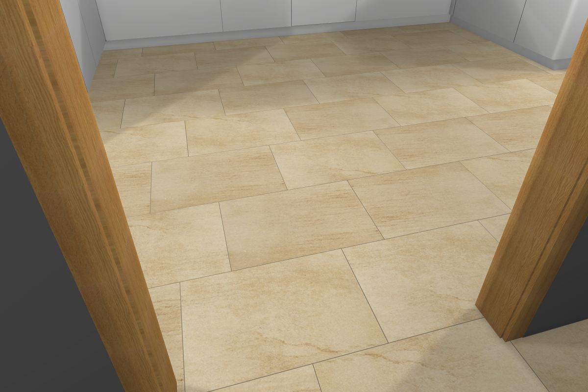

coming up projekt is a renovation of a kitchen. i got the new kitchen plan and countertop texture and build it in my cad. then i show the customer the diffrent formats of the tile they choose.
its a lea ceramice techno quarz. later the customer want to tile the dining and living room so i make a grafik for the whole rooms.
i prefer the mixture of 120x60, 60x60 and 60x40. what do you think? the tile is available in a lot of formats but not in 90x45 or 80x40. thats difficult because i think it could be the right one.

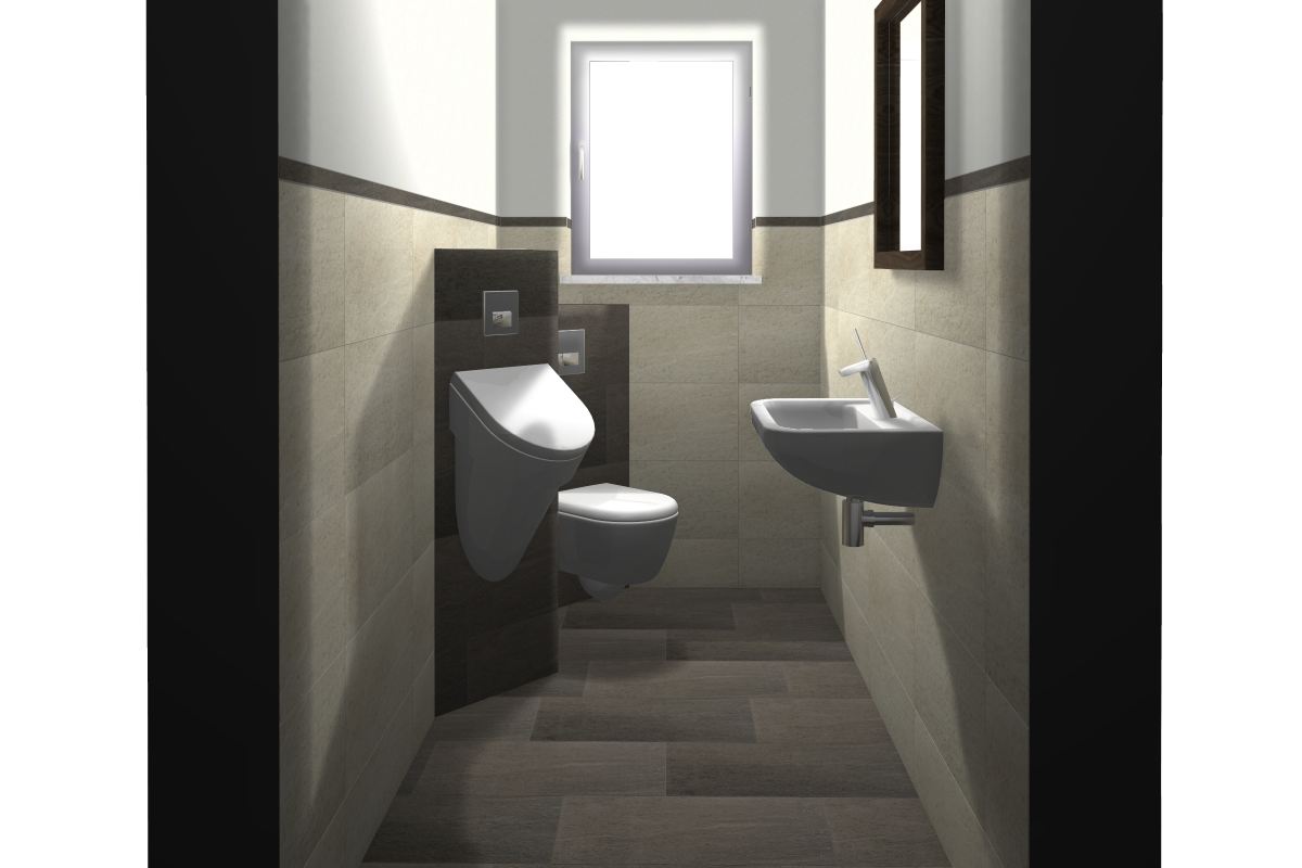

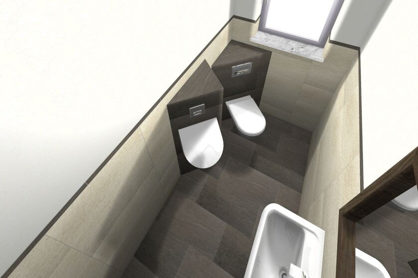

next one is a renovation of a toilet room. i offer the customer a reduced tiling with 40x80cm tiles and flush rendering. later i will try a 75x75cm. it could fit also very good in this room.
i think the customer likes concrete optik so i try the atlas concorde evolve concrete or the new "ever".
today i got a yes for the toilet job above.
next plannings are for a new built standard house with reduced price template.

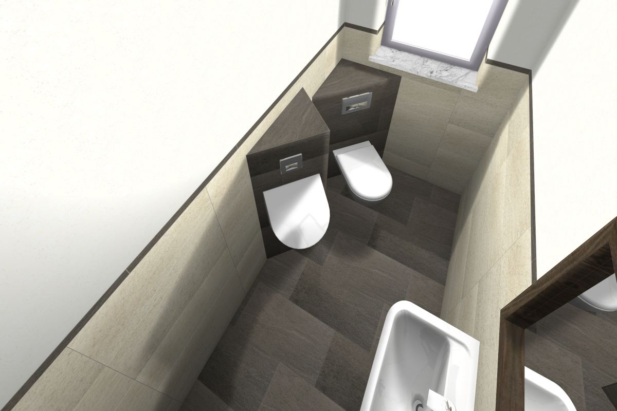

heres the first classic version for the toilet:

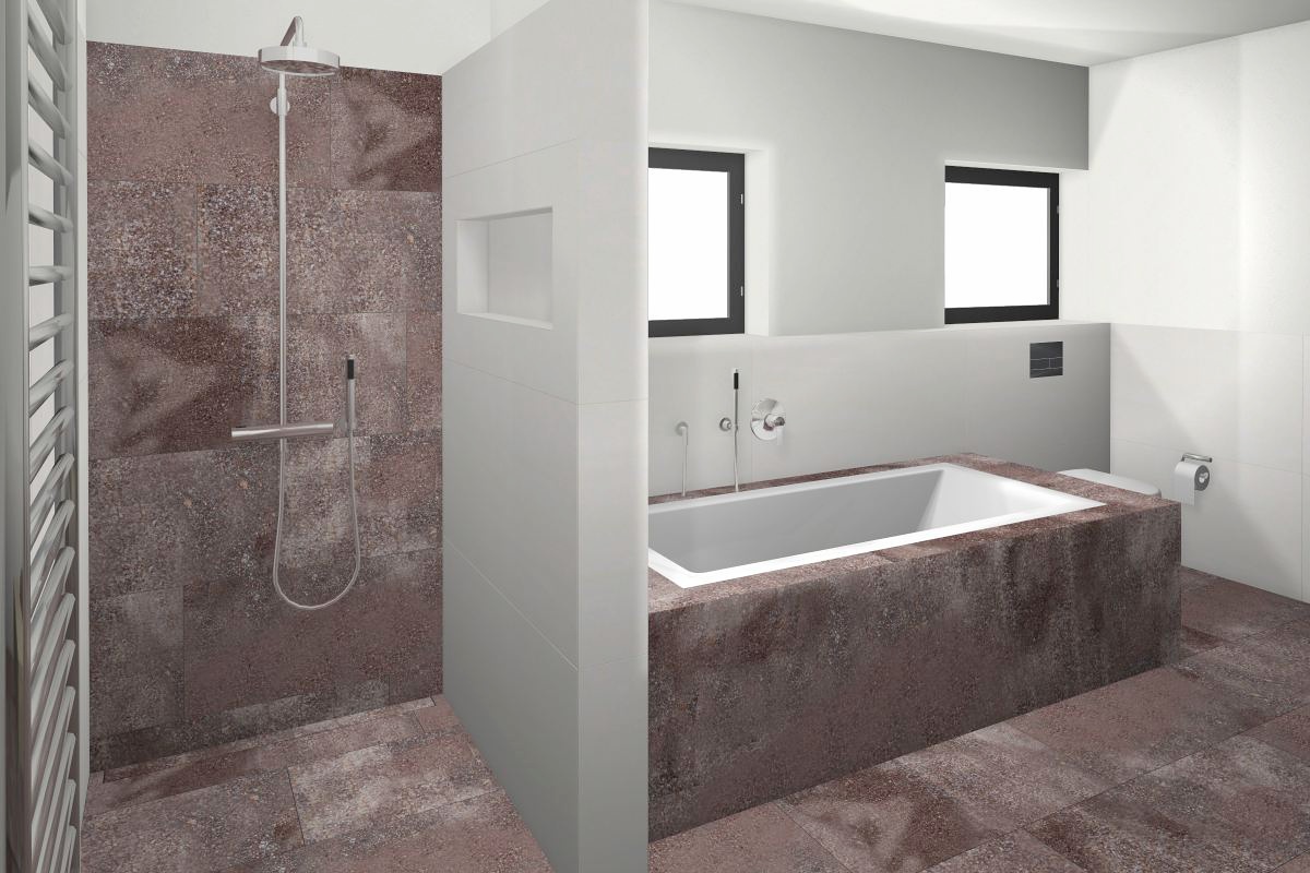

next bathroom is a renovation with complete new layout. i suggest rittner porphyr 40cm diffrent wides and white porcelain stoneware 120/60.

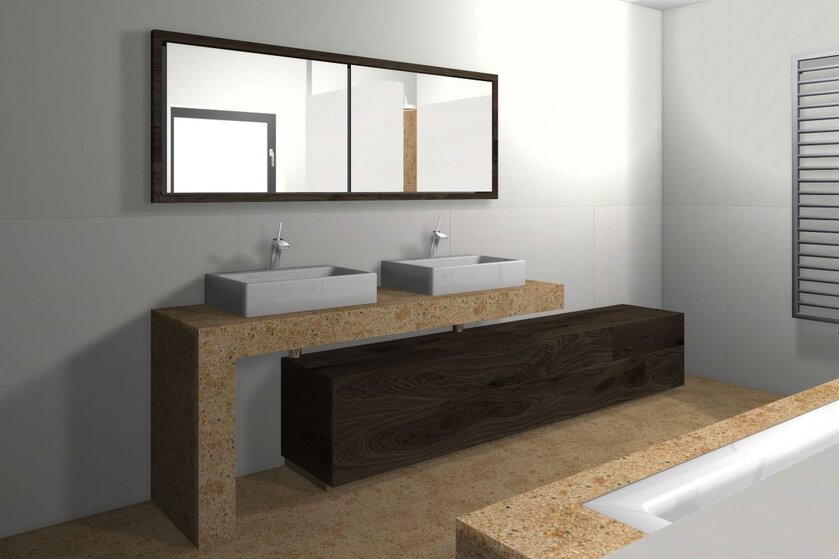

so today i redesign the bathroom above again and try terlaner porphyr and a bright oak in it.
