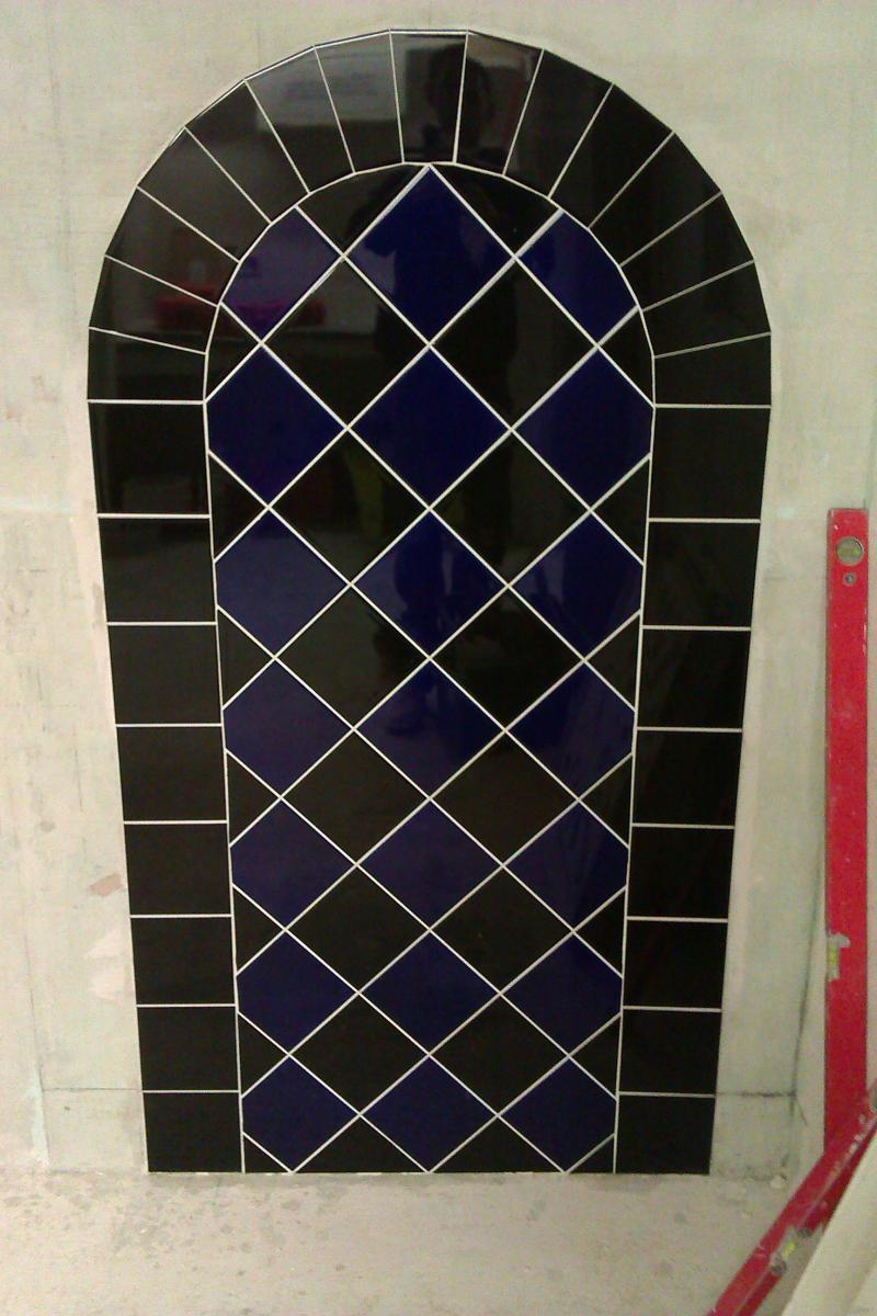

Currently half way through my 10 week full time Tiling course with Able Skills in Dartford working towards a complete career change and a Level 3 NVQ. Really enjoying it so far and starting to be fairly pleased with my work. I still haven't mastered sharpening my pencil with a stanley blade though! I've attached pics of some of my work so far so please go easy on me!

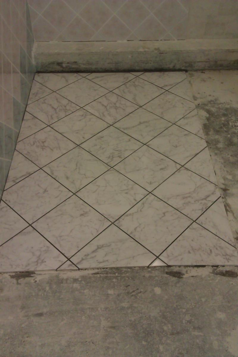

Some pointers.. pic 3 : centering windows looks more uniform but depends on other lay out return walls.. and pic 6 : what happened at the bottom few joints in the corners..?
Hi David, thanks for your help. It was a while ago but with pic 3 as I recall I had to come off centre to avoid a sliver of a cut. With pic 6 I'm afraid my lack of experience worked against me. The walls weren't plumb and although everything worked nicely at the top, I didn't know how to save the pattern at the bottom. This was on Thursday and I'm discussing with my instructor on Monday but any advice would be well received. Wrapping round diamonds is certainly a bugbear at the moment!
Thanks.
Thanks.
This is where when doing that sort of layout, the walls must be plumb.. or set out so the wrap is not on a full tile.. but get a plumb wall is the best method..
