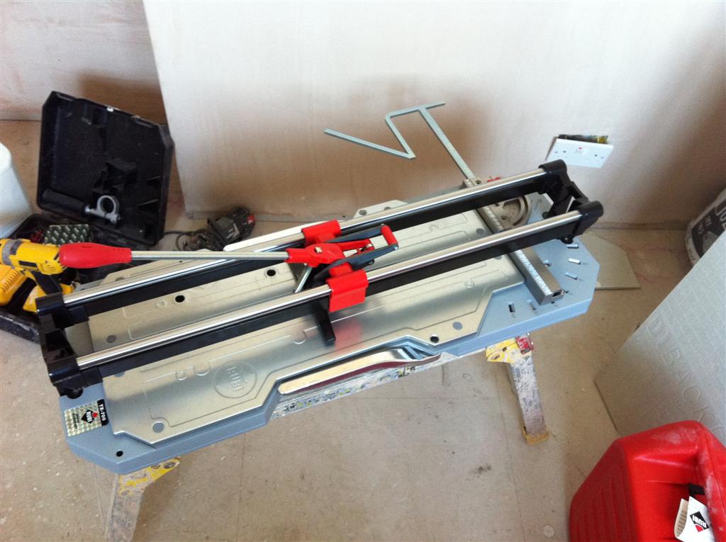

I have had the pleasure of Using the Newer Model of the Rubi TX700..
Firstly i have to say that this newer model is very well made and the build quality is far far superior to the older TX700 and 700n models.
The sprung loaded bed is a great addition over the older foam loaded bed and the new thicker and stronger flip out tile supports are much better.
It is just totally a much better build altogether ..

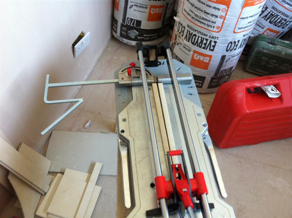

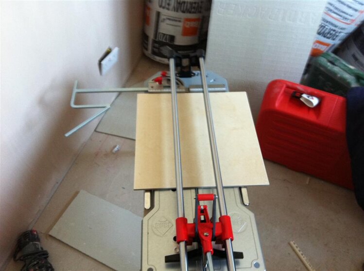

The first tiles were 450x450 glazed vitrified floor tiles.
Straight half cut
40mm slither spilt in half

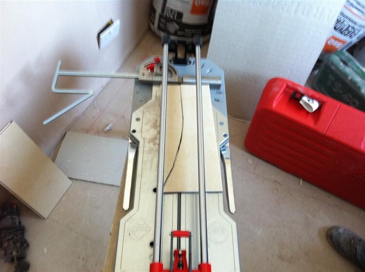

Curved cut ready for final scribe to shower tray
450 x450 glazed vitrified floor tiles

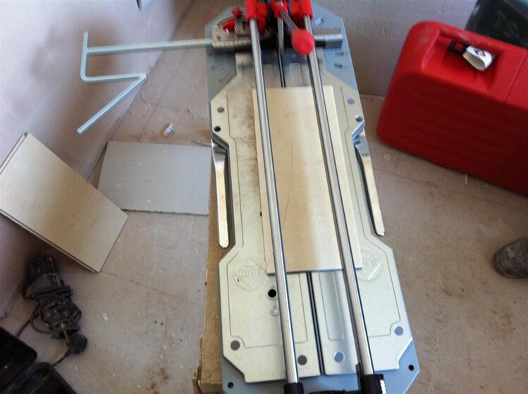

Marked curved cut
As you can see i did a couple straight cuts / a curved cut and then cut a 40mm slither in half no probs

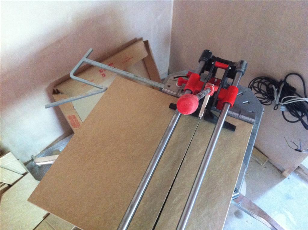

The next job was the dreaded very hard Vilroy boch grade 5 porcelnato floor tiles.. i used this for walls and floors to 4 bathrooms.
These tiles have a textured surface and a heavy grid back to them, so some cutters do struggle to get a clean cut and the biscuit is very hard... again no probs for the TX700 and used the 10mm wheel on these..
450x450 Vilroy boch tiles
60mm slither spilt in half no probs.
