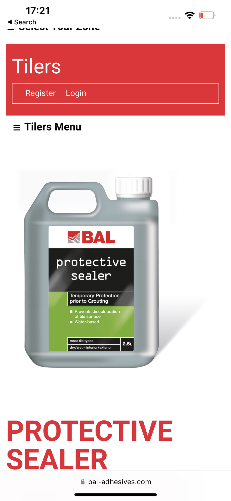

You can buy a pre sealer from tops tile that washes off when you grout I had to do the same thing the other day as the feature tile had a lot of crevices, if the tiles are glazed there shouldn’t be any problems if they are rough to touch a pre sealant will probably be your best bet, only natural stones need to be sealed as they are highly porous.
Fitting wise it’s better to tile that wall last as cutting into them will leave a gap in the corners, fitting them after if cut tight to the other walls won’t give you a gap down the edges.
With any tile like those you will have jagged mastic in the corners, try colour match so it’s less noticeable
Hope I’ve helped good luck !
This stuff is water based so will wash off when grouting if there is any grout residue left on the surface it sticks to the temporary sealer rather than the tile, your tiles look glazed personally I wouldn’t have a problem just grouting it but this stuff does help with washing off.
