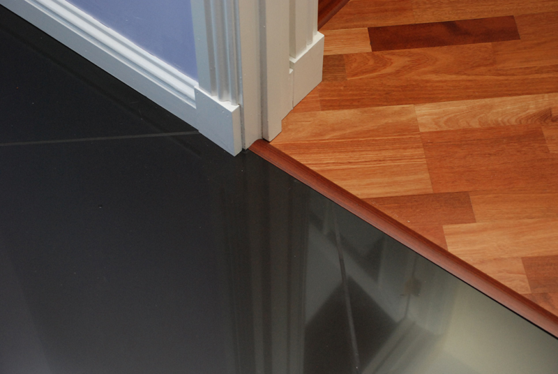

I used one of the types CJ refers to. I fitted it to my bathroom tile-carpet transition and also kitchen tile to wood floor as shown here.
Tiles were about 20mm above concrete floor and height difference to wood floor about 8mm. I screwed a piece of wood to the floor to take up excess depth then attached fixing strip to it.
