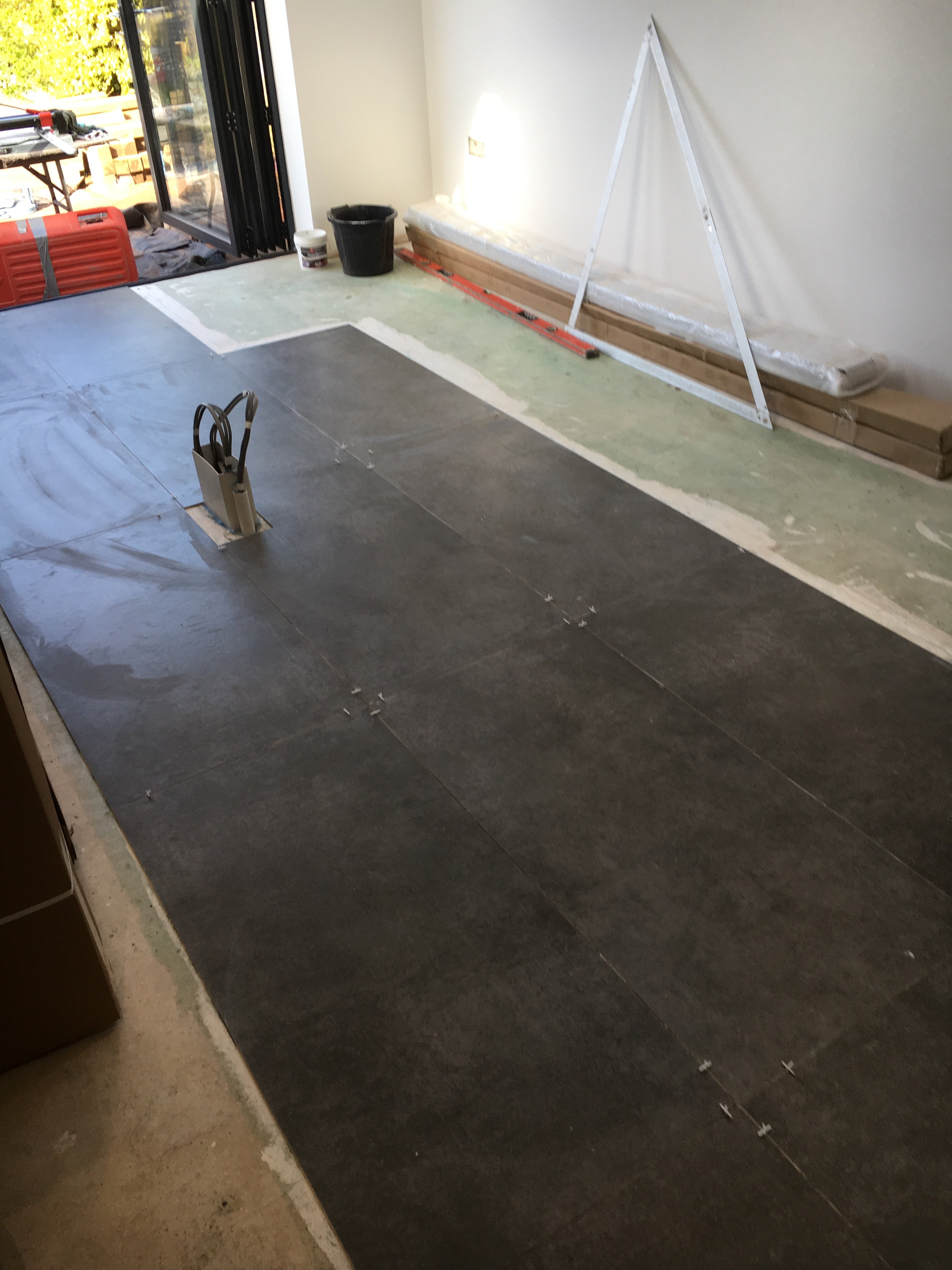

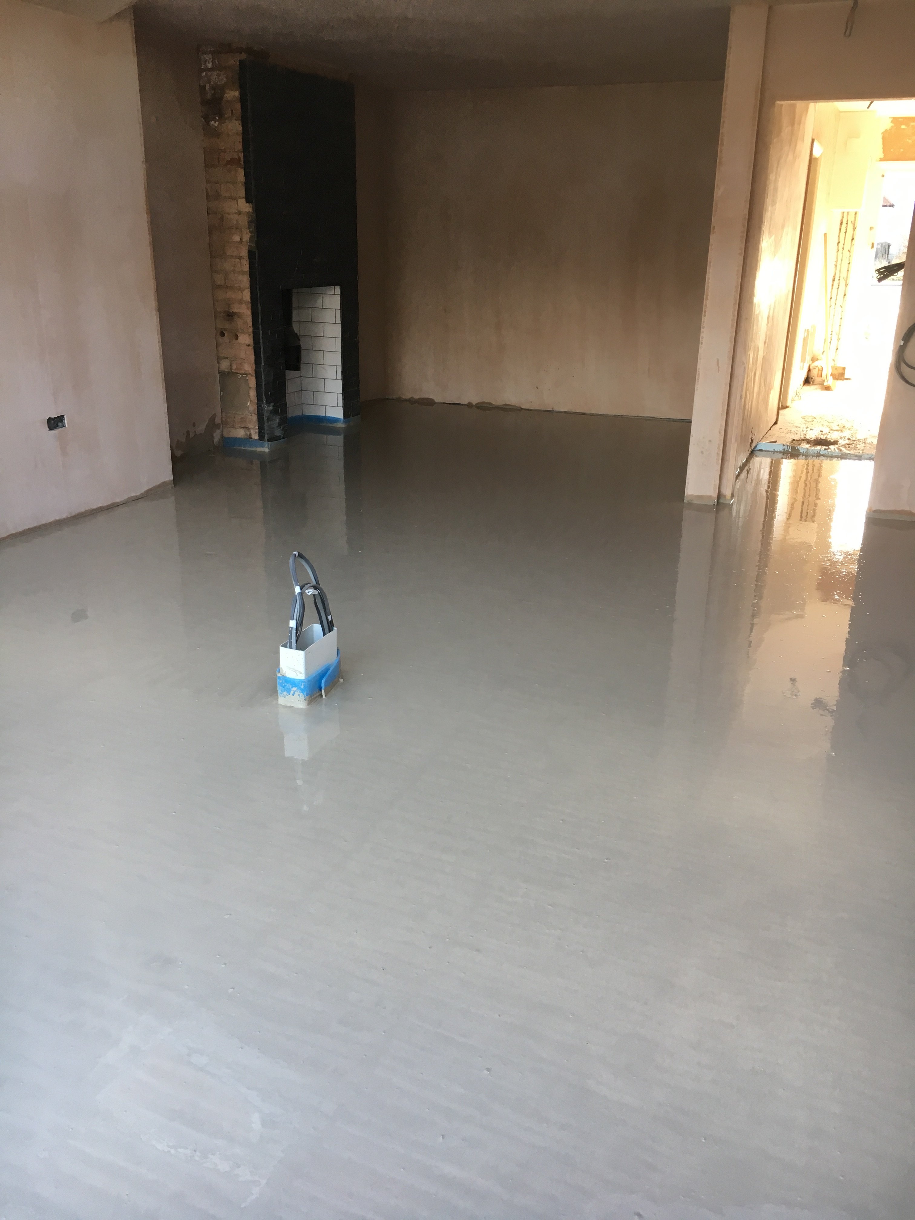

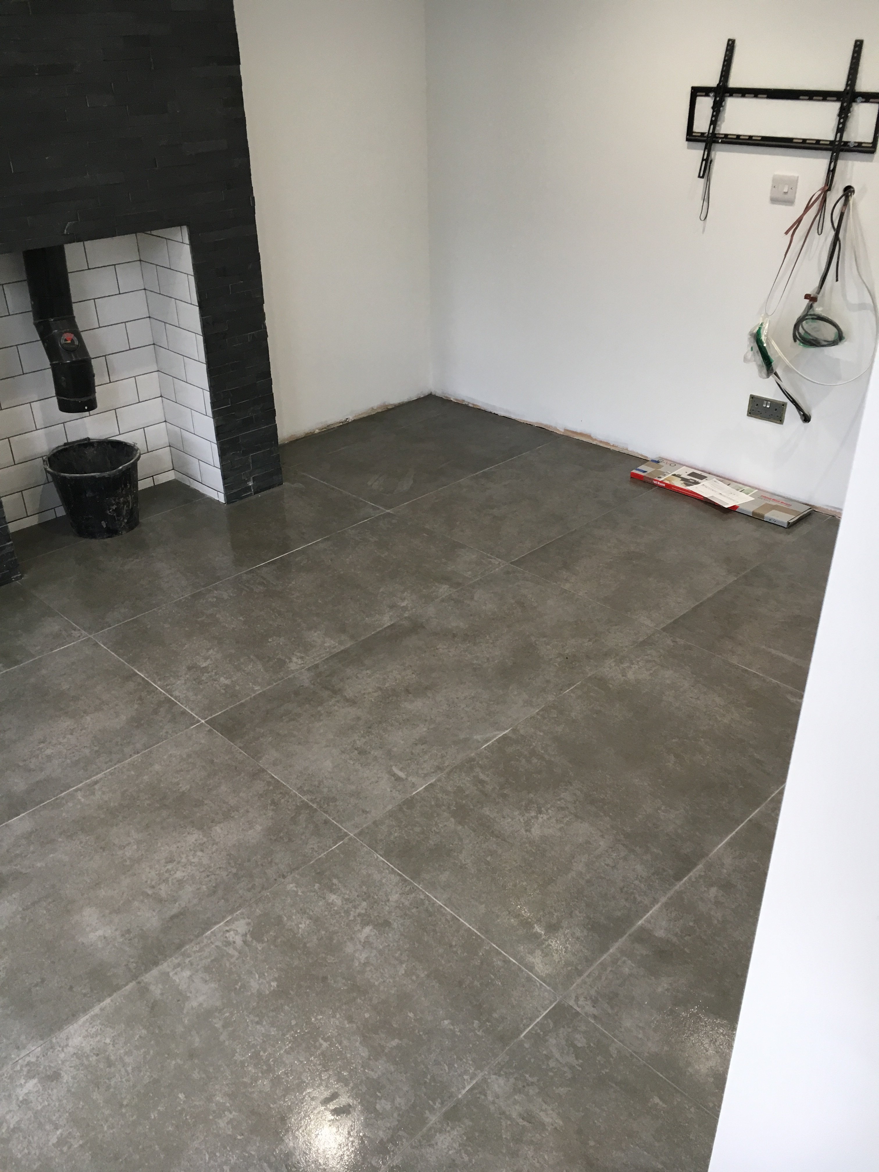

Dragged the wife down to London to see Ray as I was set on using Porcel-Thin for our new extension. Could not be happier with the results. Went for a 1200x600 concrete look tile which went down a treat. Laid onto a Gyvlon screed which helped, along with no particularly awkward cuts but still a very satisfying job!

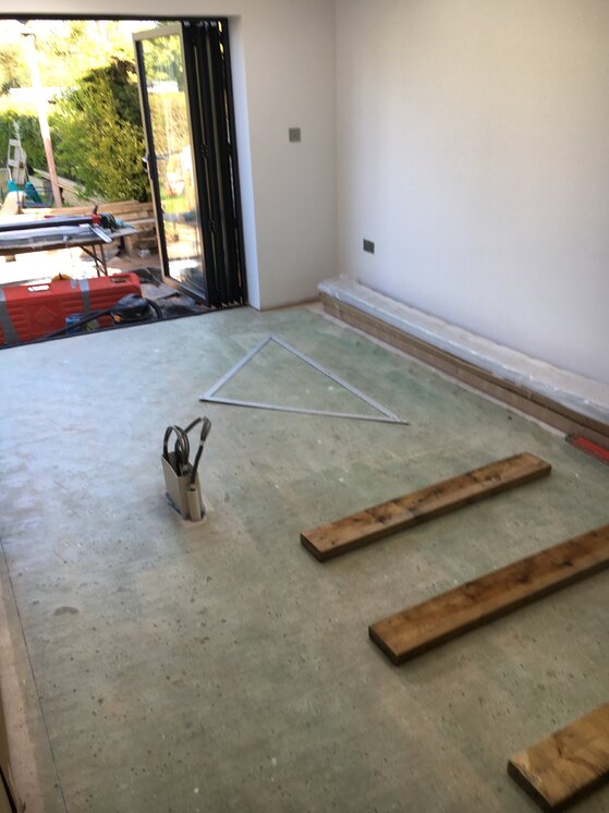

Ufh and dehumidifier on after 7 days.
28 Days after screed was poured.
Not ideal having no where else to store the new kitchen!
