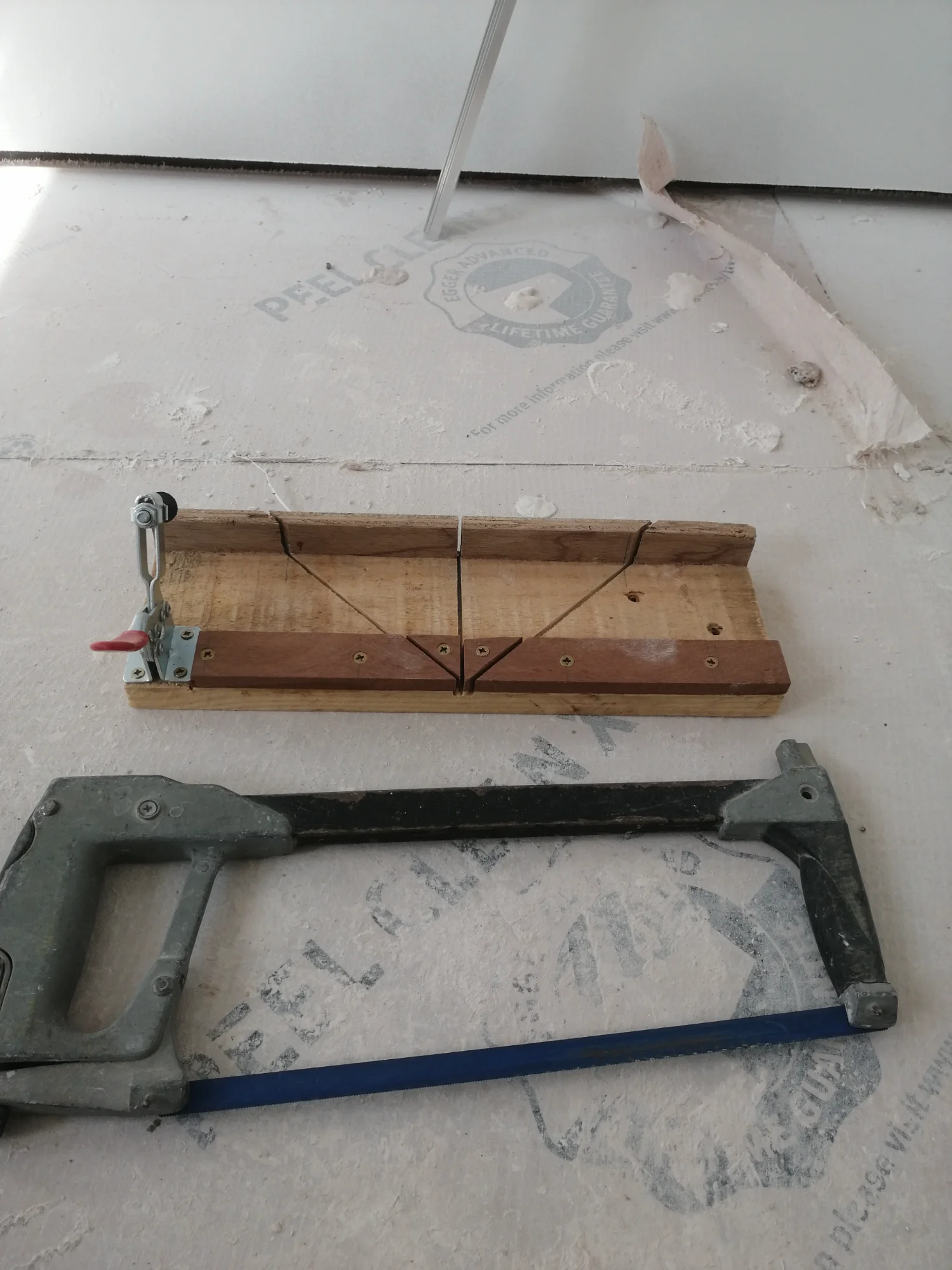

Hi all , haven't been here in a while.
Made a small mitre box jig on wknd specifically for metal trim as using a lot of it on sites at the mo.
Pretty basic, but it stops the trim moving around while cutting with hacksaw. Works well actually, tried it this morning. Only some scrap wood , glue , screws and a toggle clamp. Was going to add clamp at other end but it doesn't need it. Front edge cld do with being 5mm higher I reckon but kept it low so I cld put my hand on easily.
Anyway was just an idea if u get up with trim moving around .
