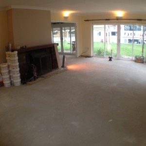

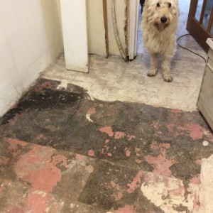

The first problem encountered was that there was a layer of Magnesite below the Parquay, so that had to be removed. (Horrible nasty stuff that has been banned now!) Magnesite: Key facts you ought to know
Once that was removed it became evident that the slab had been damaged also.
It was agreed by all that the floor was not repairable in this condition.

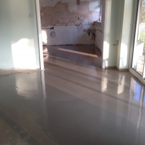

Firstly the slab was repaired locally, then 3 layers of synthaproof were added followed by a new 100mm screed.
This would then be primed covered with Ditra Matting, correctly sealed and jointed and taken up the wall 100mm where possibly to form a waterproof layer and skirting detail.

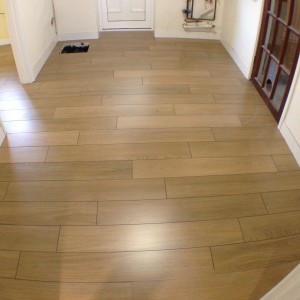

Then tiled with the addition of a skirting tile and all transitions sealed and siliconed.
The Ditra was layer to a spec from Schluter including the use of their lovely super sticky adhesives Kerdi-Coll and Kerdi-Fix!
The whole floor was laid to falls toward an opening in the utility floor, where a submersible pump was fitted with an automatic cut in switch, for use in the event of a flood!
