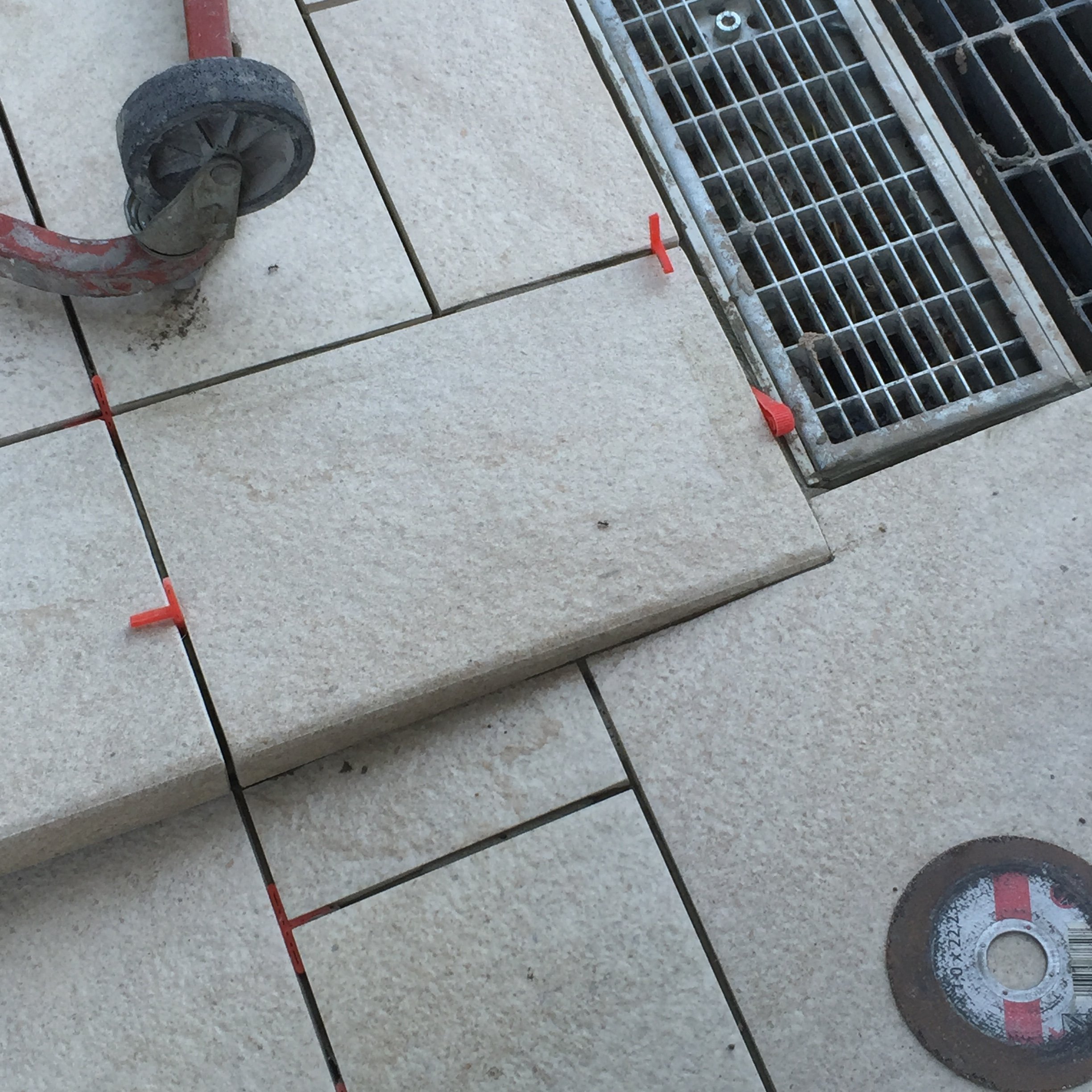

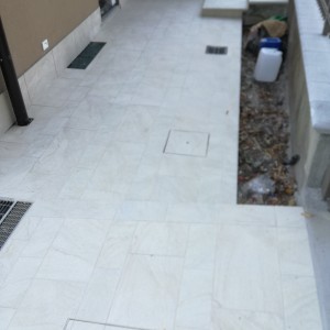

110 square meters outdoor, background, sand and cement meta, meta old tiles.
2 formats, 30x60 and 15x30 porcelain SUPERGRES.
2 layers, Mapelastic foundament, (anti rising moisture).
adhesive Mapei Keraflex Maxi. perimeter edge, with aluminum schluter L.
JOTM fact, to keep company with marc, work is not comparable to the work of 3_fall.
