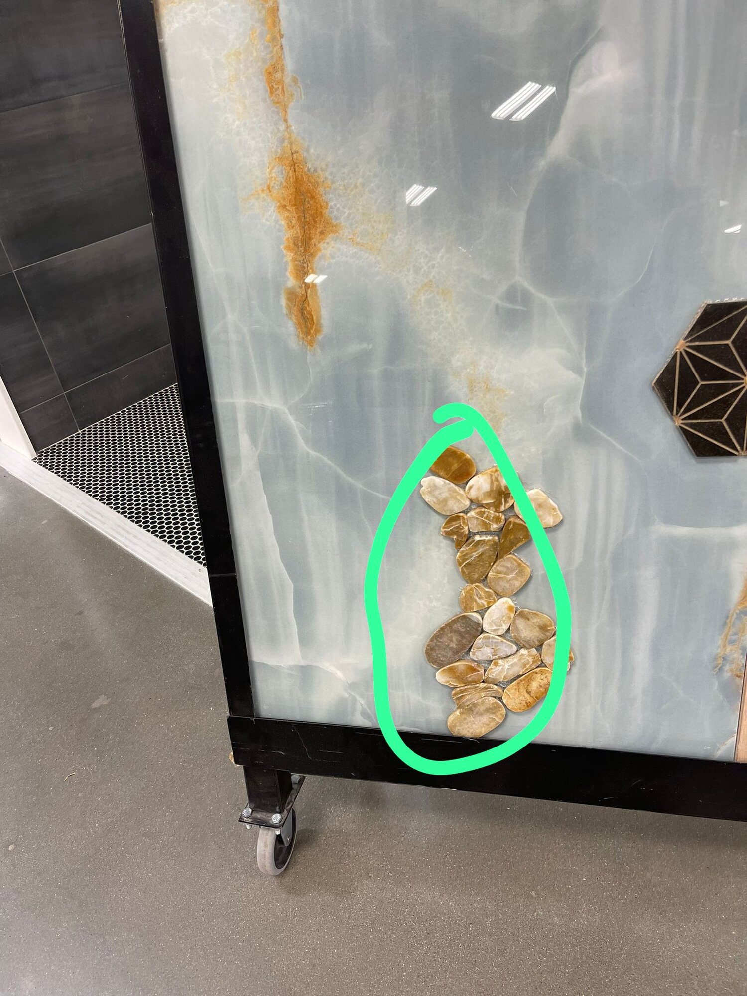

Please help me find this shower pane tile.
