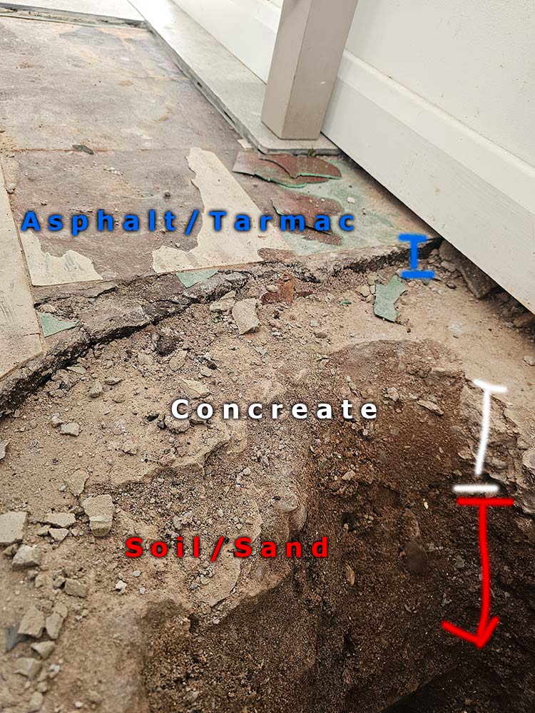

I had a small leak in the main water line before the stop tap in my 1950s house. The copper pipe had worn away over the past 70 years, causing a small crack in the copper.
A plumber/builder fixed the leak by digging a one-foot by one-foot hole in the corner of the property where the main water enters the kitchen. The area has been left to dry out for the past week or two, waiting for the plumber/builder to return and fill the hole.
During the repair, we discovered that the house, like many built in the 1950s, has a concrete subfloor with a 20mm asphalt layer acting as a damp-proof membrane (DPM). Considering the leak, the concrete is surprisingly dry. We believe the open service pipe below the concrete allowed the water to drain away.
The plumber/builder will be back soon to fill the hole, leaving a concrete surface flush with the existing floor.
Question: Repairing the Damp-Proof Membrane and Re-Tiling
My concern is how to address the asphalt layer, which previously served as the damp course before tiling. Its only 1-2ft square

It looks like that floor was designed for vinyl flooring. The green tile is vinyl. Get a dehumidifier to dry up the soil then you can proceed with the concrete and tile. Ardex products are good. As far as the bitumen blackjack goes, make sure Ardex NA is compatible with bitumen. Send some pictures with the loose tiles area. Good luck!
