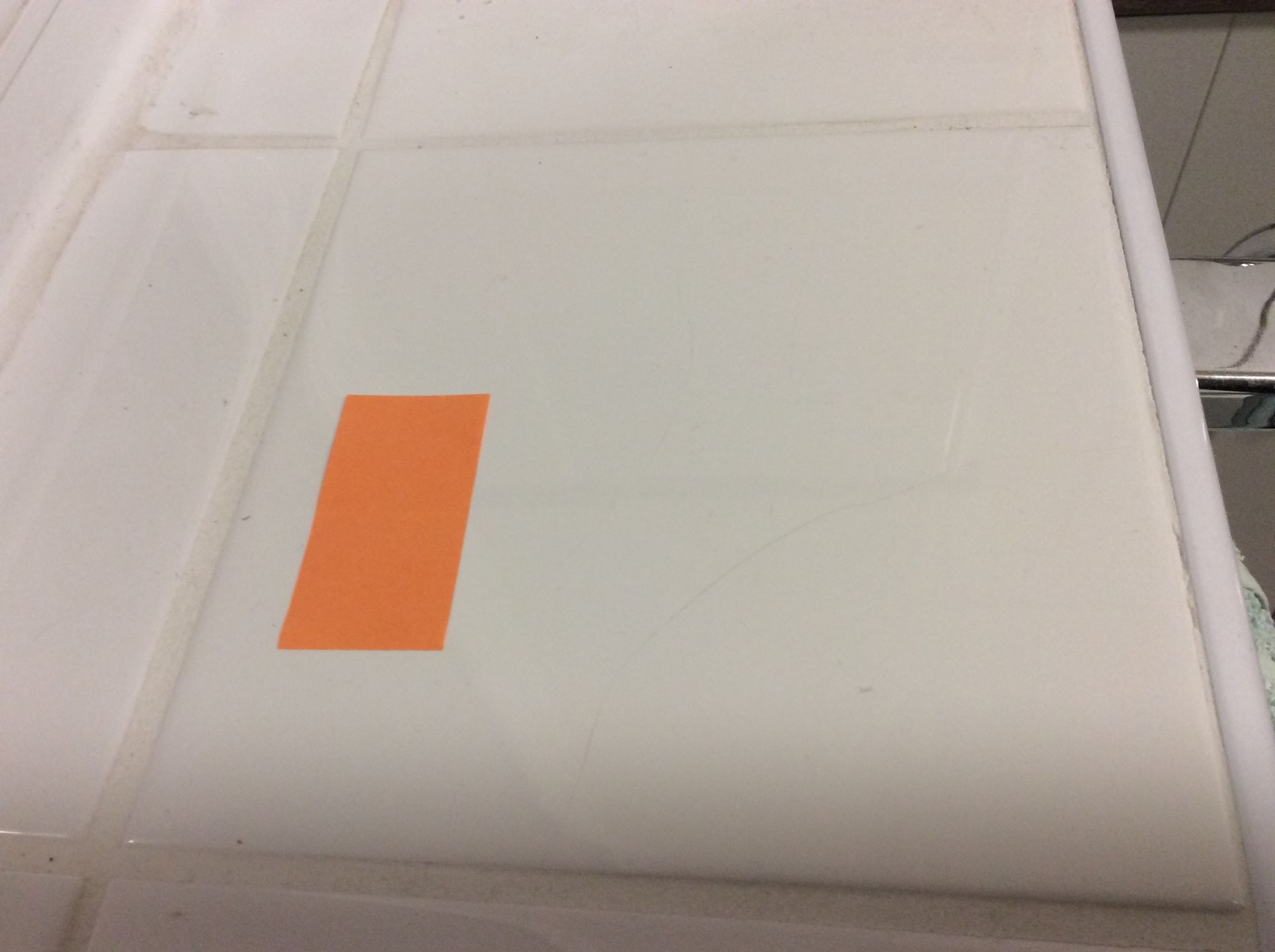

The day before the installer came back to fix this, we noticed that some of the tiles on the window sill had started to crack with hairline cracks. We found lots more on the walls and others have gone over the next 6 weeks. I'm attaching some photos. We also found one in the box that had never been installed that also seemed to have one of these cracks although it was almost impossible to see.

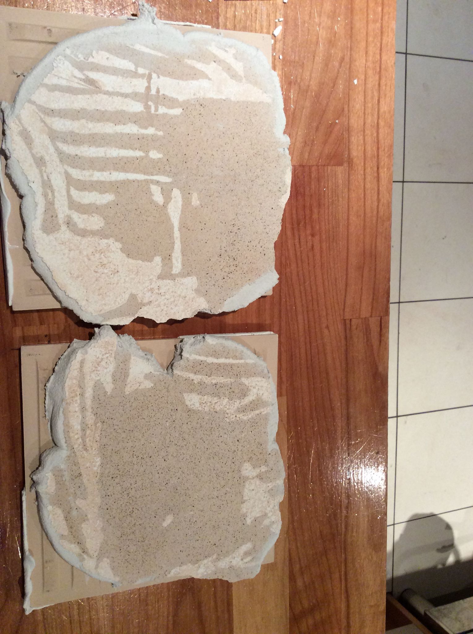

I should also add that once the grout was raked out (installer was trying to replace it but stopped when the extra cracking was noticed), the wall tiles became very loose. One just fell off the wall one night and you can take others off simply by pulling them.

They've now issued their report, which blames the installation. They say that the problem is that the tiles were dot and dab fitted and the tiles on the wall are deboning. Also that the adhesive used was too thick as it was 10 mm. They say that the one from the box is a scratch and not a crack.
