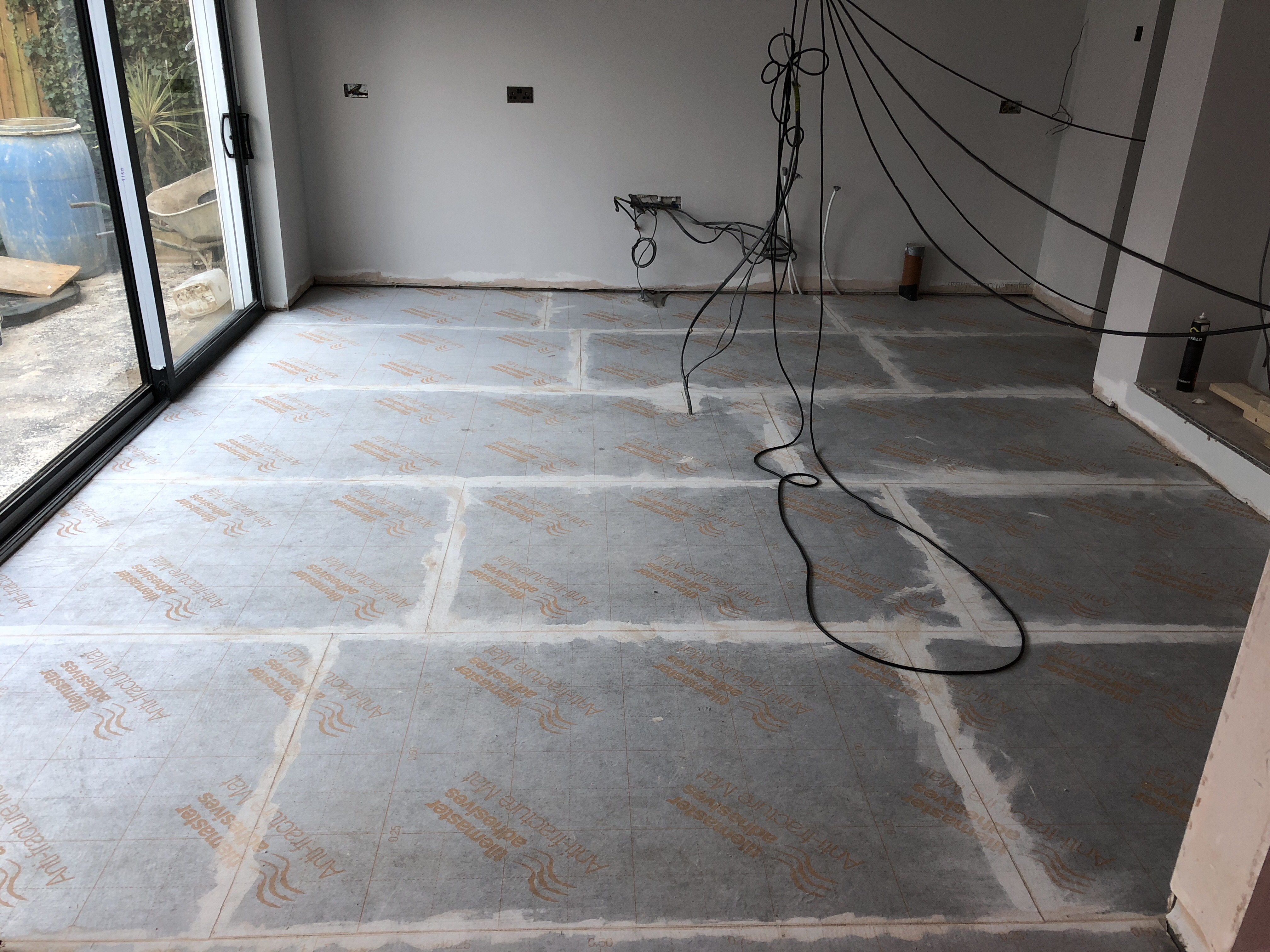

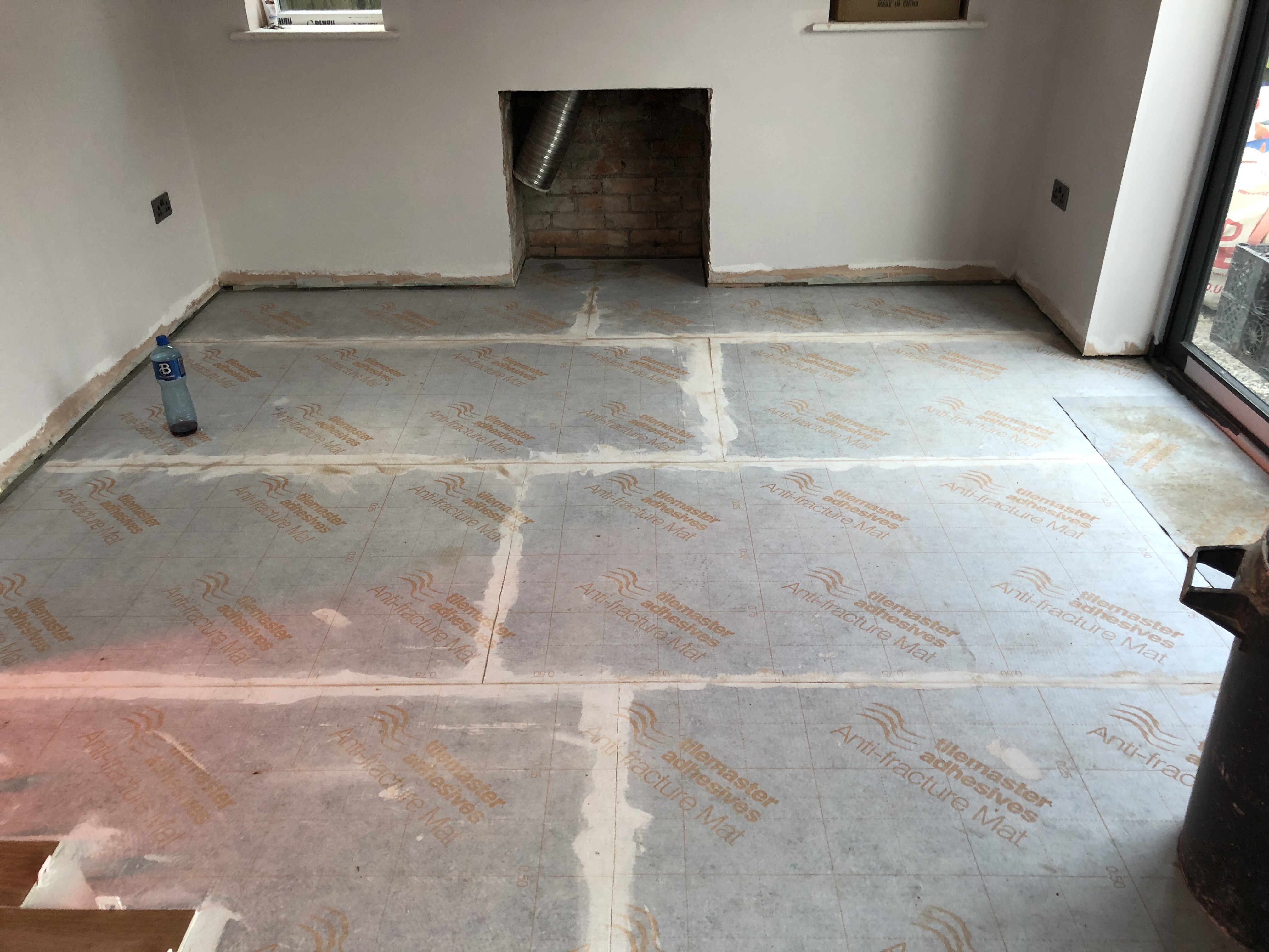

Written quote for laying tiles buDid you have a written quotation agreed before they started? If not, it sounds like you need a clear and honest discussion before they carry on - for the sakes of everyone involved.
I can't comment on prices in the open forum, but it does look like they've made a good job of the prep, which usually bodes well for the end result.
I would allow 2 days I work on about 5metres an hour for matting although not had much experience with tilemaster .Without knowing exactly what was done, it's not fair to say a definite no. But assuming it was straightforward, I'd expect to install that amount of mat, on my own, in two days max.
But we've all turned up to jobs where everything needs moving, other trades leave muck all over the floor, water wasn't available, etc etc...
What are they saying to justify 5 days?
It's not the easiest to install. In fact it's pretty horrible, but assuming it's prepared well, comb and roll... Its four 20m rolls. I see they've used sheets which would be slower in any case...Maybe im slow compared to
I was wondering about that not being familiar with tm antifracture was thinking have they cut into short lengths for some reason .It's not the easiest to install. In fact it's pretty horrible, but assuming it's prepared well, comb and roll... Its four 20m rolls. I see they've used sheets which would be slower in any case...
What do you mean working on prep .Hi thanks for all your responses.
House and floor was completely clear, no other trades and no other reasons for delay.
Thanks for the info, seems most of you are all in line with 2 days.
It was over 3 days, with 1 tiler working on prep for all 3 days and the other for 2 days (5 in total).
