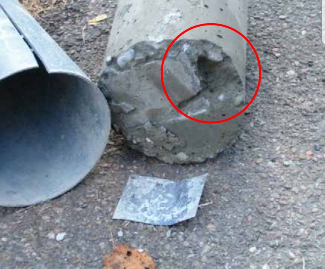

Does this mean you can you could explain the chemical reaction between Portland cement and aluminium?

From the manual.
Concrete shall not come in contact with any
aluminum during conveying and placing
operations.
Aluminum Frames in Masonry Walls - http://www.cement.org/learn/materials-applications/masonry/masonry-construction/aluminum-frames-in-masonry-walls
