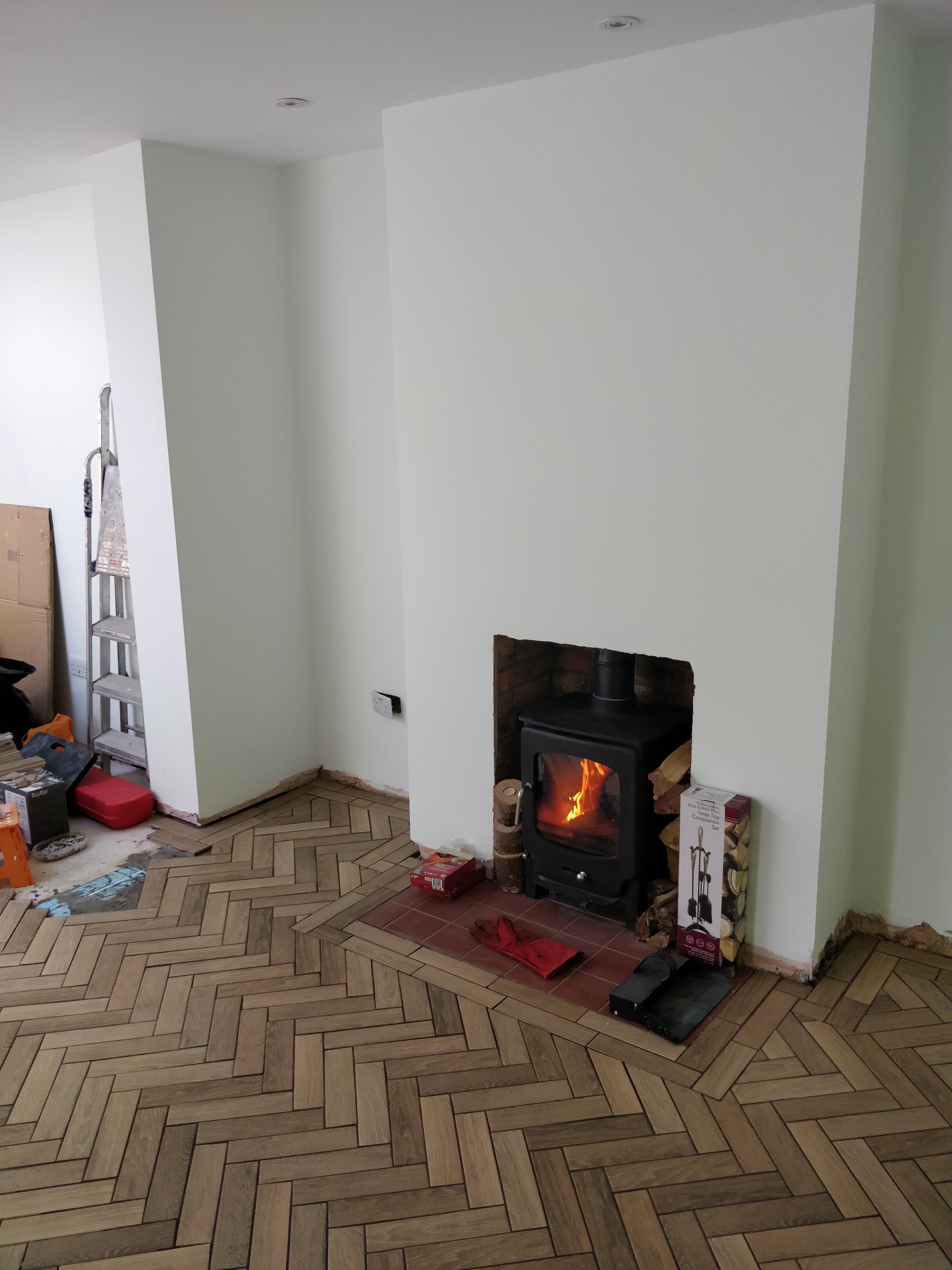

I'm doing the same thing as I have installed the wet underfloor heating and like Nick suggested have put a 5kw stove.
The stove in my opinion is more of a feature than to heat the room up. For me you got to almost sit on the stove to get hot.
The underfloor heating is there to heat the room.
My 5kW stove is the only source of heating I have in my hallway and kitchen/diner (about 30sqm in total), it's more than adequate. If lit all day it heats the upstairs too.
