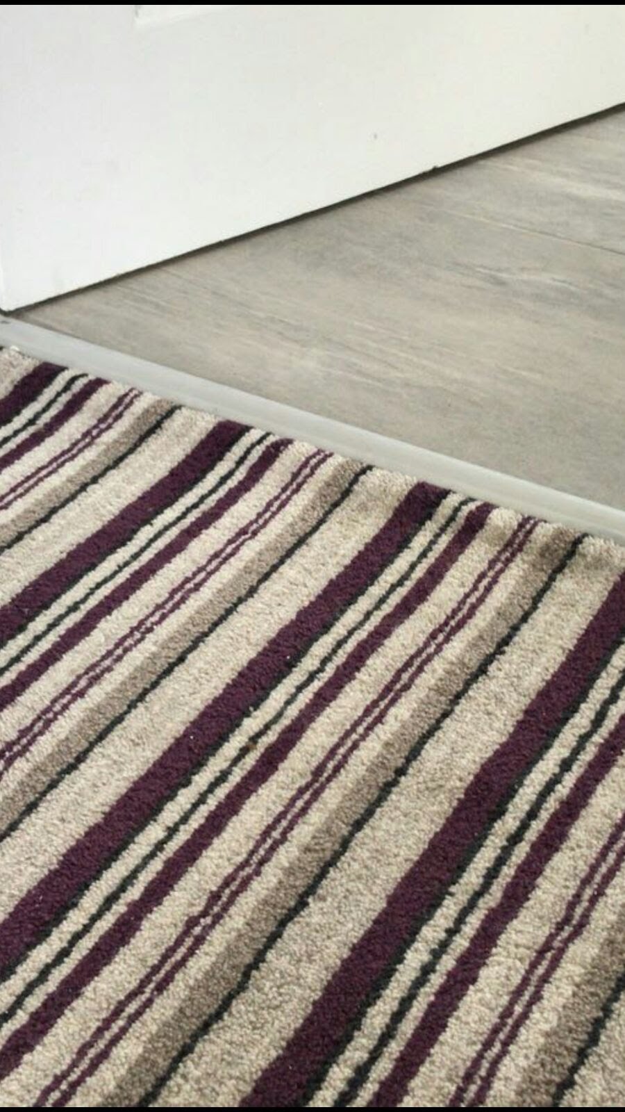

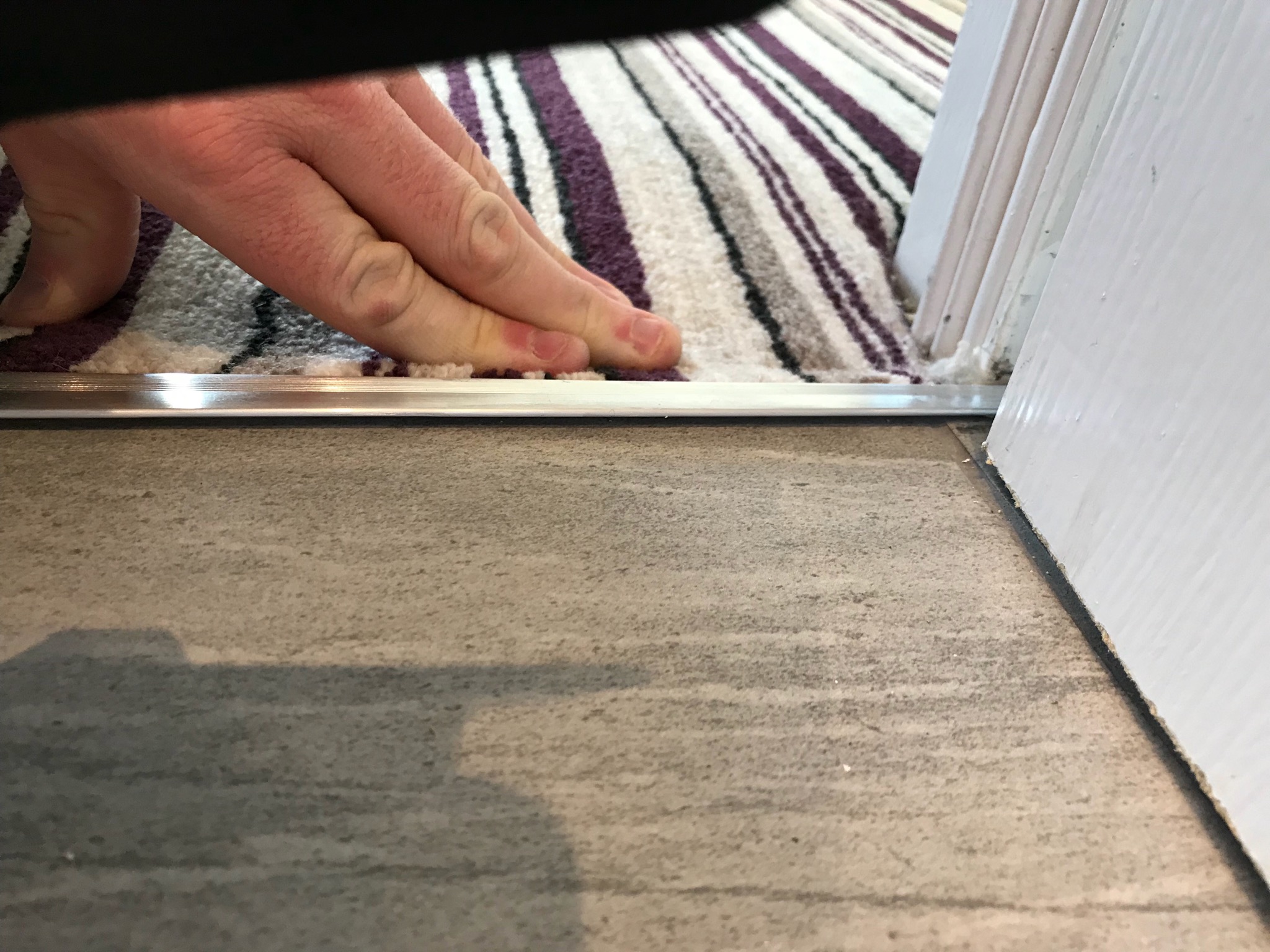

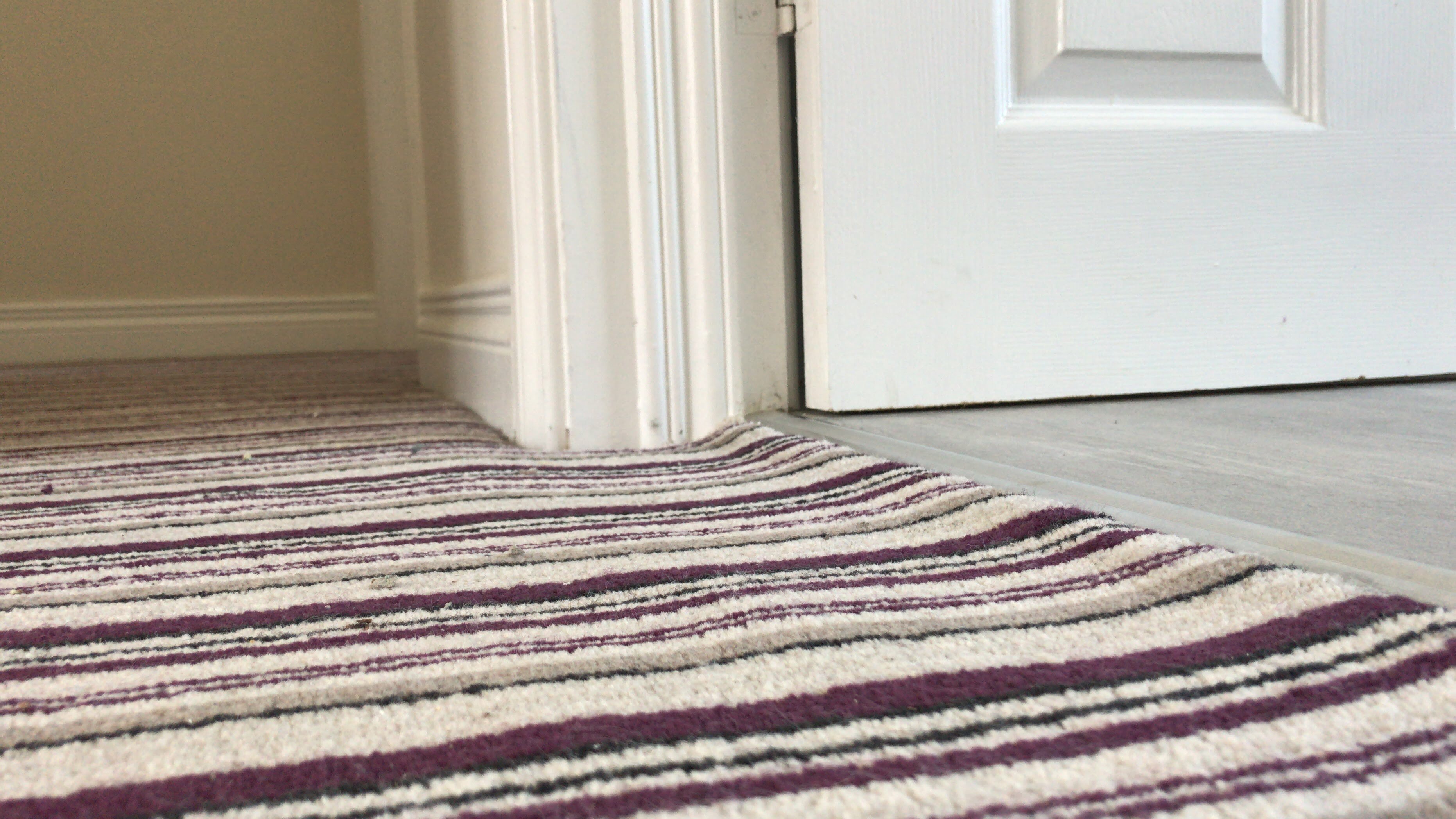

We are just near the end of getting our bathroom refurbed by a local plumber. The tiler he used did a good job overall, but left the threshold with a 7mm rise on the left had side versus the right. Now when the plumber tries to fit the threshold z-bar to the carpet, on one side it is flush and flat and the other side the carpet rises up to meet the tiles.
I raised it as a snag, but they said it was just because the floor was uneven and we should put extra felt under the left hand side to fill it out.
I need advise if this is acceptable or if the floor needs to be redone to make an even join.

Sometimes in life we have to make compromises.
I have just finished a small bathroom where if I’d tiled the floor level it would have been 30 mm higher at the door to the far end!
Now 7mm across a threshold can easily be overcome by building up the subfloor under the carpet and indeed a decent bit of underlay will bring the height together nicely.

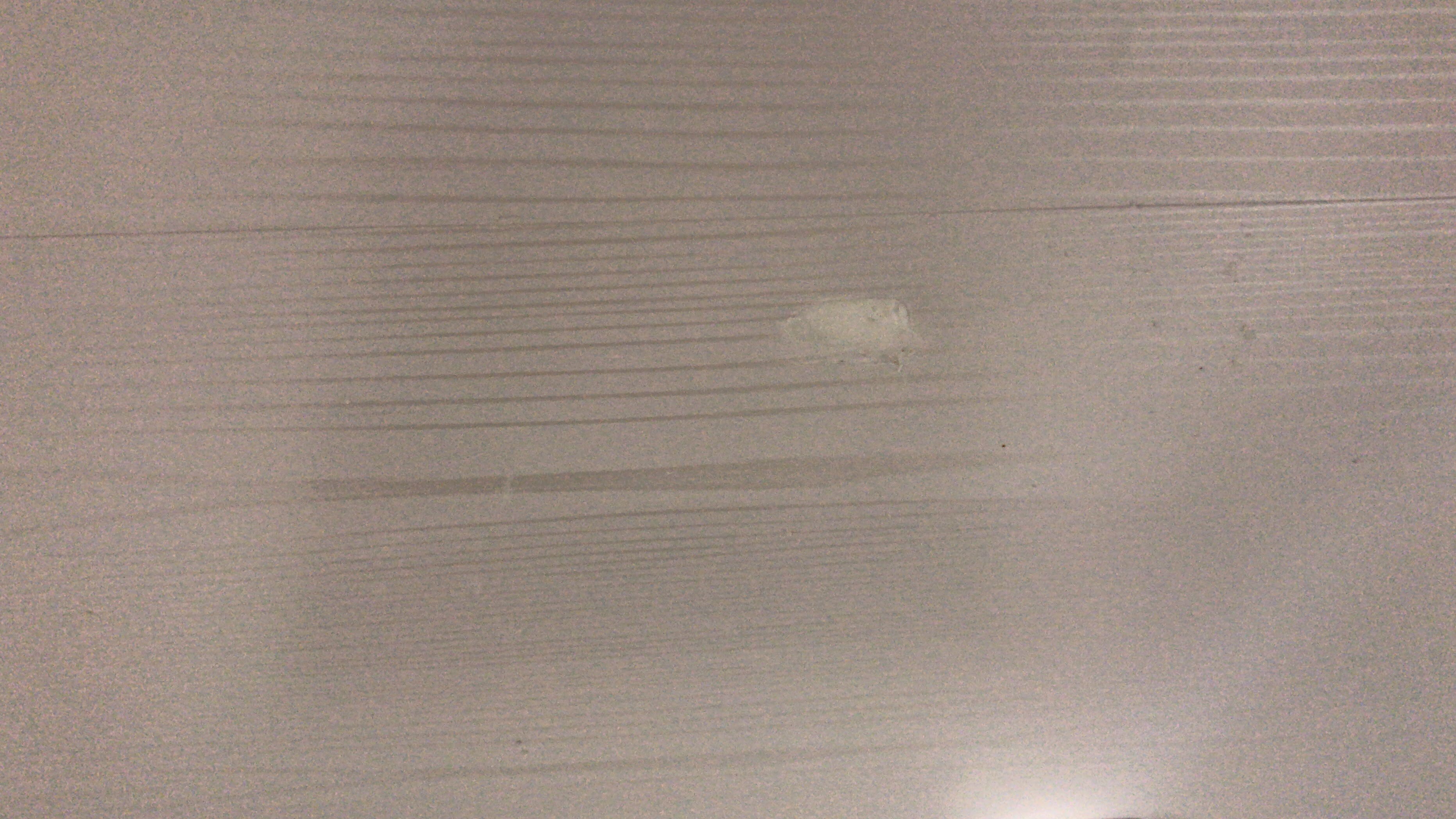

  • Hole is ceiling panels disguised with silicon

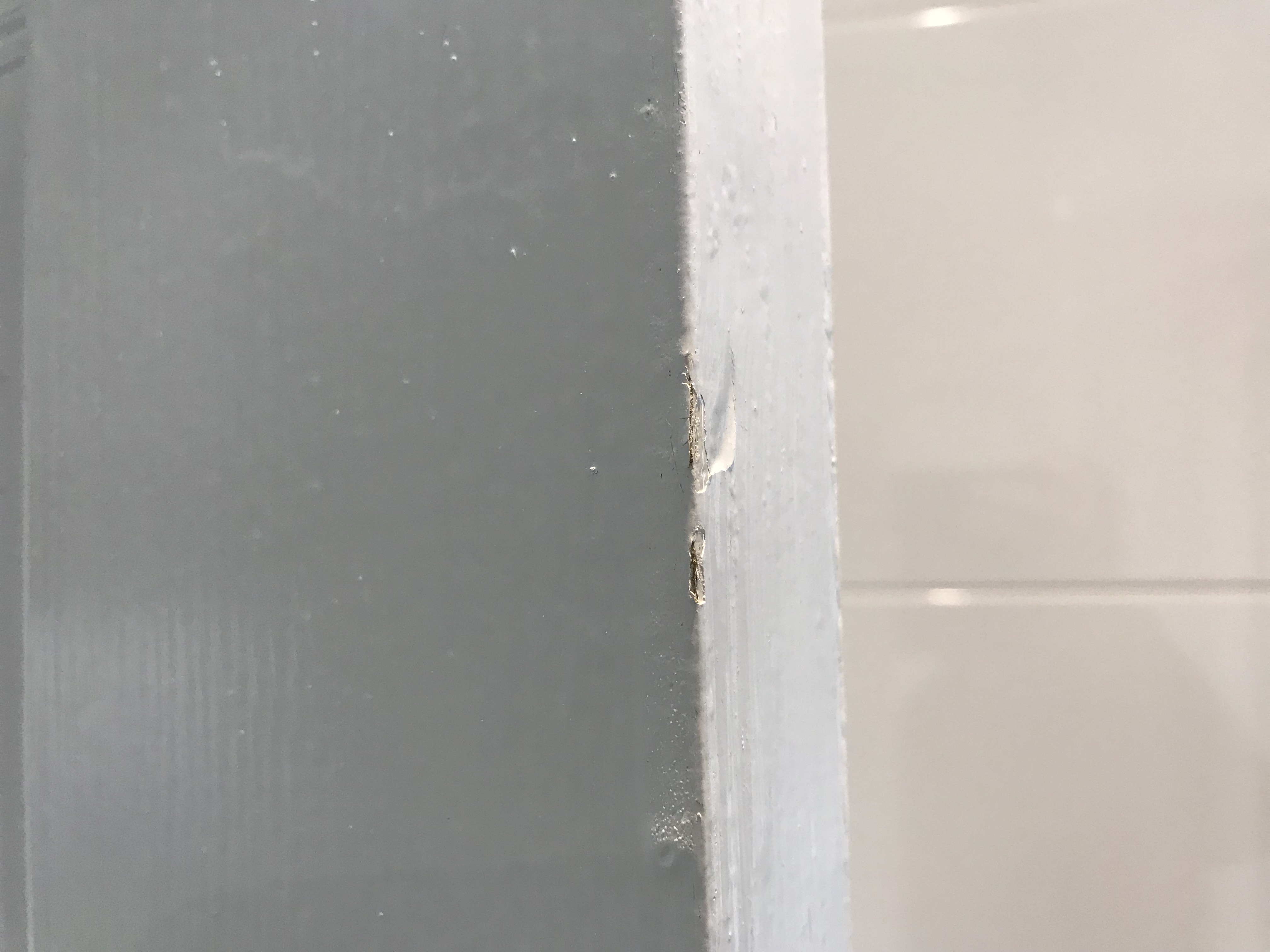

  • Damage to door and door frame

- Damage to bathroom door frame

- Tiling at door threshold uneven and not level, resulting in a poorly fitting threshold which was loose and uneven. Bathroom door also catching on the threshold.

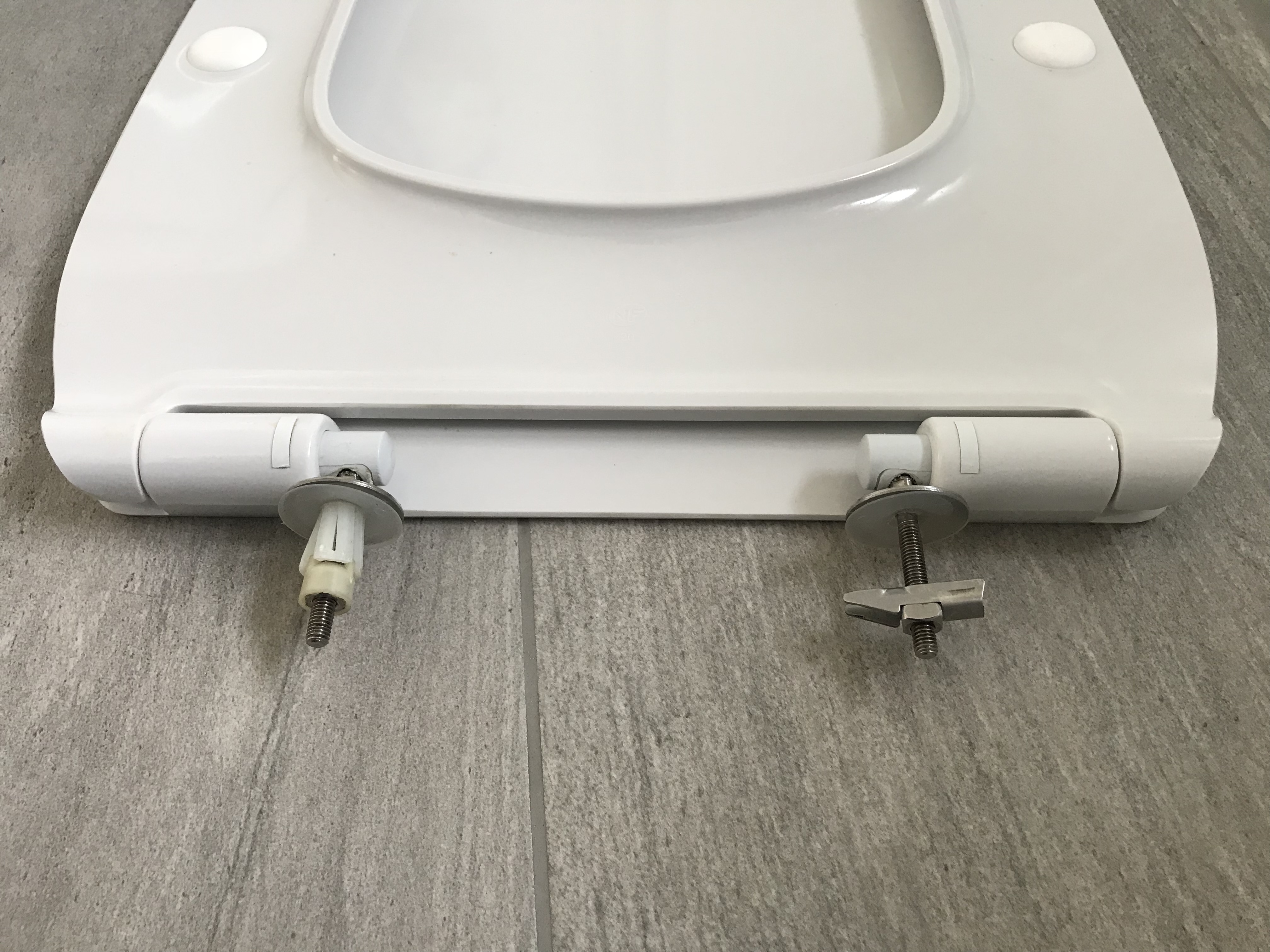

- Toilet seat loose

- Door and frame damage just to be expected as part of the fitting process.

Tiling issue due to unevenness of subfloor and little could be done. Agreed to try and resolve threshold issues by adjust and placing packing under the carpet. Resolution was attempted on same day, but still completely unsatisfactory and does not address root cause being uneven tiling.

- Advised that a small spanner was needed to tighten up the seat, but to expect long term problems with that toilet seat as they are poorly designed. Tightened up seat on same day, but was loose again by the evening.

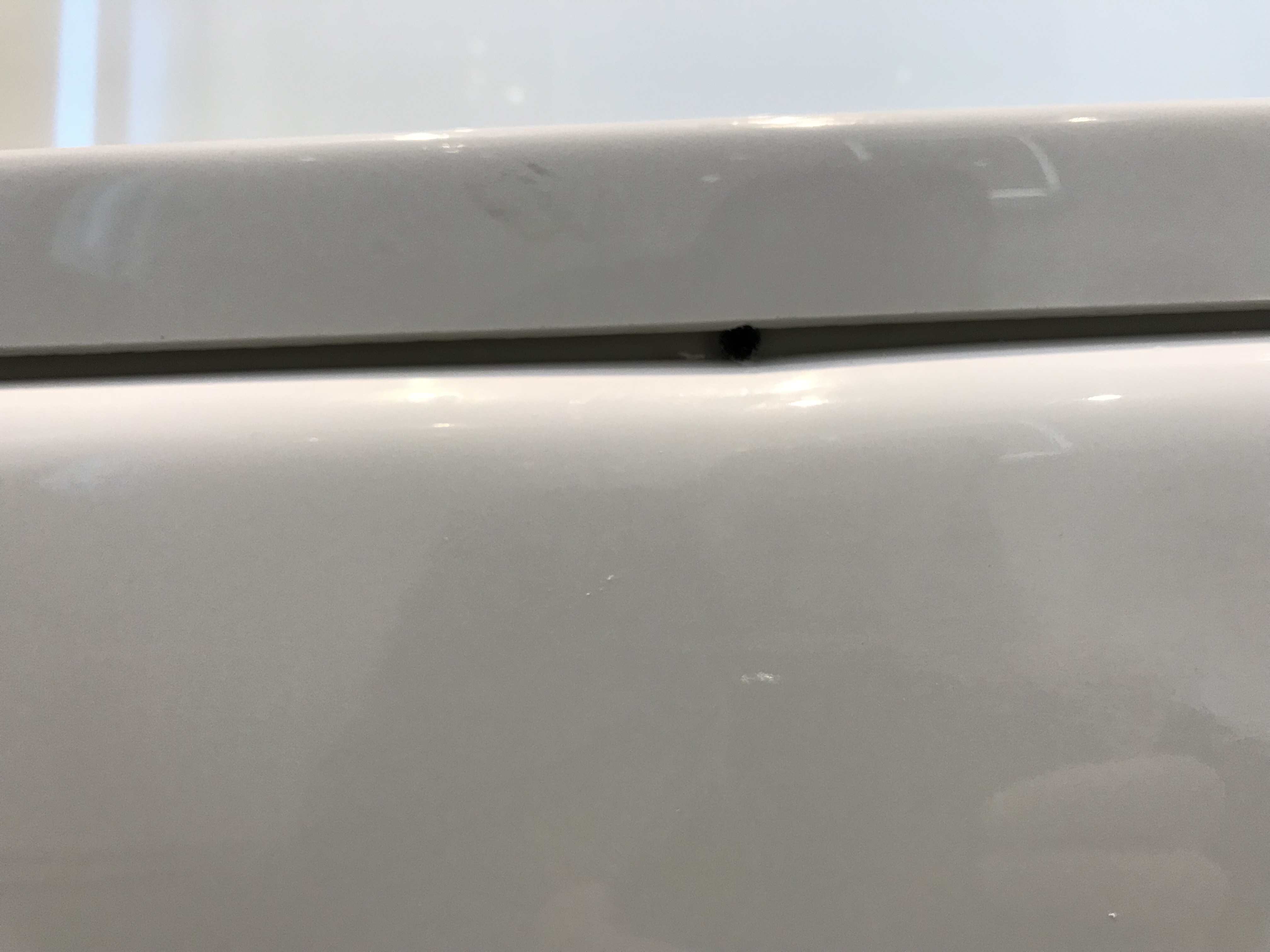

During the evening of 26 Apr, my wife was cleaning down the inside of the shower using baby wipes to remove all dirt, grout etc and noticed a chip out of the shower panel about 4 inches above the top of the shower. Again immediately reported to fitter with WhatsApp Message and photograph. Received reply that he would look in the morning. Came to inspect at lunchtime on 28 Apr, but could offer no explanation off why it was chipped, only saying that after he had sealed the top of the shower panels on 26 Apr, he wiped everything down and didn’t notice a chip. He agreed to contact supplier to enquire about repair kit. During visit also looked at further action for door threshold problem and advised bath panel was ordered. I paid him an additional £1300 cash in good faith bring a total of £2100 cash paid out of final balance for all works of £2680, with the explanation that the remaining £580 would follow once all work was completed and all the old bathroom waste and rubbish was remove from outside the house as agreed.
This evening 28 Apr, while wiping down the ceiling panels, I notice that one of the panels had been damaged with a gouge/dent the size of a 1 penny piece and filled with white silicon to disguise the damage. I phone him immediately 9:30pm, but no pickup so left a voicemail and followed up with WhatsApp and picture of damage, along with a message that there were now too many ongoing issues and I was going to contact the bathroom shop to seek resolution on this job as this was no longer acceptable. He phoned shortly after and we had a lively discussion on the issues. I told him that I would not pay the remainder £580, instead preferring to use it to pay someone to complete the job properly. He protested and offered to fix everything, but I told him that I had lost all trust that it could be finished to a reasonable standard without risking further damage. We discussed the shower panel again and he indicated that he had the ladder inside the shower when sealing to top panel, but stated that the panel was not damaged when he finished and he could still not explain it. I told him that I had worked in good faith with him to address the snags and already paid >75% over the work to him in cash, but finding damage that had purposely attempted to be concealed, I had lost trust in him or his workers being able to complete the job, especially given the fact that damage had been purposely concealed. In addition there has been numerous small items of damage to our walls, carpets and stairs.

Issues still coming out of the woodwork on this one, the toilet seat hasn’t been stable since it was fitted. Got a spanner from the bathroom merchant and took it of today to find this.
One side fitted with a plastic compression fitting (with the top washer missing) and the other side with a throughhole fitting stuck into the hold, with no hope of ever being stable.
I can only assume he broke or lost the right hand side compression fitting and tried to hide this issue as well.
