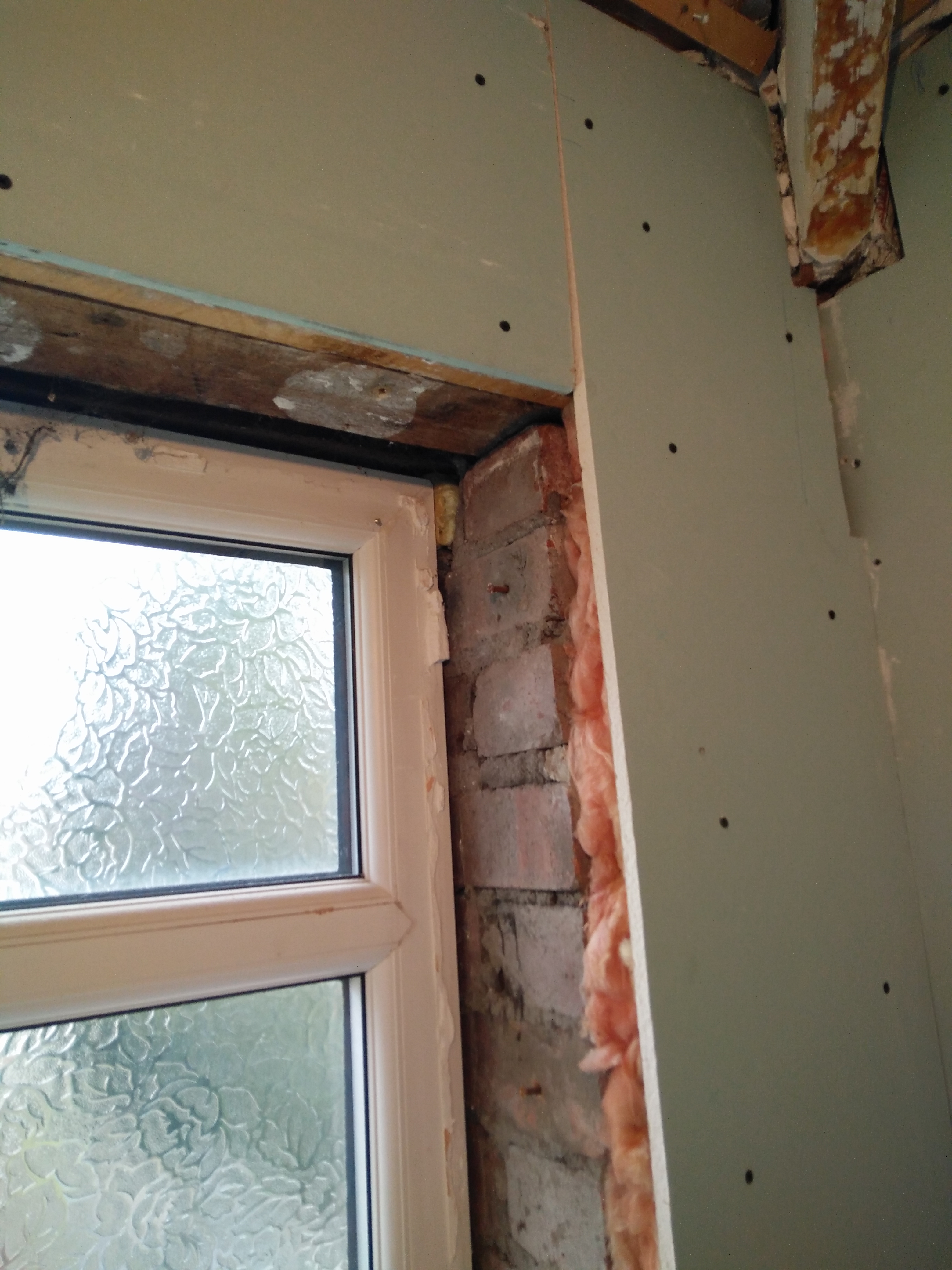

Hi.
After ripping old tiles off, I noticed that the bottom sill and side panels where padded out with MDF or some other wood. They had done this I assume to get tiles to fit correctly against the window frame.
My question is what should i use to fill out the space before tiling around the window? I am aware of possible water damage/condensation around window.
Should I use ply fill out the space then tile onto the ply?
Should I ply then plasterboard onto the ply?
Or is there a better way to ensure that whatever I tile onto doesn't rot and break away?
Thanks

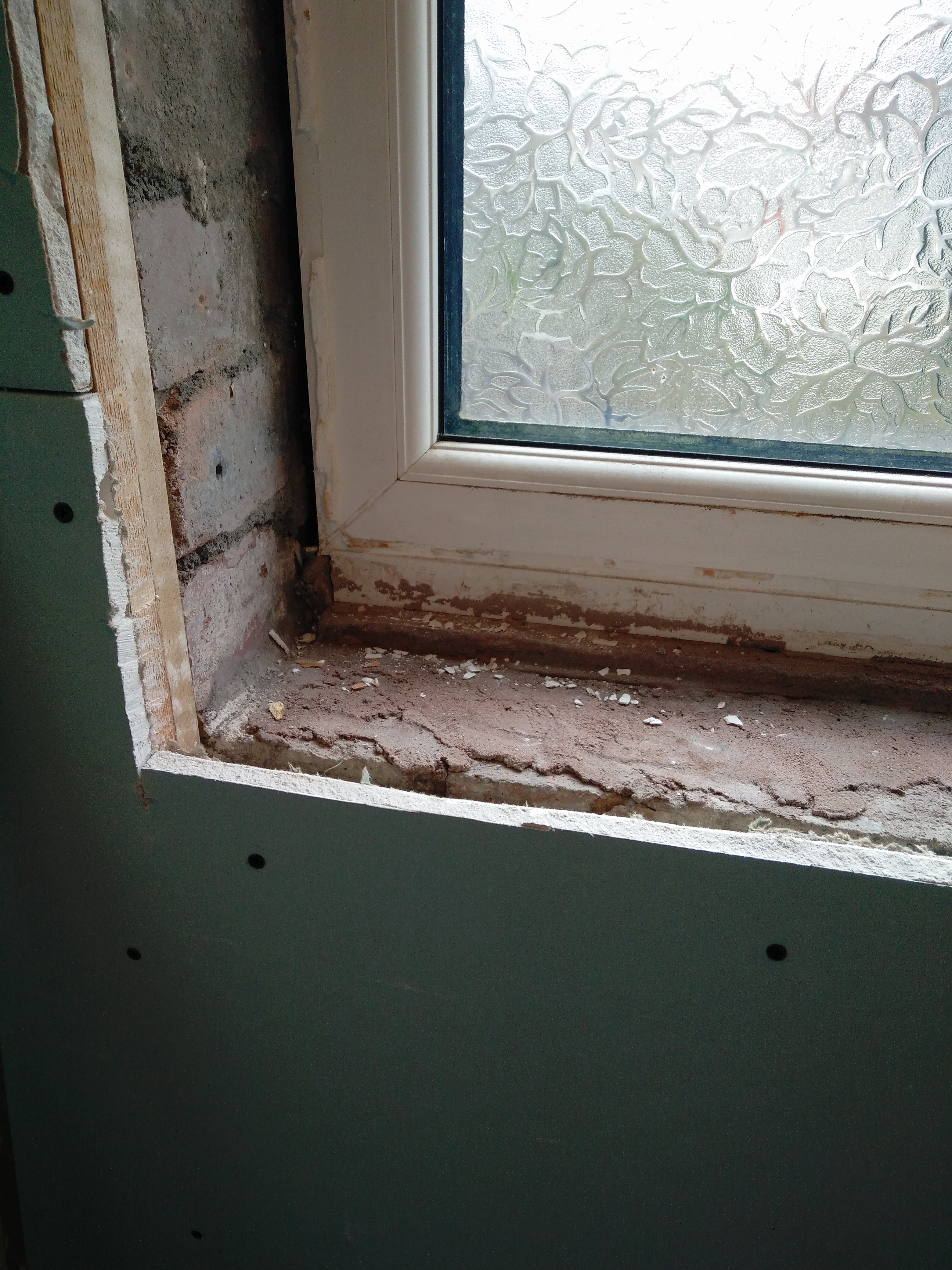

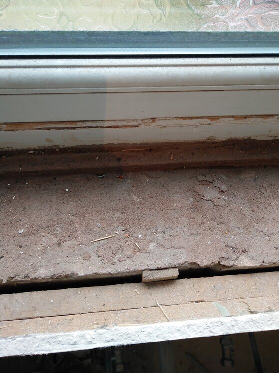

Hi pal
See attached.
The window sill is approx 1 an a bit inches below were the last tile where on the PVC window.
At the top is about half inch and sides are bare brick.
Just want to know whats best to fill this space and sit tiles on?
Thanks
id use hardi backer board stick with addy and screw it with a few brick fixings for added strenght on the head
You seal all around the window with Silicon then float with S&C render and lightly scratch it. That or cement board sapped on with bonding or even tiling Addy, Job done!
No need for the render if your going to board with cement board, personally, I'd dot and dab backer board( because I always have some in the van) if your going to render just render to right depth, if your going to board, just board it out to the right depth.
I know but but some people can't source backer boards.
Backer are available to some description in most towns . Builders merchants carry them Wickes topps magnets the list goes on . Failing that plaster board . These are the easiest opens .
Plasterboard and plasterboard adhesive. Or double tile with off cuts and cement based adhesive...?
If you can get it one of the insulating tile backer boards (Wedi, Marmox etc.) would be my preference so that you do not get cold spots on the tiling causing condensation.
Check the set out of the tiling before fixing the sill because sometimes you may be able to adjust the sill height to match perfectly to a horizontal tiling joint.
