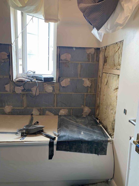

Hi all, I am in the middle of renovating my bathroom. First of its kind for me! The walls were are all Plasterboard with tiles around the room up to shoulder height when standing in the bath tub. 2.7 walls on a wooden stud work frame, 1.3 walls relying on dot & dat adhesive against the grey breeze block wall.
So far, sanitarywares removed except for bath. Plasterboards also removed up to tile height for most of the walls with just the bit around the bath left. It just occurred to me that the bath is enclosed (in L shape) by plasterboard with dot & dab adheisive so no studs to fix the Wedi onto.
My uneducated guess would be to leave the existing (already hard & flattened) adhesive on the wall, add more all over the place and press the Wedi against it. The existing adhesive is effectively acting as the stud work to keep the board level. I don't know if normal plasterboard adhesive will stick the Wedi to the wall.

Attached is a pictures showing all the walls. Stud work on two of them but I may need to add more to it.
There seems to be a lot of acrylic primers. Any specific one?
I was hoping that I would only need to use the Wedi for the cut out area (right to the floor). Maybe go a little bit further just above riser shower rail. What you described above will mean I should really take the board complete off the widow side. I have to admit, that's a little daunting for my diy skills..... Could I not just get away with lots of adhesive behind the Wedi and hitting the board back as indicated .... the existing dabs helping to keep it flush the the plaster above?
By the way which adhesive will I be using between the board and the wall or does it have to be a Wedi specific adhesive?

ok, I might as well take it off i.e. long wall and one with shower riser.
Which type of adhesive between the breeze block and wedi? I’m assuming its will have to be one go mix considering the size of the wall to do?
