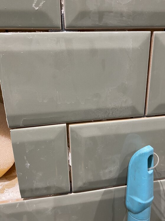

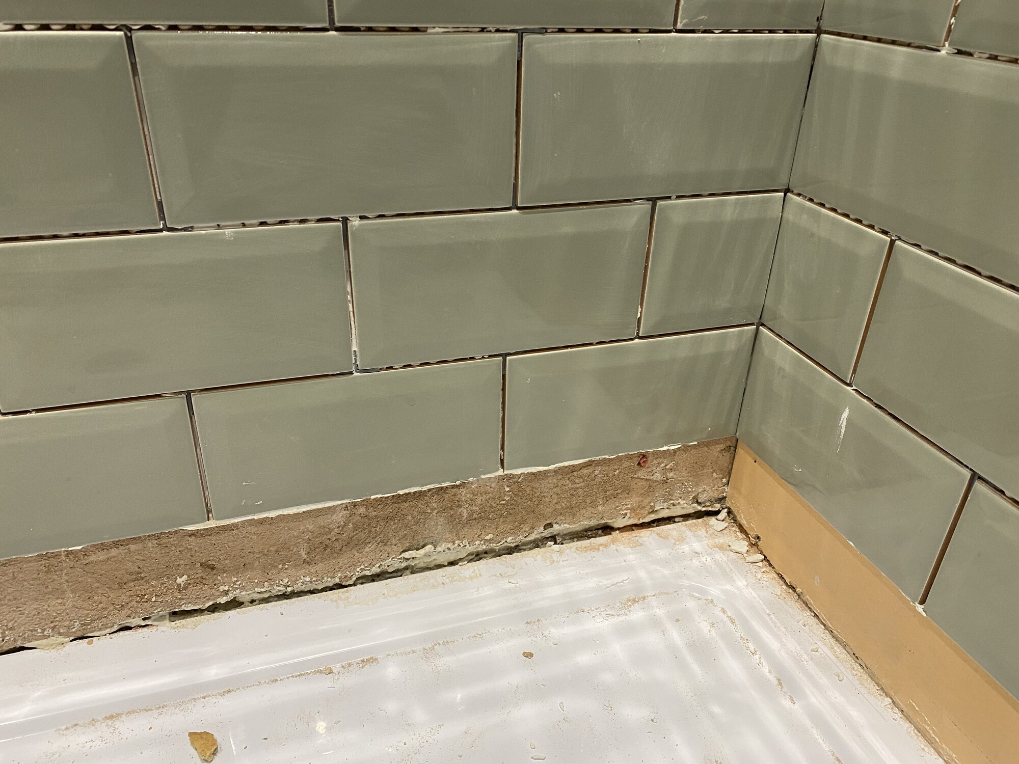

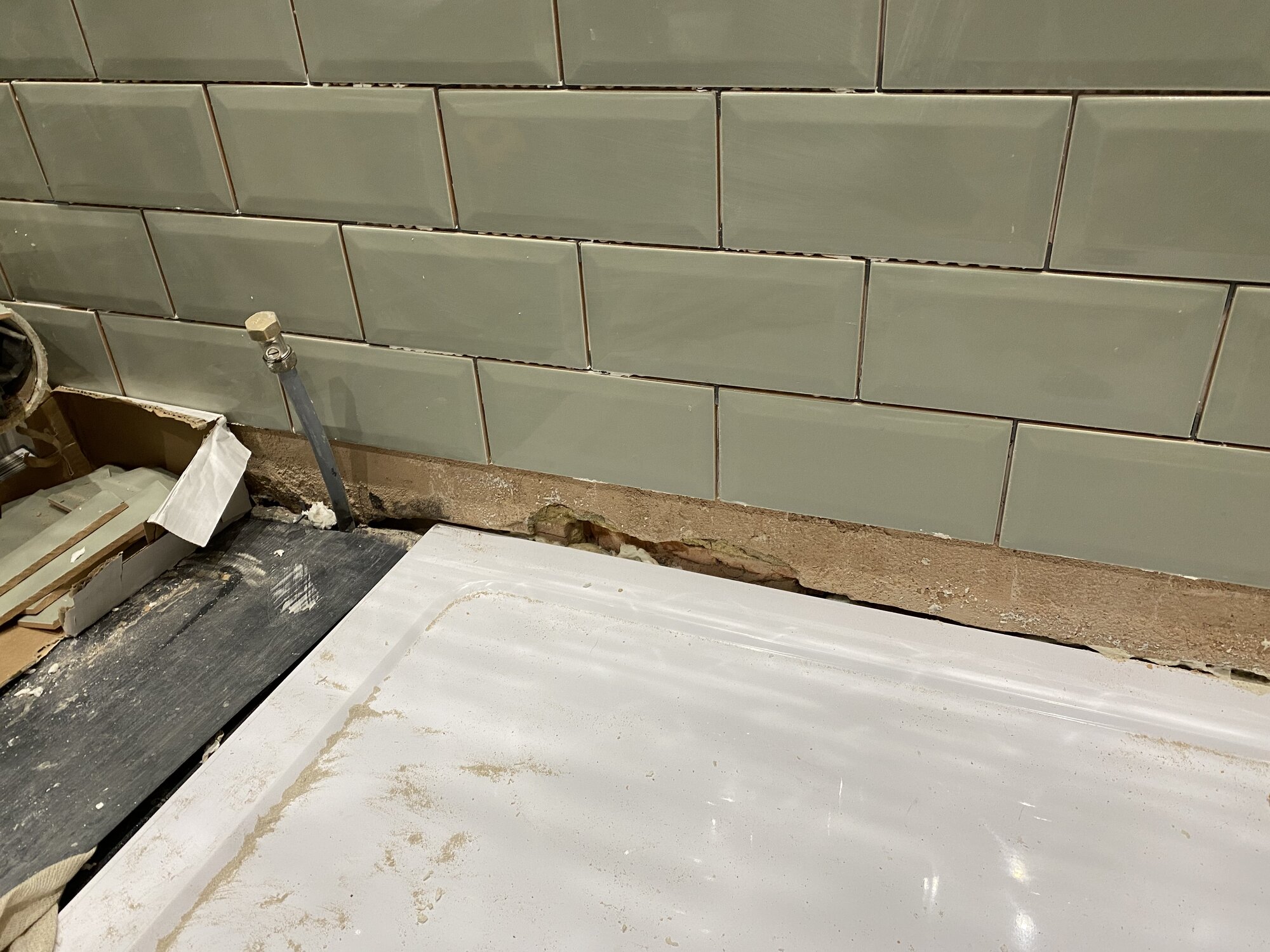

My mum is having her bathroom fitted and she sent me some photos and my partner pointed out that several things weren’t looking great. I spoke to the contractor and he said we didn’t know what we were talking about and that he’d been in the trade for 30+ years and told his fitter to carry on.

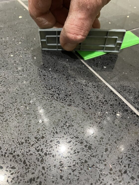

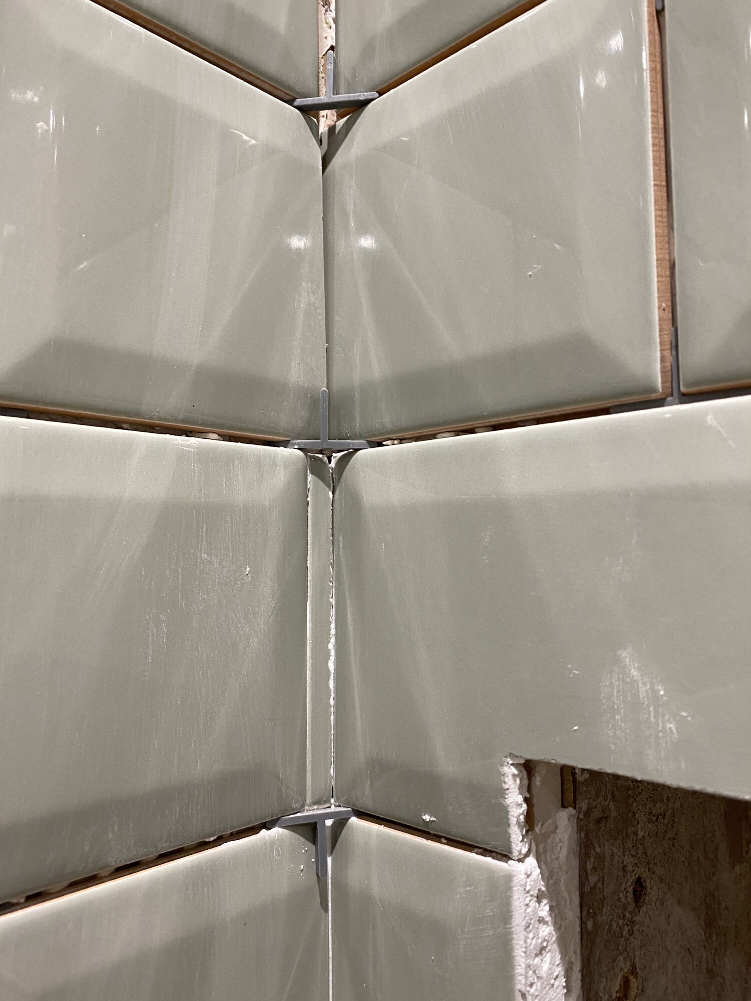

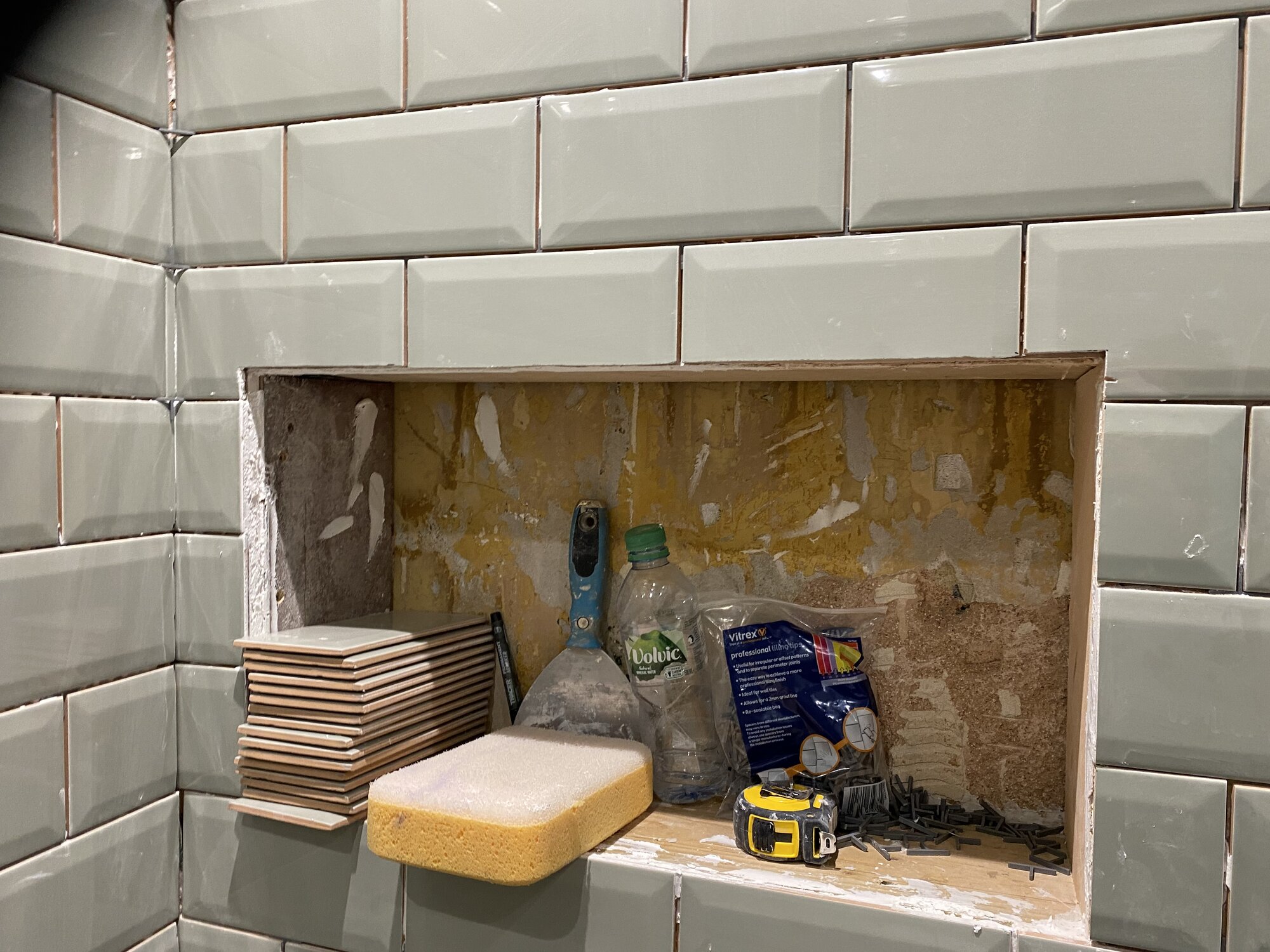

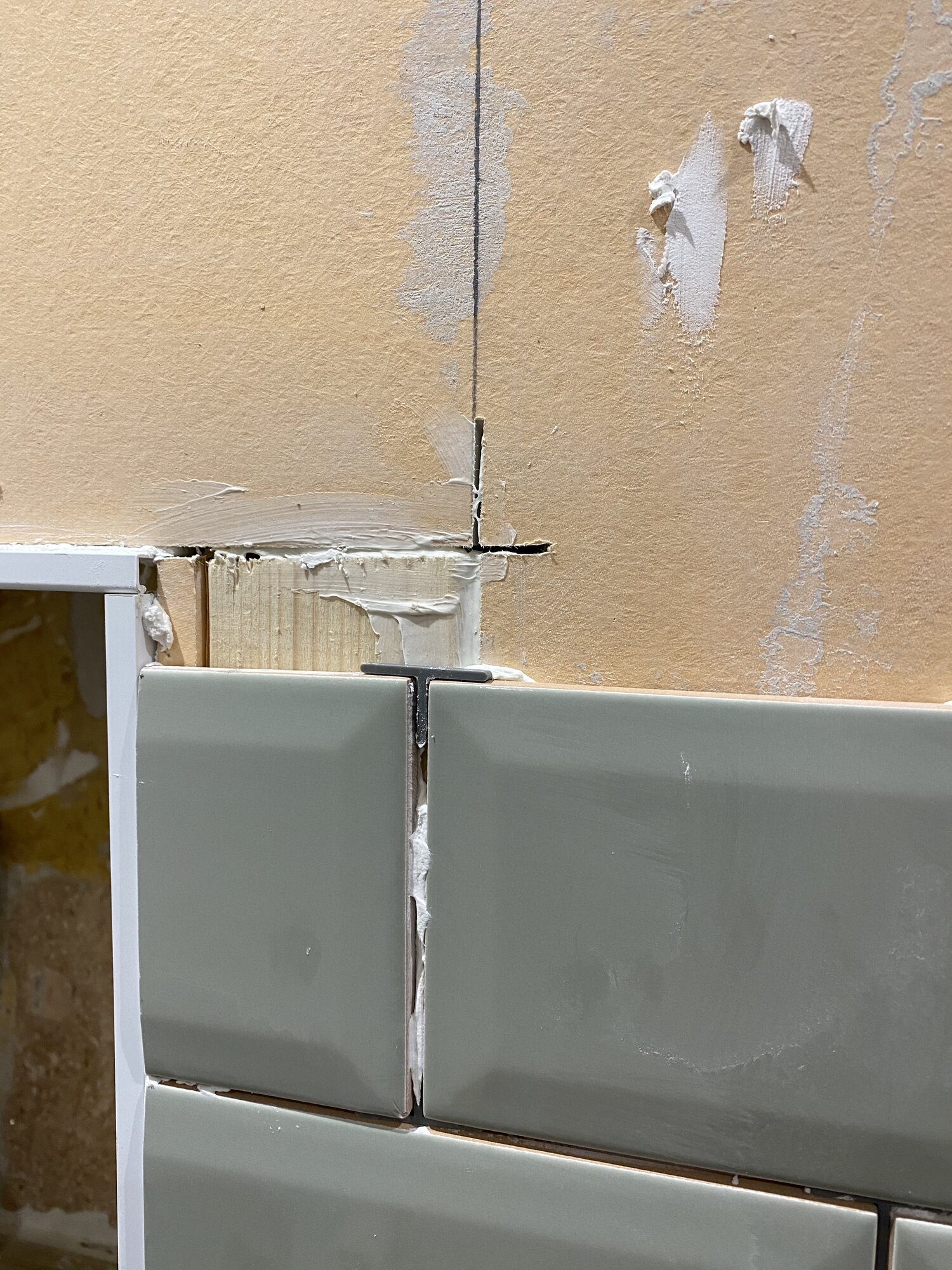

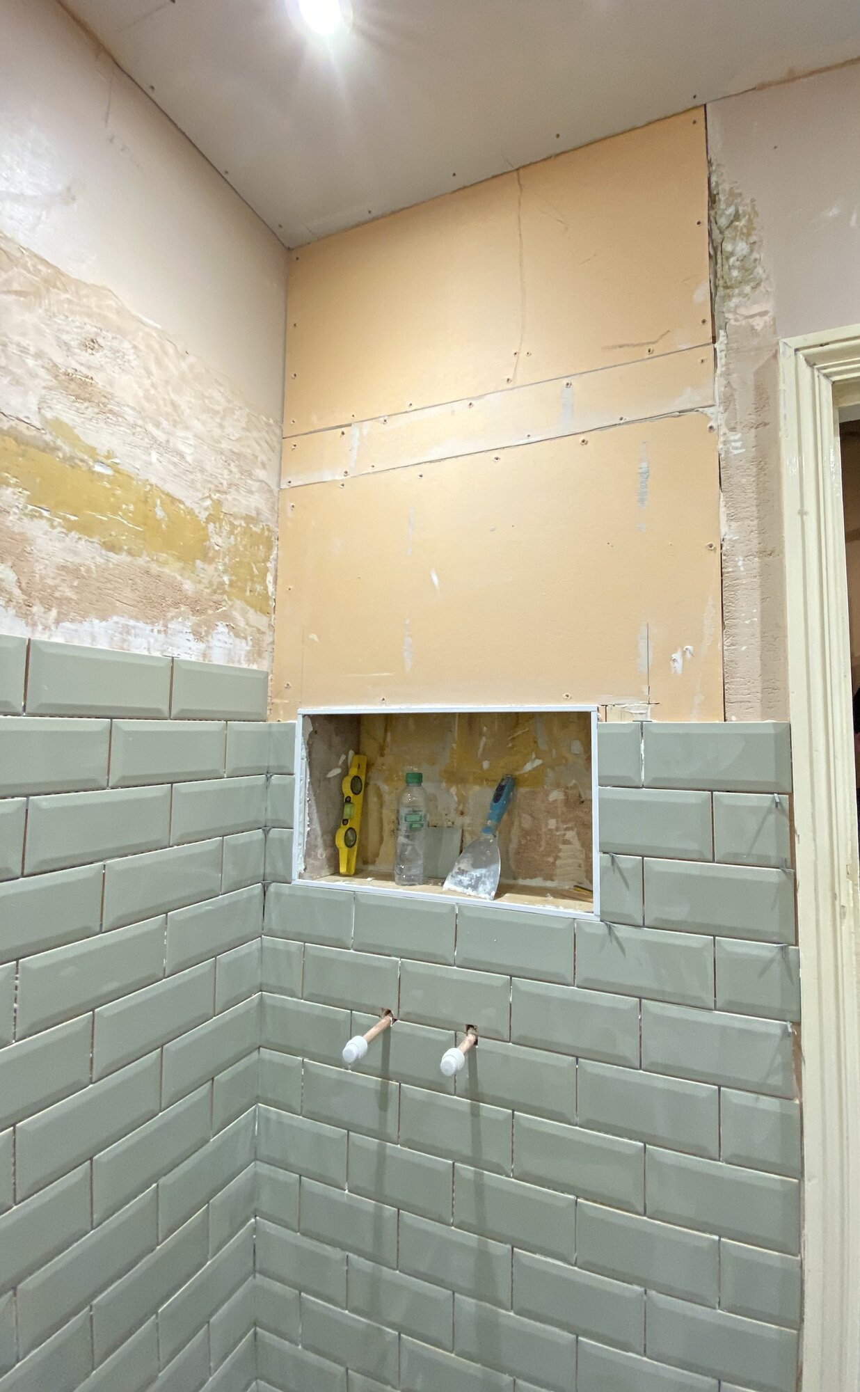

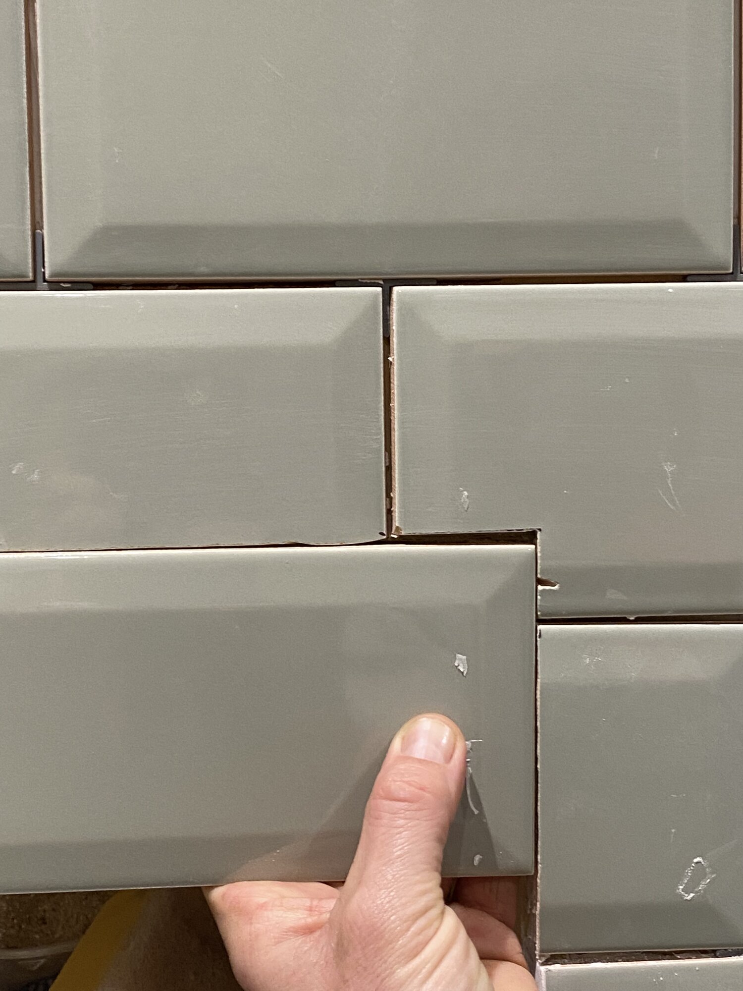

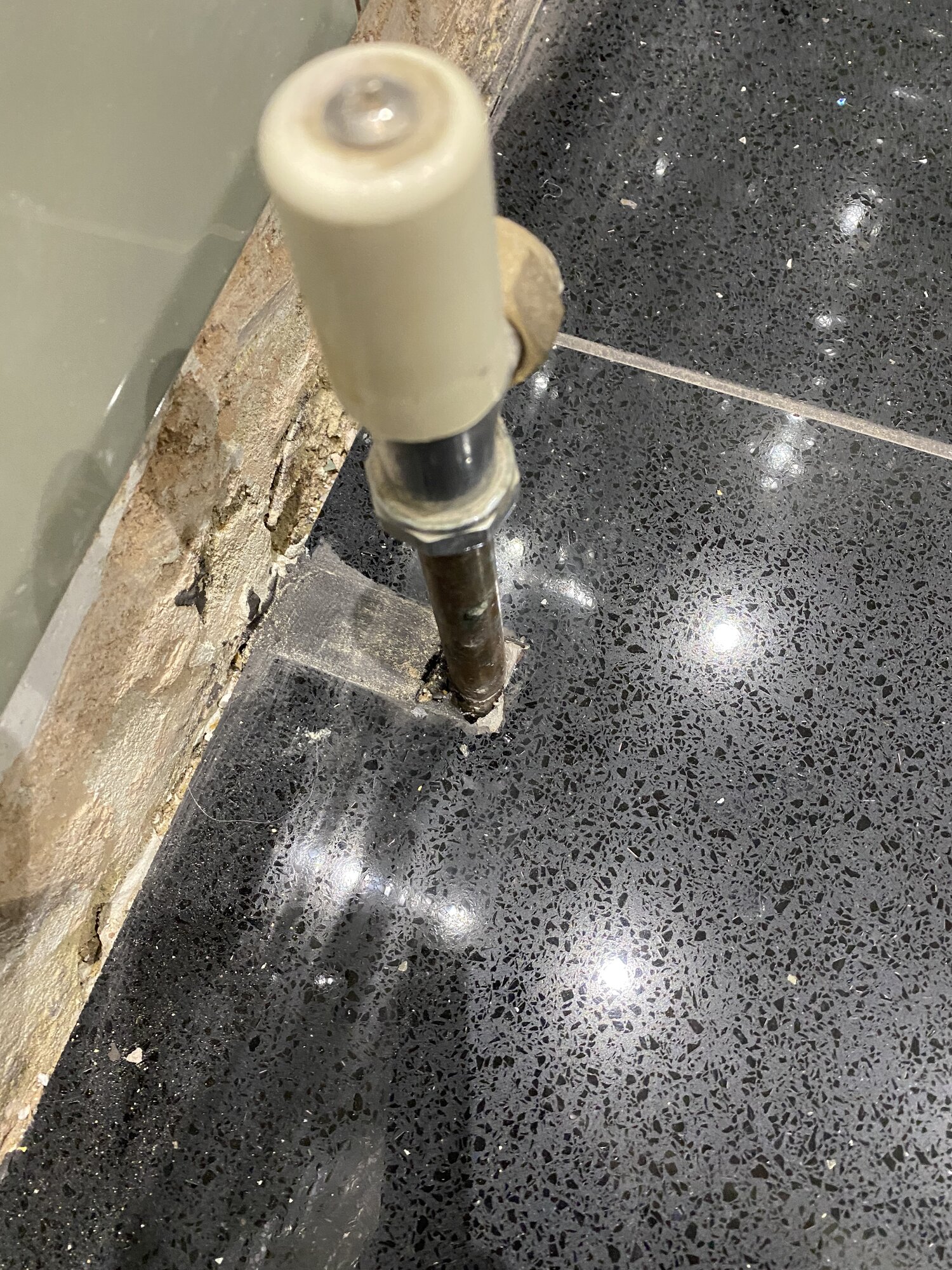

We thought the walls weren’t prepared and sealed before tiling (no tanking, tiled directly onto bonding etc) . Tiling was out of alignment. The floor tiles weren’t level and had lipping of about 3mm in places. The niche cupboard in the shower had 3 wood sides with no seals, there was tiling on to
wood on the outside. There were odd cuts out of tiles where he’d slipped with the angle grinder etc.
