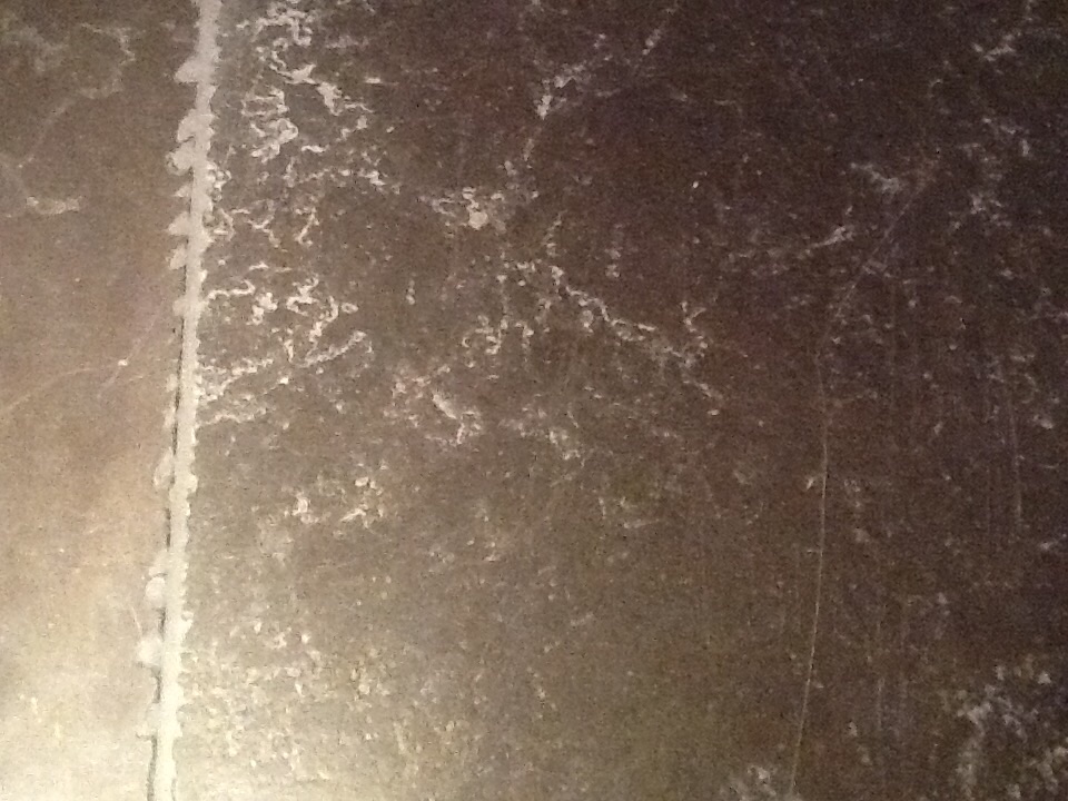

Anyone know how to get grout out of tumbled limestone surface? BAL wide flexi.
Also need to repair scratches and seal when grout is tidied. Can I go wrong with Lithofin MN Stainstop Plus, it's in the kitchen? Any better for porous stone in wet greasy area of use? Your knowledge and wisdom are greatly appreciated. Stacy

Yes, tumbled and unfilled, except now it has some light grouting here and there in the nooks and crannies, about a tablespoon or twos worth. Can I knife it out, scour it or is there a softener I can use? Allister, you're a doll for the offer, your proximity is a blessing. I look forward to hearing what lifothin Bob has to say about sealing these darn rocks. Third day of living back home and my head is swirling with putting priorities in order, most stuff I can try my hand at and will. Off to reassemble my Nabru sleeper sofa now, will need a break and will check in again soon. Thanks for your time. Stacy

Hi Stacy, stain stop plus will be perfect for this situation , if you want to enhance the colour with a Matt finish. Have you got any pics of the degree of contamination on the tiles from the grout.we can have a look on here. We can sometimes use a alkaline product to break the polymer down , which can then release, no scratching it out just yet.
Impregnating this will be fine , three rules get it clean,dry and remove the excess of the impregnator ( buff fully dry)
you can call me on the number on the tin on Tuesday if you prefere we can sort the grout as best as possible , get it dry- get it impregnated and sort your maintenance out for long term.
