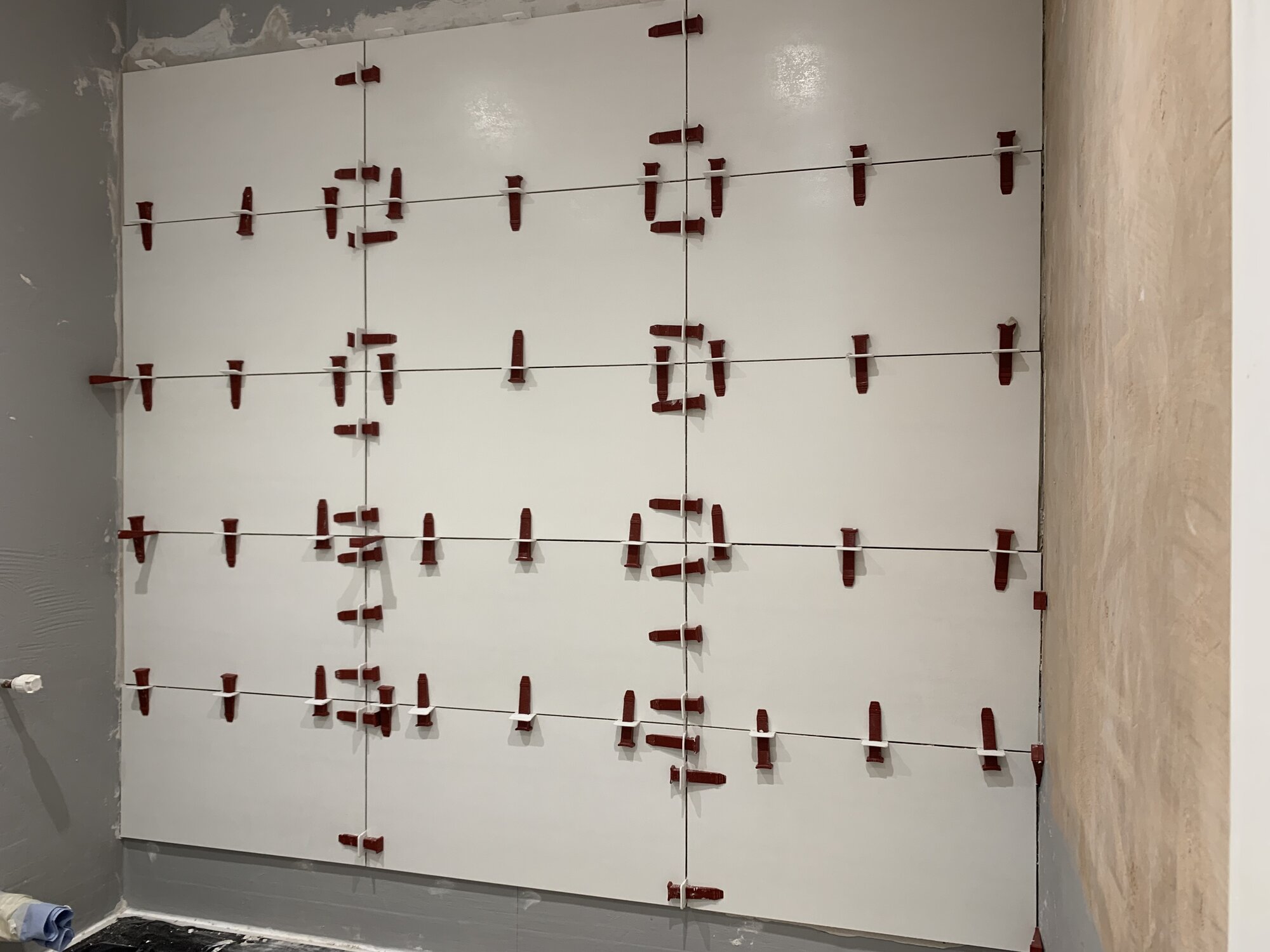

ps any comments on my tiling from the pic welcome always looking to improve!
