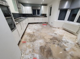

This kitchen is not level as can be seen in the attached picture.
6 years ago, the previous tilers of the previous home owners tiled on this floor by using only 1mm tile adhesive by the hallway, 5mm adhesive by the left hand side leg, and 12mm of adhesive towards the rear end leg to make the floor level.
Unfortunately, they used dot and dab, and didn't properly secure the plywood to the floorboards therefore the tiles were moving/cracked/grout crumbling off etc so it now has to be redone.

- From floorboard to kitchen leg (white leg bit) towards the back, it is 28mm in height.
- From floorboard to kitchen leg (white leg bit) towards the oven on the left hand side, it is 21mm.
- From floorboard hallway door, it is 17mm in height.
