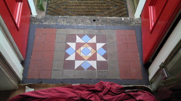

I’m looking for a little advice on the procedure for restoring some Victorian tiles. Here is some background:
Photo:
Questions:
Appreciate any advice / compliments on my great work so far ;-)
Martin.
- Victorian tiles a main entrance/door way. Approximately 1m x 0.5m. They were tiled over in the 70’s/80’s with something that I'm sure looked great at the time.
- I have removed the top layer of tiles carefully using a hammer and chisel
- I removed the cement/adhesive residue from the top surface of the Victorian tiles using a heavy duty scraper. There was also some sticky adhesive on the surface possibly from another previous covering. I applied LTP Solvex according to the manufacturers instructions 3 times which has done a pretty good job of removing most of the foreign materials. I plan to give them 1 last clean with some LTP Grimex.
Photo:
Questions:
- I’m not looking for the tiles to be perfect and I’m generally happy with their condition now. Would anyone recommend any further cleaning processes though?
- The tiles need regrouting. What grout should I use? The gaps are much smaller than any tiles I have ever grouted. Is the process any different?
- The black tiles along 1 edge have some holes drilled in them. I plan to fill these with black grout. I appreciate it will not be a perfect job, but acceptable for the standard I'm trying to achieve/time I have available. Is there any other techniques to hide holes such as these?
- Should I seal/restore the tiles before grouting to prevent the grout staining the tiles? I have purchased LTP Colour Intensifier and Stainblock in anticipation for this.
- Do I seal again after grouting? With the LTP Colour Intensifier and Stainblock or other?
- Anything I’ve forgotten?
